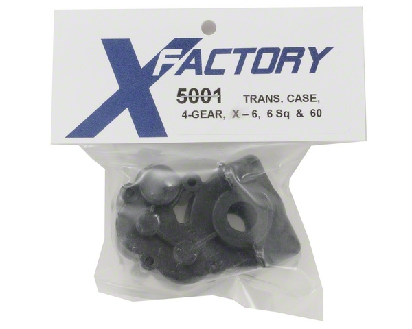

Lowry has good points. How about picking up one of these (and then filling it full of readily available B4 gears)...?
A lot more work, but if that's what you are into...Just a thought. :mrgreen:

Y'ernat Al wrote:Lowry has good points. How about picking up one of these (and then filling it full of readily available B4 gears)...?

4.whoa wrote: ..I have seen the 4 gear mentioned here & there but don't know much about it. what ratio is that then , 2.6? will it mount on a flat chassis or does it need a hole ? and is it still in production ,or at least available? the Rpm i got ,my order was the last one @ A-main.
They are still available. A main even.
http://www.amainhobbies.com/product_info.php/cPath/1_25_1649_1650/products_id/182522/n/X-Factory-4-Gear-Transmission-Case
The second idler (4th gear) gets the motor rotating correctly without turning everything upsidedown and backwards. I saw in your first post you wanted to keep the wheels planted, and that motor will torque like no other. The tranny case is from the B4 mid-motor conversion car called the X 6 Squared, and supposed to use the B4 chassis hole. But with the 10T arm length, and the right carriers, who knows? :? You'd have to get into it yourself and do a bit of googling this site and others to learn a bit though. It would not be easy, but a mid motor flip on a tub is tricky any way you slice it.
- Brian -
My Gallery
