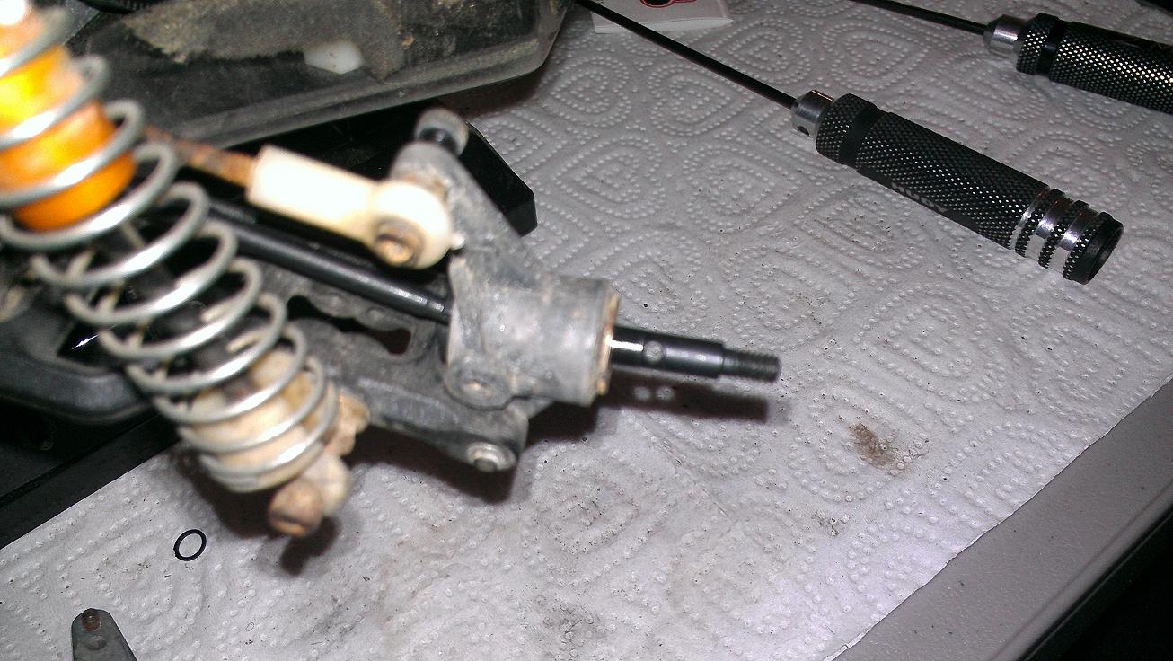

This will take a few posts, so I'll start with the rear end...
I have dogbones front and rear here, so I'm assuming that the DB01 universals have the same exact dimensions (no reason why they shouldn't).
Dogbone goes pretty deep into the drive cup, but I can compress the suspension fully without any binding.
The wheel axle is long on the rear.  I tried the front wheel axle back here, but it is not long enough to fit the rear wheel, so you have to use the rear wheel axle.

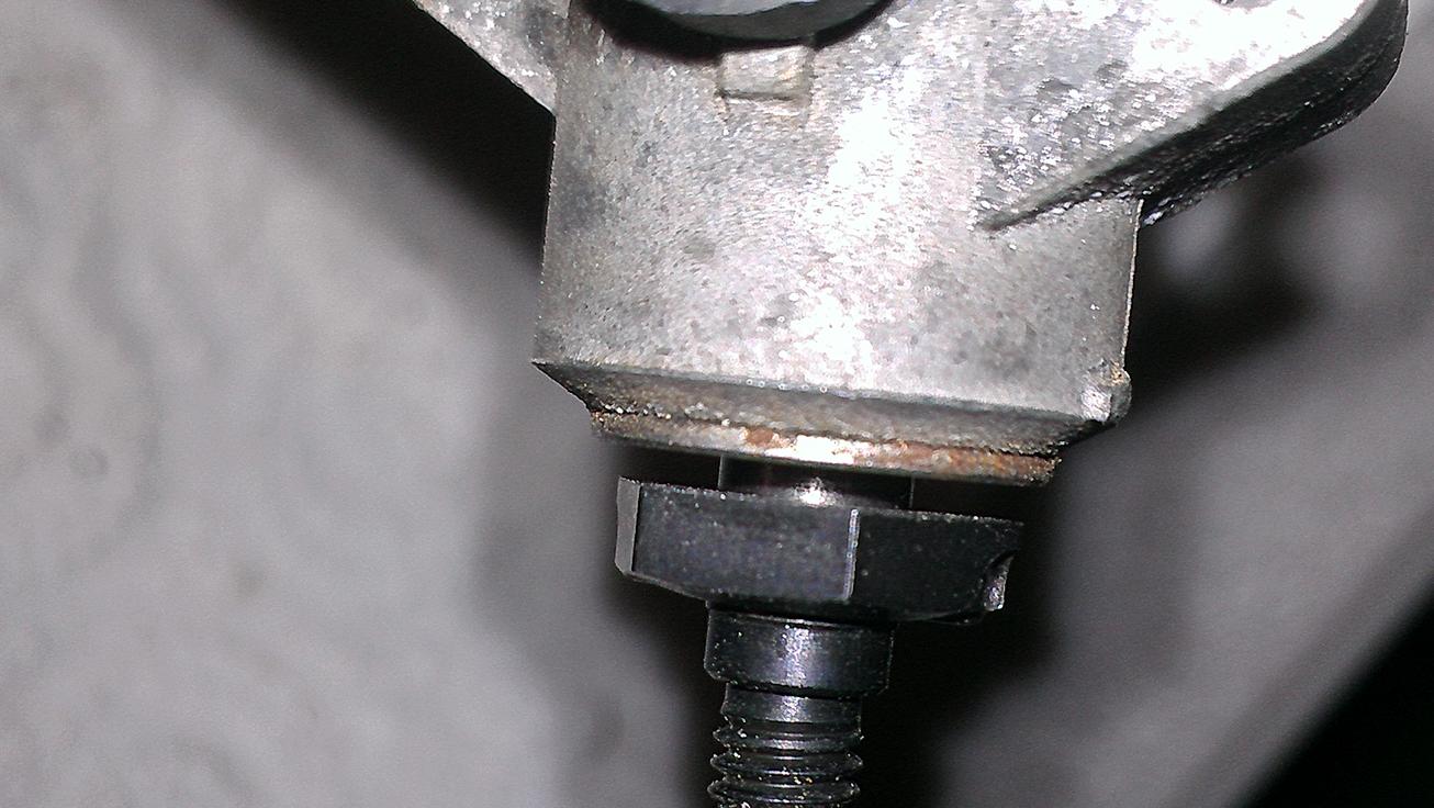

continued...
The rear wheel seems to fit free and clear of any contact with the outer camber link, and the offset on the wheel seems to compensate for the long wheel axle.
With the suspension fully compressed and the wheel axle pushed all the way in, you'll need a few mm of spacers, or even a bearing/bushing, to pick up the space.

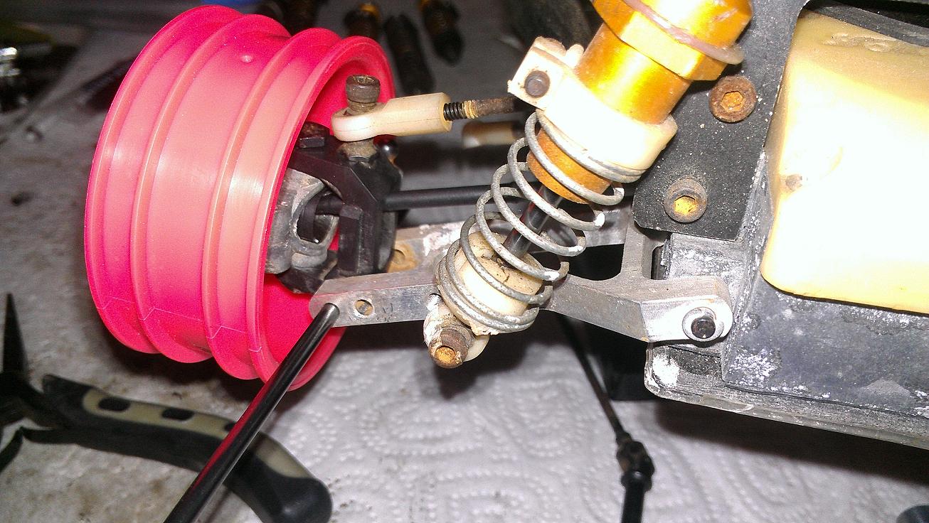

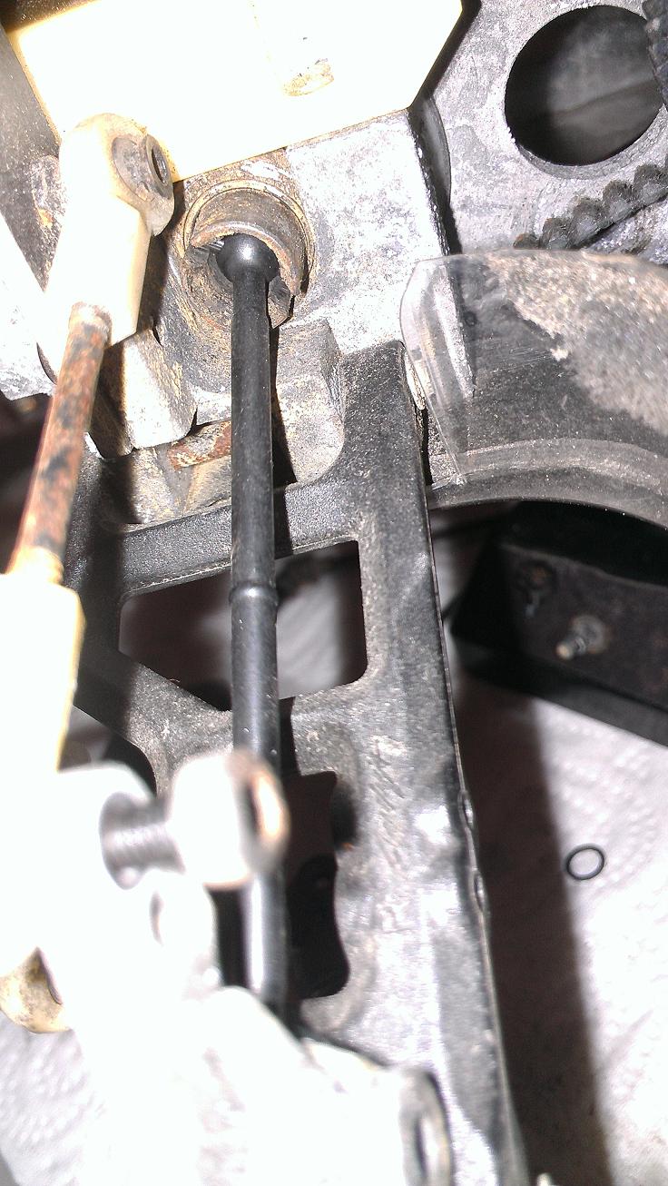

Now to the front...
I should note that the front wheel hexes on the DB01 are a bit of a pain, at least with the pink wheels. You really have to press to get them to fit. With the stock black wheels, though, I don't really have a problem. Anyway, I put the pink wheels in these pictures just so you can see what it looks like. An alternative would be to use the standard Tamiya 12mm wheel hexes and something like DF03 rims. Or...since 12mm wheel hexes are pretty common now, you may be able to use a different brand for this part (so long as they fit metric axles, such as Losi or Kyosho).
All clear.  No rubbing against anything.  With the suspension fully down, the steering block did bind up a bit, due to the joint between the dogbone and the wheel axle.  Compressing the suspension slightly freed this up.  I would expect that universals, or proper shimming, would get around this.
Front wheel mounted, looking nice and pink.
With the front wheel hex mounted, there is a bit of space to the outer bearing, but not nearly as much as in the rear.  A few spacers in here should do the trick.
