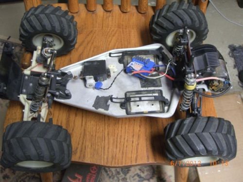

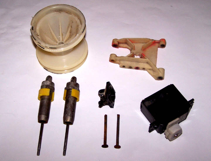

On a positive note, the truck did come with some rare upgrades (left to right top to bottom):
1. Lightweight "oval" wheels
2. Associated arms
3. Tamiya shock collars on corsion coated shocks
4. Pre-glued front hubs
5. Home Depot hinge pins (box of 500 for $3.49)
6. Very rare Futaba s-148 bluetooth servo. No wires required...just pair it with the receiver.
2. Associated arms

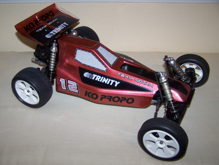

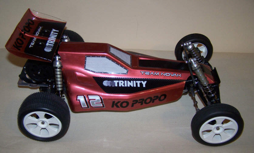

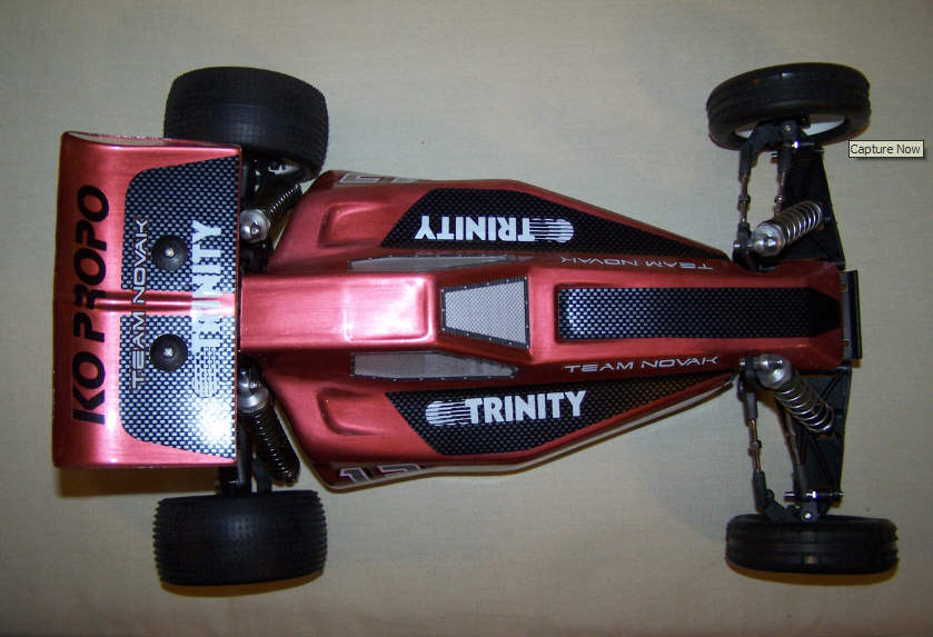

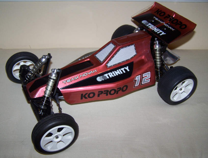

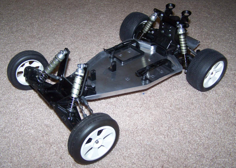

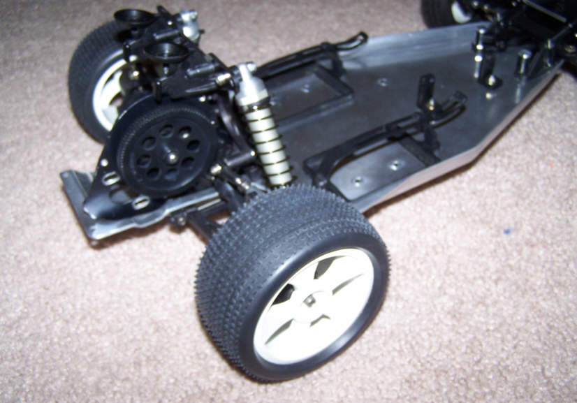

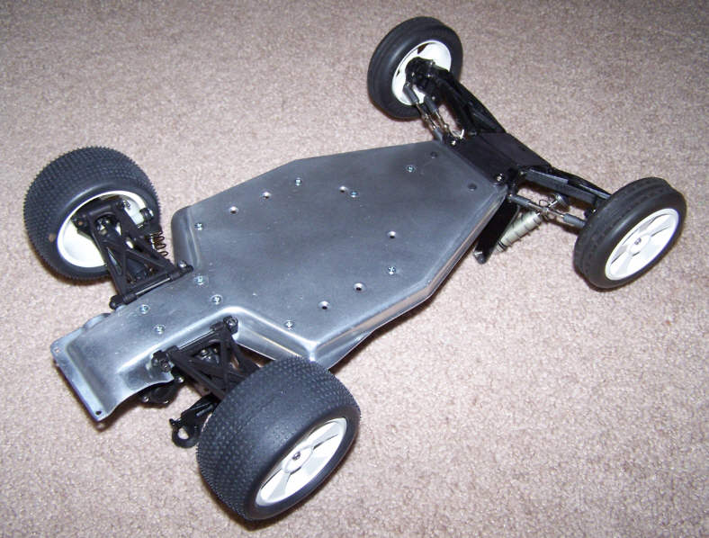

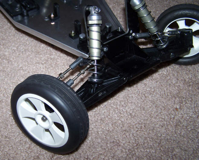

I've been gathering parts for months and since I had everything,the build came together really quick. I'm very pleased with the results.
I wound up using Assoicated shocka all around...the light green version with aluminum caps. The Schumacher shocks feel pretty decent, but they're not as smooth as these. I also wanted a medium length shock for the front, so they fit the bill perfectly. I used a B2 front shock tower to get the right amount of suspension travel.
I used the stock rear shock tower, but I mounted some wing mounts to it.
The chassis was polished and then I took it down a notch...so there is still a reflection, but not quite a mirror finish.
The wheels were from a Schumacher Rascal but I had to modify them to fit. The Rascal uses a larger bearing...so I had to shave off some material from the "castle" reducing the diameter. I don't think I've seen another Schumacher car with these wheels...it reminds me of the jrx2 5 spoke wheels.
I guess the biggest problem is what to call it. I'm not sure if I want to call it a Cougar..but it's definately not a Shotgun. Maybe "Franken Kitty"

I painted up a Top Cat body for this project and used....20 year old spray paint. Well, it didn't spray, so I had to break open the can and I BRUSHED it on. I was really careful laying down the paint because I knew it would leave brush strokes. I used Pactra Pearl Coral (RC 259) and it has a metalic color to it. With the brush marks, the body looks like it's anodized aluminum. I accidentally did this 20+ years ago on a different body, so I knew what the final finish would look like.
I threw on some decals, but I didn't have any Schumachers...I think it still came out pretty decent.

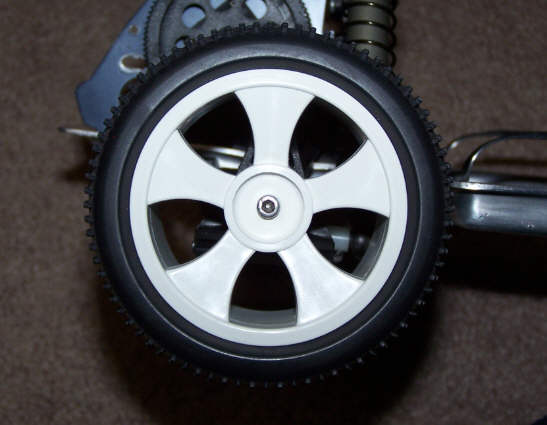

Thanks for the compliments guys. I got that can from a friend of mine...and I normally don't use colors like that. I mixed up my own green paint for my cars and when I use to paint bodies for people...they usually picked the standard colors. These oddball coral and metalic paints are begining to look very appealing to me...especially when using retro style design.
I really like the unique look. It's not a classic 5 spoke/star design nor is it a dish. To me, it looks like a modern version of the losi 5 spoke wheel. The part number is U3086 - White Wheel 5 Spoke Rascalisobarik wrote:loving the wheels so ill be stealing that for my cats btw have an part number ???
