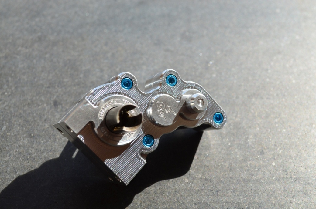

For the wing I'd pick up a pair of polished aluminum wing mount stubs made by companies like Bud's and I'm sure others. Maybe someone can post a pic of an example. If not, I have a set at home I can post a picture of. They mount to the back of the rear tower. They'd add to the theme very nicely. 8)

Will do on the spacers for the brace. I'd love to see one of those alloy wing mounts.

Sorry, quick cell phone pic. :oops: The wing wire sticks out the top and is held with a set screw. They stick out straight behind the rear tower.
