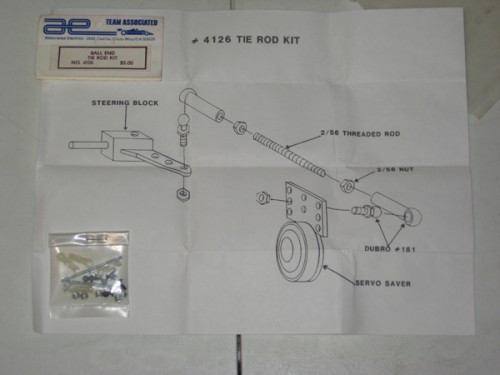

I was going thru some spare parts the other day, and I came across an Associated front steering linkage kit with 2-56 ball joints, let me look next week and find out the part number, maybe it's what you are looking for...

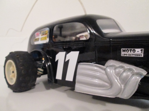

Before I completely hijack your thread, I will say that most 1/12 AE pan cars came with wire and collar linkage.
Your sponsorship certainly helped fund my transition to lipo. Thank YOU! :wink:
bomber (5) (480x360).jpg (94.29 KiB) Viewed 1910 times

I found the 1/12 steering linkage kit:

Post by clutchcargo »
Thanks Rooster, looks like they used 2-56 for sure, and the collars with thin wire. Thanks pal :D
