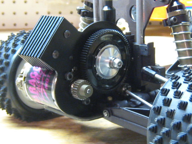

many years ago, i used those rods to create a lightspeed motor plate out of a hacked up original. worked pretty good. although i didn't anodize it afterwards, just painted it satin black.
i had a handful of the heat sinks so had to do something with them (well, one anyway

Those Litespeed sinks are cool. I had one on my Optima Mid. The only thing is I wish they allowed the rear curved part of the chassis to bolt onto them somehow.
