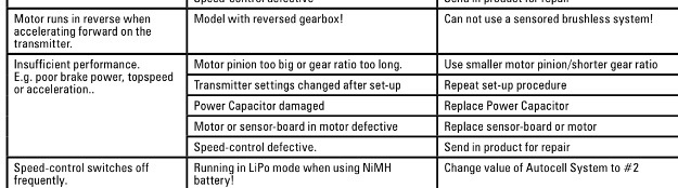

Hi, I have an 8th scale LRP SPX8 that I used in a Mugen MBX6 Techno conversion that worked great. Now have a Team C T8E that I am trying to install all of my electronics in but cannot get the esc to reverse rotation. It does not matter which direction I set the throttle, normal or reverse, the motor runs backwards for the application. Counter clockwise, looking at the gear end. I have tried numerous times to reset the esc to no avail. I have even tuned the esc backwards so when the manual says to pull full forward, I pushed the brake and then when setting reverse, I did the opposite and pulled full throttle so that when I pulled the throttle, the wheels turned the proper direction, forward instead of backwards.
However, this creates another problem. The second throttle pull is the brakes and the esc goes into reverse instantly, definitely not acceptable.
Please, can someone with an LRP help me out? How does one reverse the rotation of the SPX8 esc so that it is clockwise looking at the gear end?

Just got a reply from LRP. The SPX8 speed control is only meant to turn counter clockwise looking at the gear end. One cannot reverse the rotation of the motor period. Not the answer I was looking for. Too bad so sad, new esc coming up...

This is an LRP SX8 1/8th scale sensored speed control. It will not function non sensored. Sent emails to LRP and North American distributers to no avail. This is only one generation old and is not reversible. I have no choice but to buy another manufacturers speed control. LRP will not help. Boo LRP, all the bad press LRP has been getting just got increased by this post. Will not waste any time or money on any other LRP product.

Read the manual before you purchase, if your needing a reverse rotation setup make sure it's compatible. Don't assume, verify.
It's in the LRP manual...
