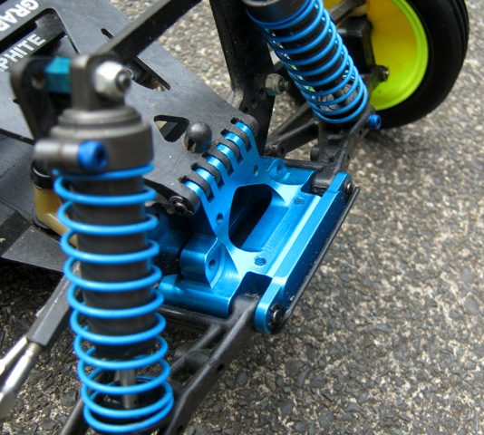

the car went real well on friday night, qualified first in the B final, and came third. :)
I defo need an alloy front bulkhead, just wrecked another today, the trouble is, the stock black one is thin, and now they are 20 years old, the plastic has gone brittle.
what are the white nylon ones like? they any stronger?
FasterLouder
Posts: 1097
Has thanked: 13 times
Been thanked: 59 times
Re: Losi XX~RS
Post by FasterLouder »
Nice one!
Appearantly the black one is stronger than the white one,but I've never broken either.
I think people prefer the looks of the black one,too.
Alloy Trinity ones are nice,but rare and super sought after.
Took me 5 years to find mine,and it cost a lotta money.
If you're going to run it hard,maybe try to find a used one with scratches that no one would put on a restored car?
They're super sexy,man...

Post by slapshot1979 »
Mytimac was working on front bulkheads for us losi guys as they are the weak point, and somehow have gone from a $5 part NIP to really expensive in a short period. not sure how that project is coming for him? If you think which I do, that this is something you will break often, think outside the box. You have done so much cool custom stuff to this, whats a custom front bulkhead?? Needs to provide kickup, hingepoint, mount shock tower. Alloy ones are dear and moves weakpoint somewhere else. not the be-all, end-all part IMO
great work I love it. Any chance of seeing some video in action?
slapshot1979
Posts: 928
Location: GTA Ontario,Canada
Re: Losi XX~RS
Just looked at your pics again and noticed. How did you mount original bulkhead as they hinge off of chassis which you dont have. Pics please..Inquiring minds wish to know. :lol:
Also assuming you tagged something with a tire and broke the hinge point outwards... the front tie bar across front might have saved this bulkhead. see fasterlouders pic for example.
