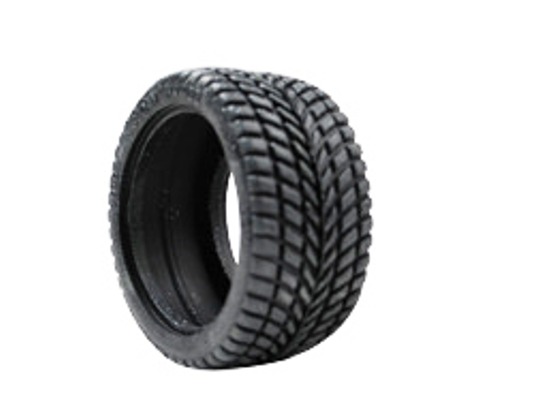

Thinking that my needs and tastes are running more in the direction of street and multi use treads. I just cant run these things off road. No track near here any more, so round these parts, off road means rocks, mud, stumps, curbs. We have a couple purpose built bashers just for that stuff. For 2.2 stuff the dirt hawgs seem to work extremely well, especially on road, but off road too. Would be nice if pro line offered them in a 2.0 size. Back in the day we also ran street hawgs, sedan hawgs, and road rages, but those are few and far between in vintage sizes.
- Posts: 1191
- Location: Spokane, WA
- Has thanked: 170 times
- Been thanked: 23 times
Re: Recomendations for tires that fit 2.0 rims
Imex still makes the 2.0" Sedan Hawg
http://www.imexrc.com/servlet/the-452/IMEX-SEDAN-HAWG-%28PR%29/Detail

Apologies y'all...I'm still having a heckuva time finding a set of STREET tires for this sucker. I'm never 100% sure they are going to be a direct fit with no modifications/adapters required. I like those IMEX tires, but on their site it's not clear which rims will work. Kyosho only has block patterns to order as "option" parts, and nothing designed for the street. I know there are tons of options out there but I'm just sure I'm going to wind up ordering the wrong ones. I'd prefer a premounted set. I'd sure appreciate it if anyone could post some specific combos that are the same size as the OEM sets or close enough not to notice. Thanks!
- Coelacanth
- Posts: 7421
- Location: Alberta, Canada
- Been thanked: 325 times
I doubt those Imex Sedan Hawg tires linked earlier would work. They're meant for 26mm touring/drifter car wheels that are too narrow. 2.0" vintage rims are typically meant for tires that are at least 32 - 37 mm wide...at least for rears or 4WD cars.
I too would be interested to source decent asphalt tires to fit 2.0" vintage wheels, tires that would be around 35 mm wide.
