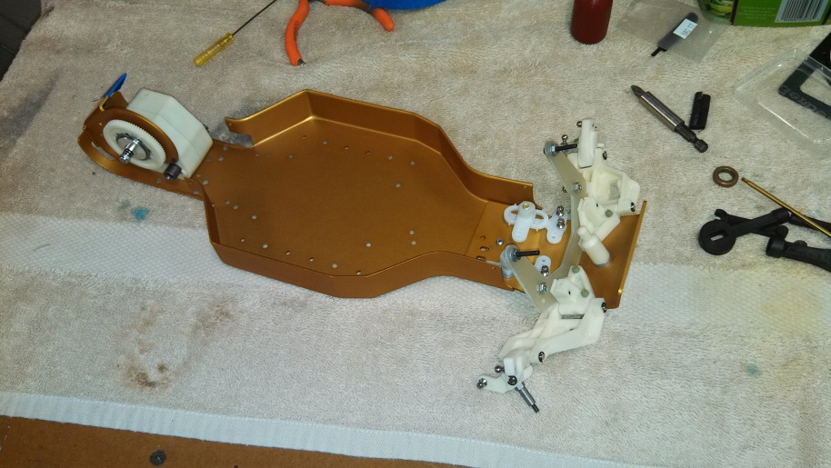

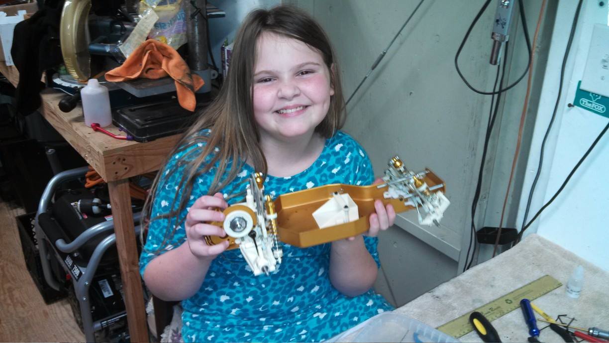

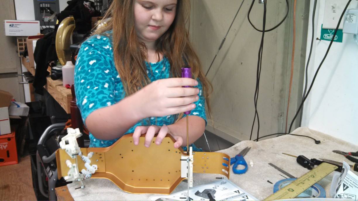

Got started today. I wanted to make sure we got past the typical 'got the front built and chickened out when we got to the 6-gear' syndrome, so the front end and transmission got done today. She's doing great.
I am reaming all of the hinge / king pin holes out with whatever bit is the next one larger than 1/8th, probably 17/64th. This works perfect. I still have to work on the actual parts fit between the knuckle and the front c-cub but it's not terrible.
Transmission went together fine, however the bag with the diff balls and plates only had 7 DIFF BALLS IN IT. Damn QC..... Definitely wasn't lost, was just never there, we dump the bags right into tall plastic tubs. I was also missing one e-clip for the front end. I must have gotten a friday afternoon kit........ :)
Luckily I had an extra new diff ball and c-clip in my stash.
Otherwise everything has been good up to this point.

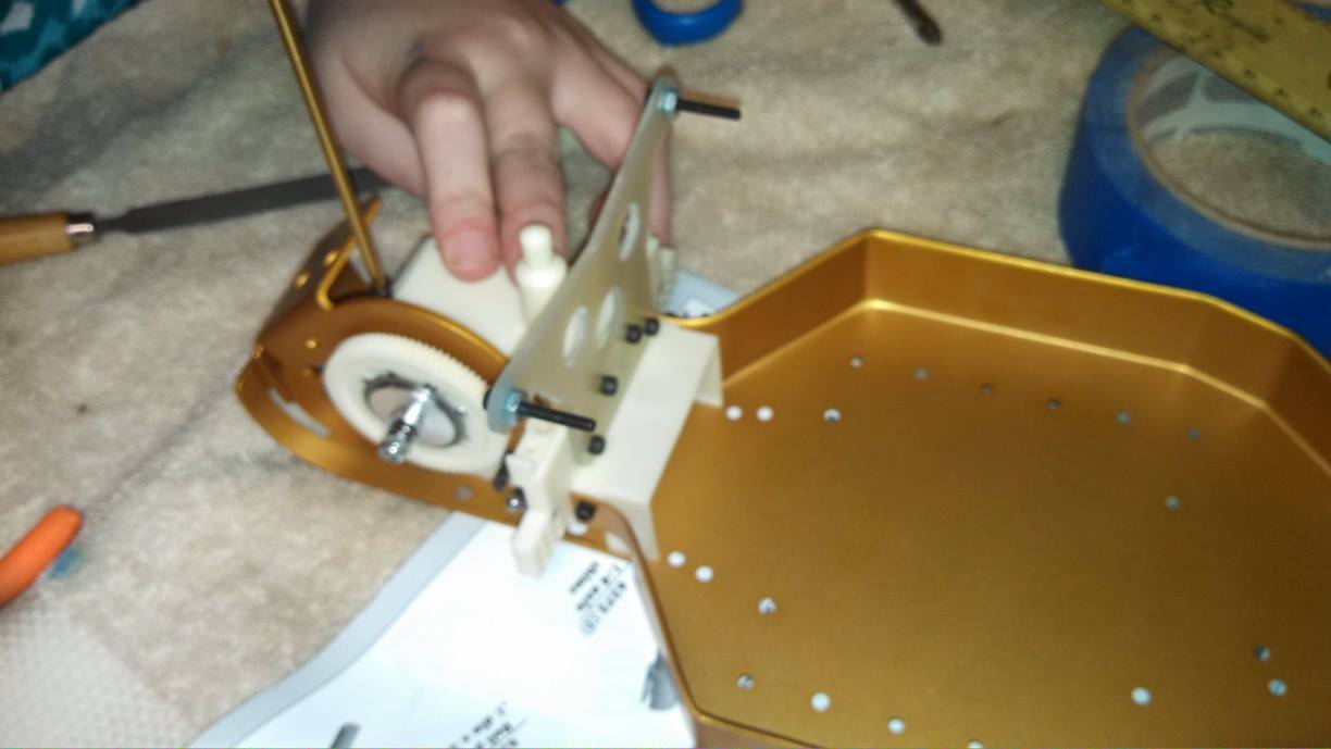

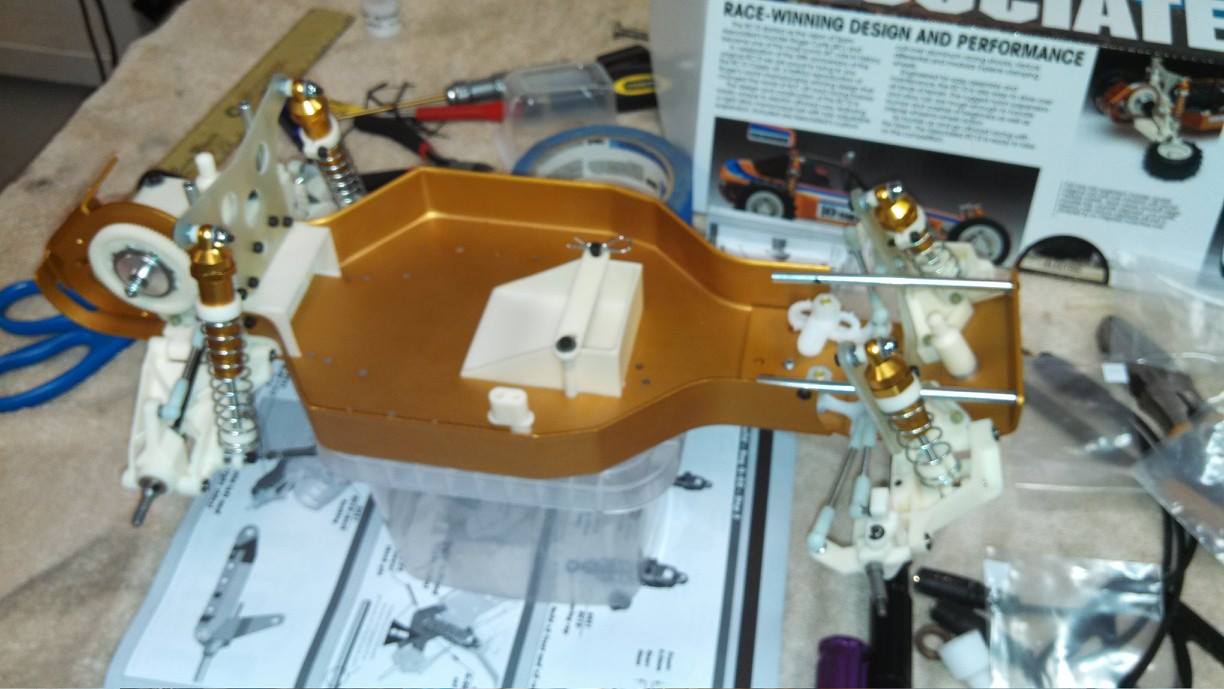

Transmission. I installed most of the e-clips, and screwed down the 8-32 aluminum screws since they're so hard to turn in the new nylon. She has done just about everything else herself. Did did want to try an e-clip, and snapped that sucker on first shot. But then decided I should do them... :)

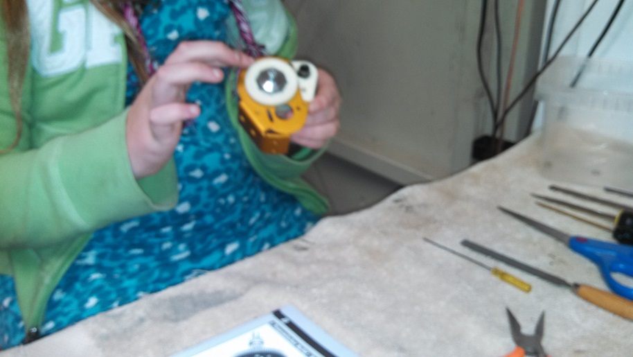

We had a hard time finding that little wrench.
Wasn't with the rest of them, it was bagged separately, so we thought it was missing (after the diff ball and e-clip issues lol) and spent about 10 mins digging through my allen wrenches looking for one that small. Had none. Was about to give up when I spotted it still in another bag in the box.
When I found the wrench after saying it was time to take a creak and regroup (in 10 year old terms), Amber said "see the buggy doesn't want us to quit yet" :) Who was I to argue.

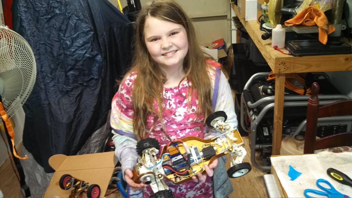

Snuck back out to the shop after dinner probably around 8:00 and worked on it till way past bed time :). lol....
Almost a roller. She will only let me do the parts she physically cant, like driving home the 8/32's in the chassis nylon, or twisting the turnbuckles down to size, or clicking the shock seals down into position...... this will definitely be her car. :)
Status as of tonight:
