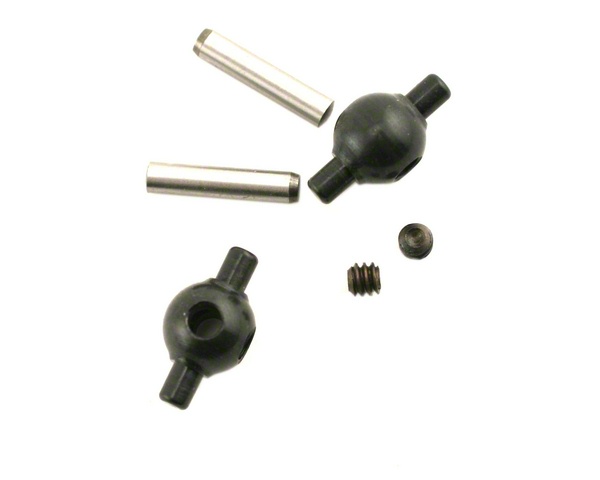

For your driveshaft woes, try picking up rebuildable universals from the xxx I believe and Traxxas bandit drive shafts. That car looks great considering the use it has had :)

clm wrote:For your driveshaft woes, try picking up rebuildable universals from the xxx I believe and Traxxas bandit drive shafts. That car looks great considering the use it has had :)
chris
Indeed, the TL part number that Chris mentions is the A-3027 Universal Bearing Cross.
