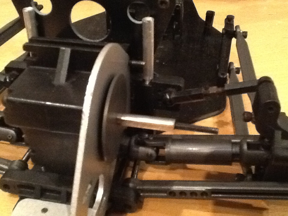

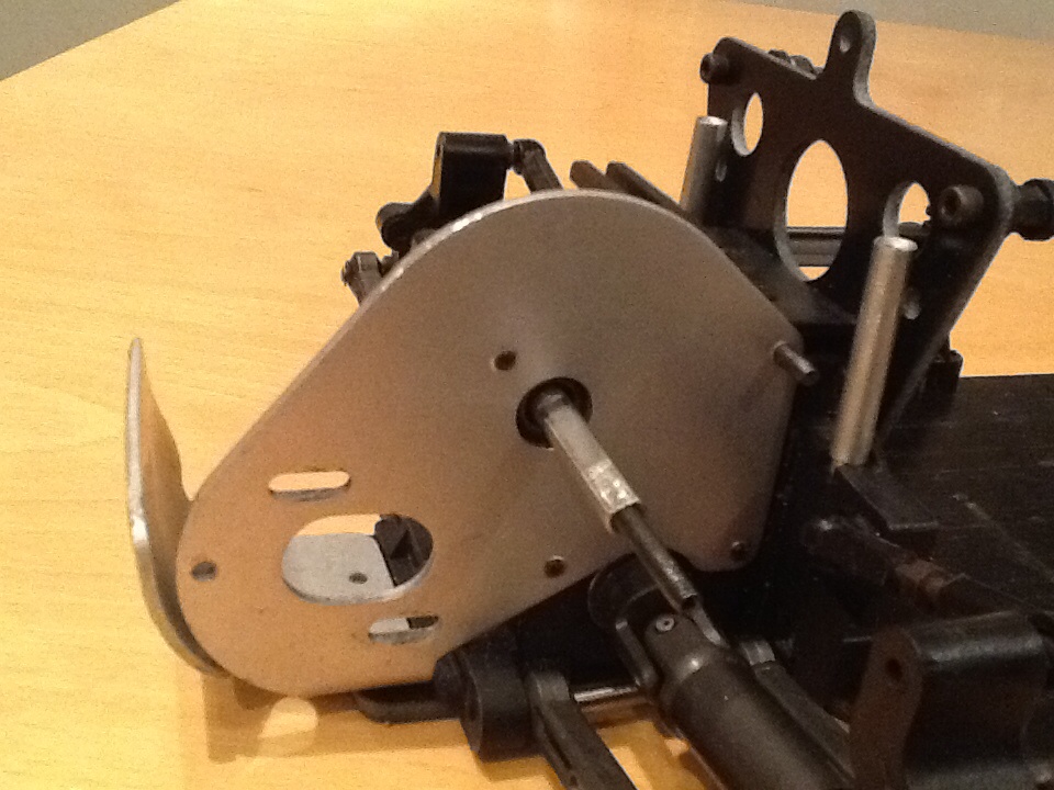

Hey LosiXXXkid. I have all the parts for my re-build including all the slipper parts. When I put the gearbox together I have two issues:
1. The replacement internal gearbox pinion gear is a fraction bigger than the standard gear so the gearbox has tight spots. I've done a bit of filing which has helped but not completely removed the problem.
2. The slipper back plate is touching the gearbox casing (on the boss) so that when the slipper is fully assembled and the nut is tightened it's not longer free running. Any ideas?
Thanks

aggpm09 wrote:Hey LosiXXXkid. I have all the parts for my re-build including all the slipper parts. When I put the gearbox together I have two issues:
Thanks
Can you upload some photo's....? It would really help to see what's going on! You can see my gear box in the previous posts in this thread and I had none of the issue's which you mention and I can't think what might be causing the problem.

Post by aggpm09 »
Photos attached below. I should say I have now filed the boss on the slipper back plate to see if I can stop it touching the gearbox housing. The end result is no different except the backplate is now very close to the motor plate. I am thinking I should order another pinion shaft and backplate to see if that makes any difference. I'm open to other ideas though...
