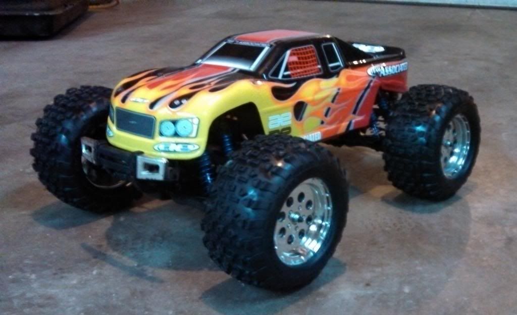

I loctite the dang things, but it seems to make little difference. I think it's time to mill some from 7075-T6 and leave a taper in the last 2 or 2 threads.
I was honestly surprised to find the MMGT only has two spider gears, but I ordered 2 pairs of replacements, so we'll see if I can notch shafts and put two more in there. The little truck could stand to have a lot more front end traction, and I think 4 spider gears + 60K oil would be just the ticket! I like the little beast (it's new to me as of Saturday), but on loose surfaces, I found the rear trying to outrun the front quite a bit. It's also a little tippy in the corners, so I'm gonna see about making some stabilizer bars for it. I know it's really just a basher anyway, but I see no reason it shouldn't be able to cope with a 1/8 scale type track pretty well if properly set up. I can't complain, though. I only gave $100 for it, and all it needed was a good cleaning, a front bumper and one shock. Didn't come with transmitter, either, but I really couldn't care less about not having a 27 MHz radio included, as I would have replaced it and given it away anyway.
