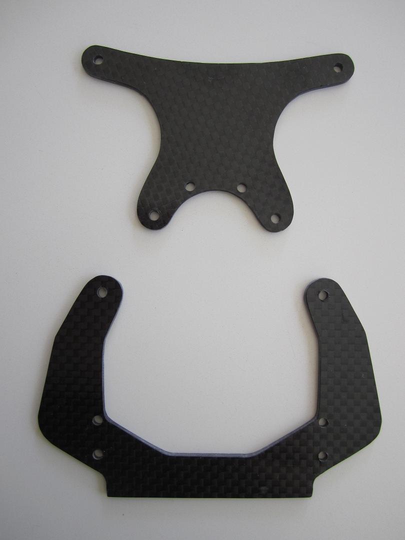

Love the shock towers!!

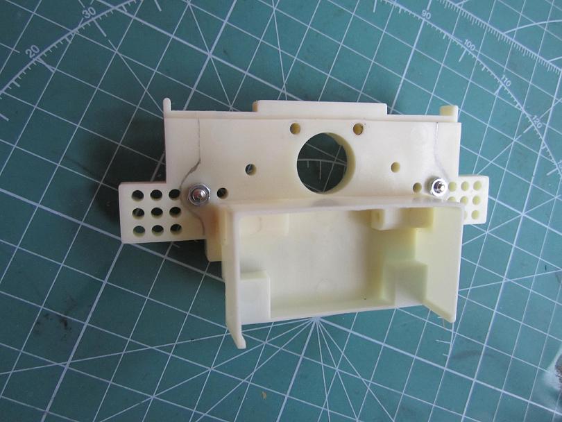

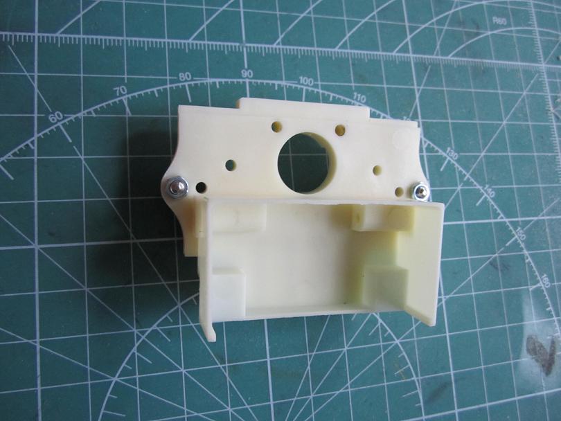

Thanks rcracr20. Had to wing it from the pictures that Cedric had taken on his build.

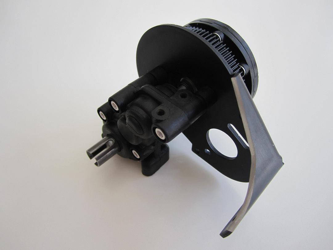

Rear bulkhead met the Dremel. removal of the "ears" and added world's holes.
Next a black dye cooking.

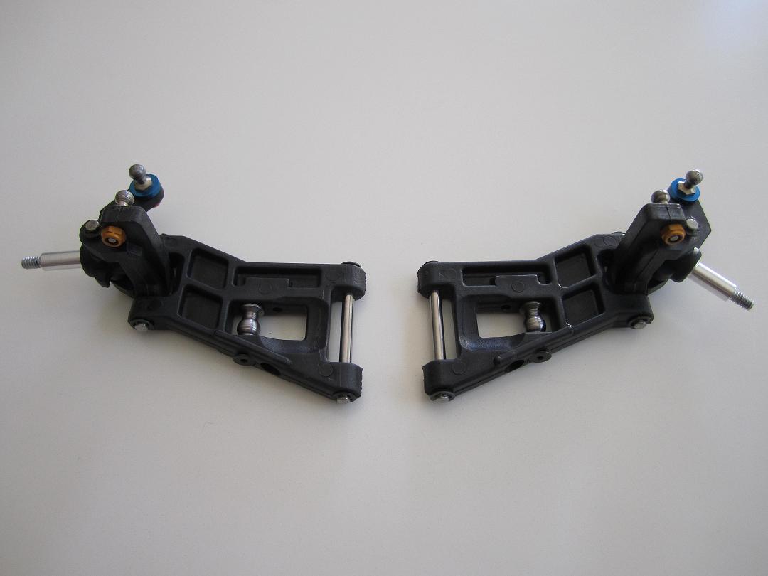

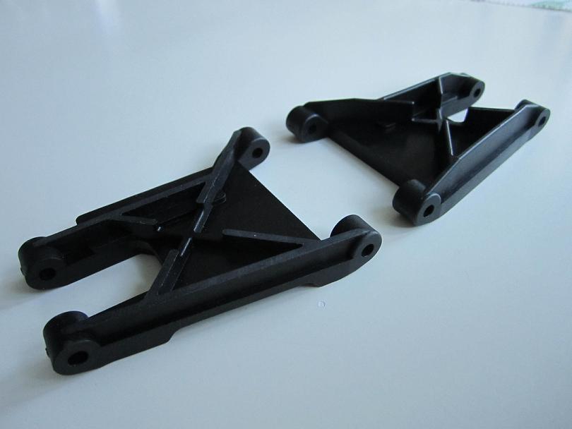

Rear A-arms in the making.

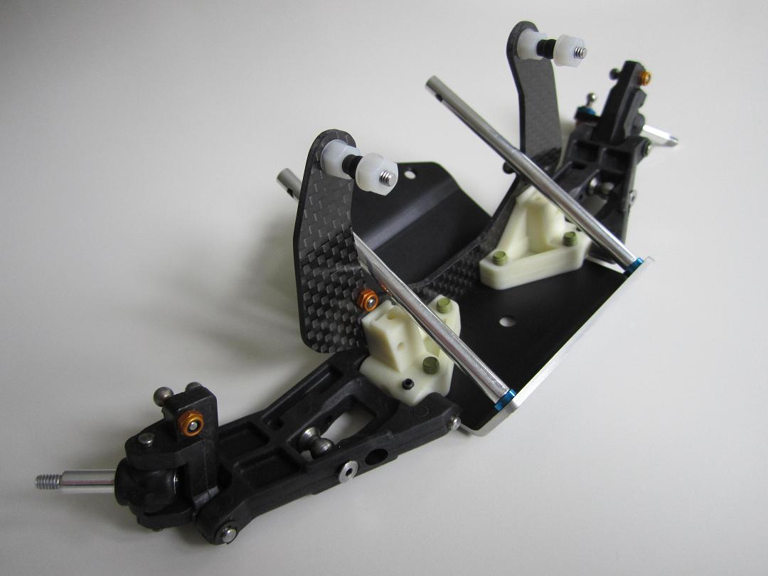

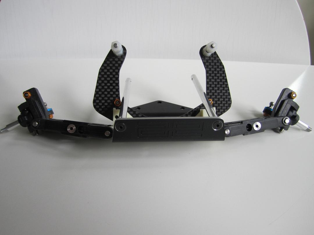

Post by sandkil »

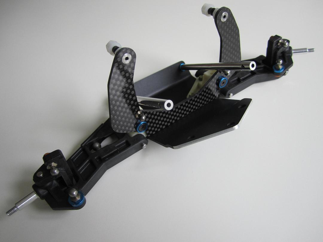

The front end assembled. Still waiting on the turnbuckles to arrive.

Post by abailey21 »
What do you use to get such a clean cut on your front plate and motor plate?
I tried an old gold pan with my dremel and it turned out looking like crap
jwscab
Posts: 6580
Location: Chalfont, PA
Been thanked: 505 times
Re: My 1993 Brian Kinwald WC re-release build
Post by jwscab »
I use a belt/disc sander, but you can use a file, block and sandpaper, or DA sander, etc. Something with a flat reference surface behind the abrasive/cutting tooth so you cut a really long surface all at once.
sandkil
Posts: 1082
Location: Stockholm Sweden
Has thanked: 795 times
Been thanked: 623 times
Post by sandkil »
jwscab wrote:I use a belt/disc sander, but you can use a file, block and sandpaper, or DA sander, etc. Something with a flat reference surface behind the abrasive/cutting tooth so you cut a really long surface all at once.
Thats what I use. First a dremel or similar with a cutting wheel, then a file and last a block with 600 grit paper.

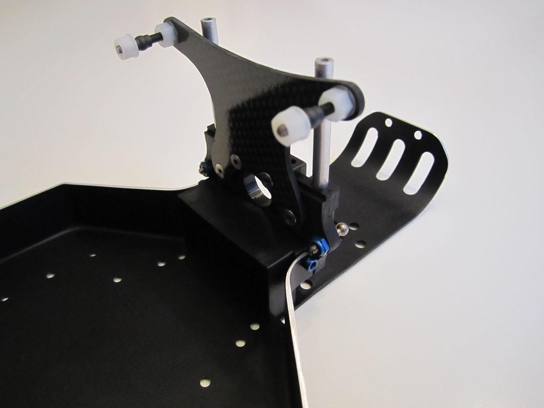

Post by sandkil »

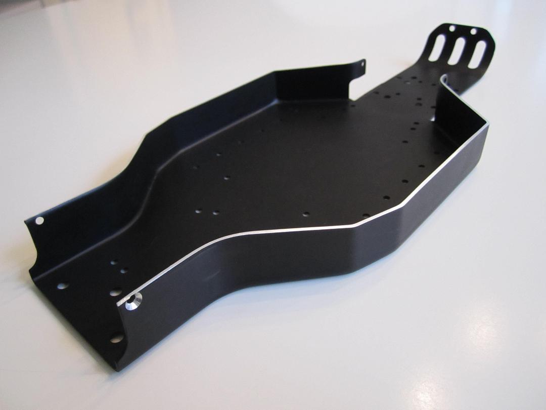

Some more progress on the build.
Did some work on the Chassis and installed the bulkhead.
Not sure on the blue anno 4-40 lock nuts. A bit big I think.

This project is super clean.
i love the bare metal edges on the chassis.
Im not a buggy guy but im liking this a lot.

That looks amazing.
Interesting way to build the front end. I like it. Not at all now the instruction manual says to do it, but it makes sense. Nice.
