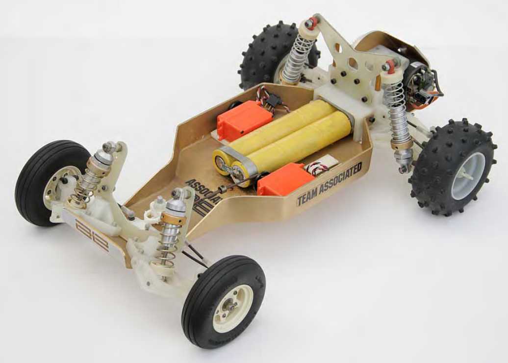

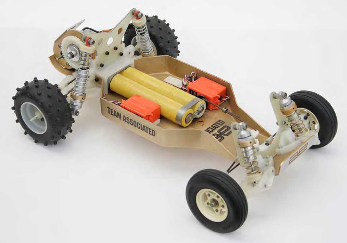

I've decided to attempt the build of Gene Husting's First RC10. Since I do not have the skills to hand form a chassis, the basis of the build will be a Classic RC10 Re-Release. My goal is to use as many Classic parts as possible, while staying true to the theme. Some of the non-classic parts will include:
Single Stock Servo Saver mounted in the center (Have)
Tamiya Frog Front wheels and Tires (Have/On Order)
Nicd Sanyo Battery Pack w/ Duct Tape Bands on each end(Have)
Novak Servo's (Have)
Reedy Modified Motor (Need)
Black Associated Decals (Have)
Rear Tires - Proline Knobby (Have)
Wing Tubes - Anodized Gold (Need to have done)
Tie Rods and rod ends (Need to find)
6-Gear Trans - Remove felt seals and caps (Have)
Original nose, trimmed per photos and AE logo sanded (Need to find a clean one)
Chassis - Trimmed per photos's (Have, need to trim)
Shocks - Strip gold, Aluminum Collars, Dye Rod Ends Red, Edinger Style Spring Cups (Need to make)
Rear Shock Tower - Custom Fab (Need)
Receiver - N/A???
Speed Control - N/A???

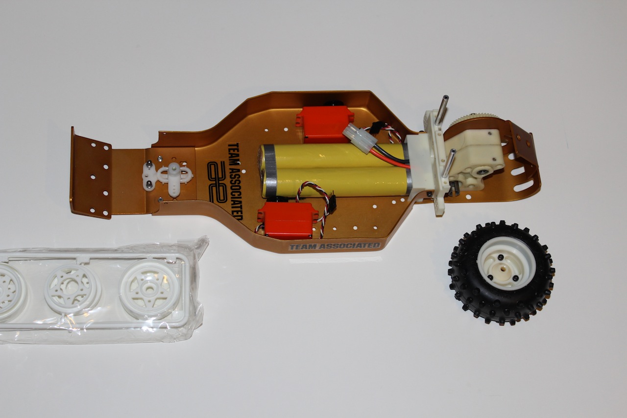

I plan on trimming the front of the chassis to match Gene's. Eventually I would like to re-anodize aluminum parts to a light gold.
Future Improvements:
I would love to somehow procure a chassis without the 4-40 holes
Machine some of the parts out of nylon
Let me know your thoughts/suggestions.

HI!... Pretty easy to do. I've been building one for about 4 months now. Still working on the perfect colour match for the chassis in powdercoat. I hate anodizing. I've got everything done but the custom front/rear shock towers.

HI!... I cut and modified both the chassis and nose plate. Tig welded up the chassis and tig'ed up all the chassis holes not in use. Sorry, no pics yet.

Il looks like the nose plate is polished on the front but the AE logo?
