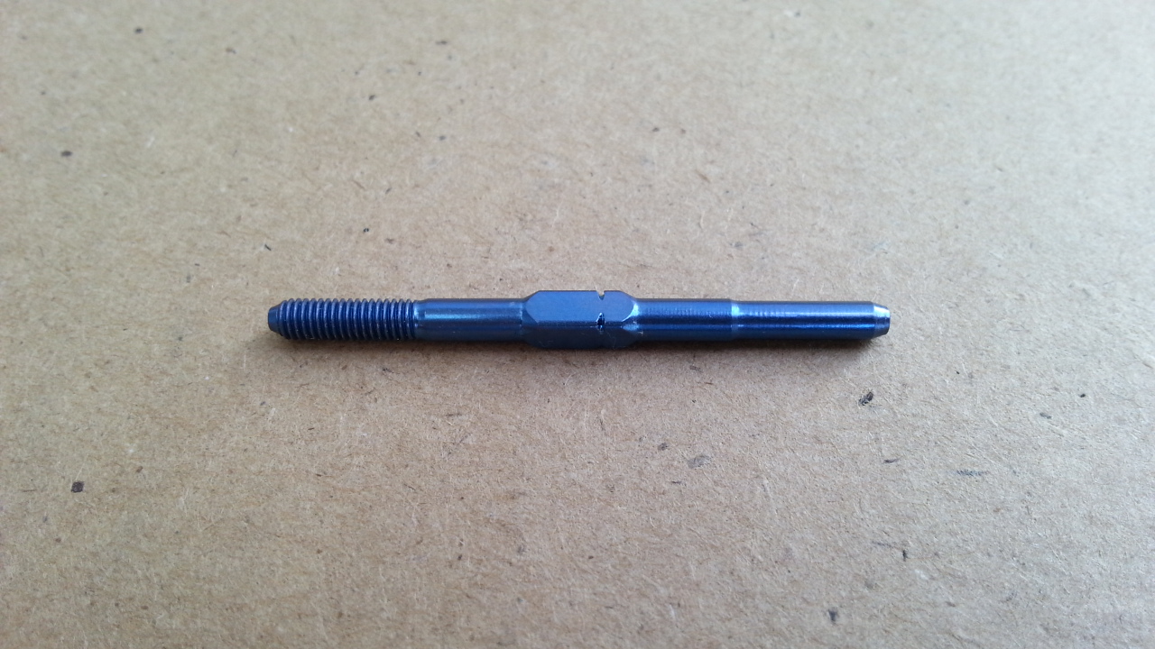

I just bought some new rpm ball cups and some factory team Ti turnbuckles for my 10T and for the life of me I can't get the ball cups to thread on two(of six) brand new turnbuckles!!! Anyone run into this before??? All the rest went on easy! Only thing that I can see is that the threads don't look like they are cut on an angle.

Slide your fingernail into a grove and twist, see if it was rolled incorrectly. I've had turnbuckles before that had no twist to the threads. It happens, but rarely with 6!

One end is Left hand threads and other is normal right hand threads. The ones that dont go in try turning backwards to what your used too.
I like to use a drill with rod chucked up and work ball end in out a few times to make it easier to adjust later

One is clockwise, the other is counterclockwise.

Yea, I've tried turning clockwise and counter clockwise lol. There don't appear to be an upward twist! they just spin and spin, no grab.

Definitely sounds like a turnbuckle problem for sure.. One tip I like to do is to chamfer the inside edge of the rod ends with a reamer or cs bit just enough to clean up the inside edge and make it easier to get them to run true when fitting..

Seller told me to contact AE. AE is going to send me a replacement!
