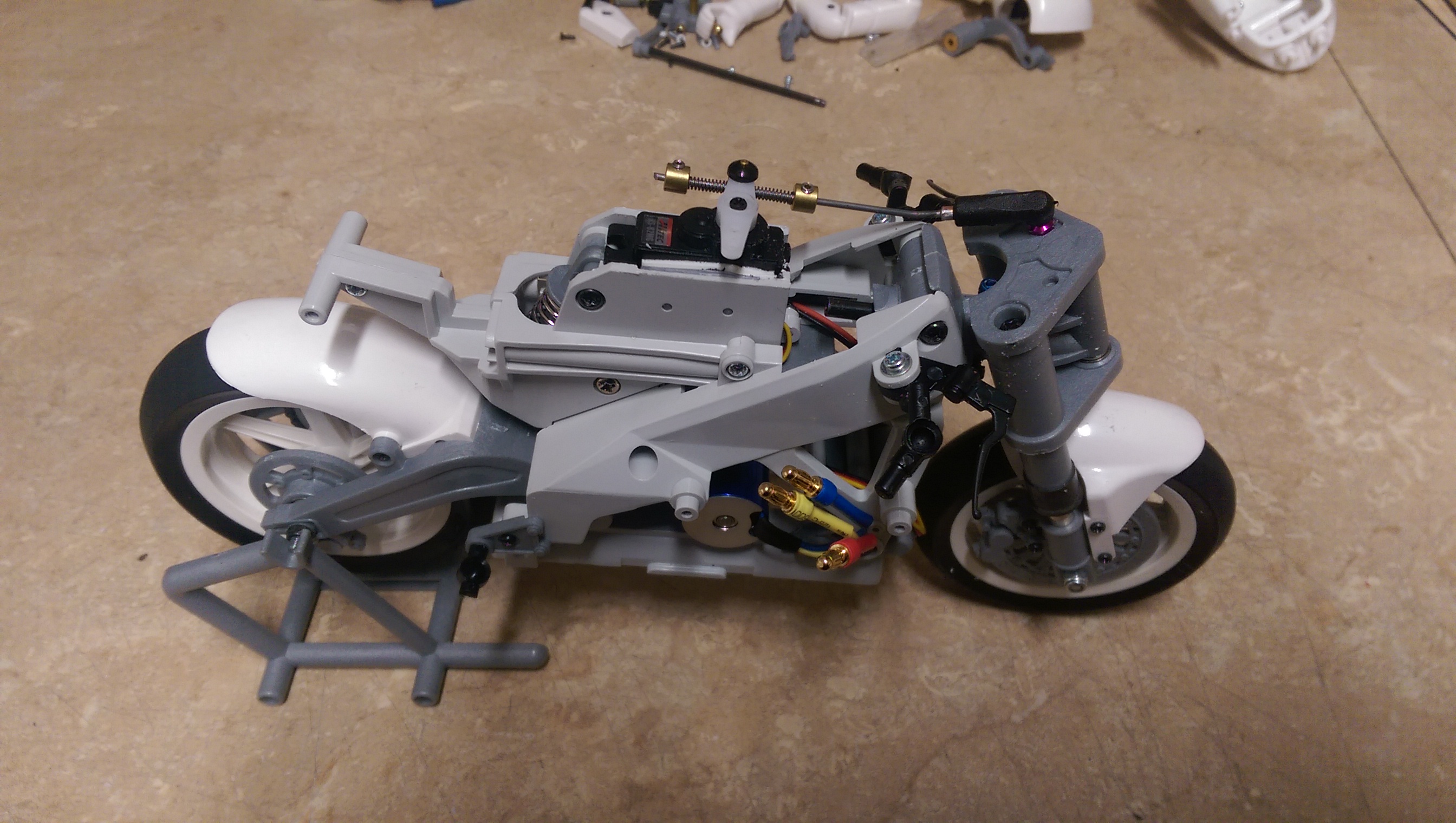

Finally sat down an played with some things today. Got my oval washers on the gearbox, installed the lower kv motor, and locked up the head/set up the direct steering. Once I know this works as well as they say it does I will make the head more permanent and trim off the shaft leaving me with room for a brake servo. Also plan to run a micro servo for the rider, that should be interesting!
And yes, it fits under the tank!

This is small stuff, if a miniservo is that big :D
How does it turn? I think those I´ve seen shifts weight, kind of like a small gyro?

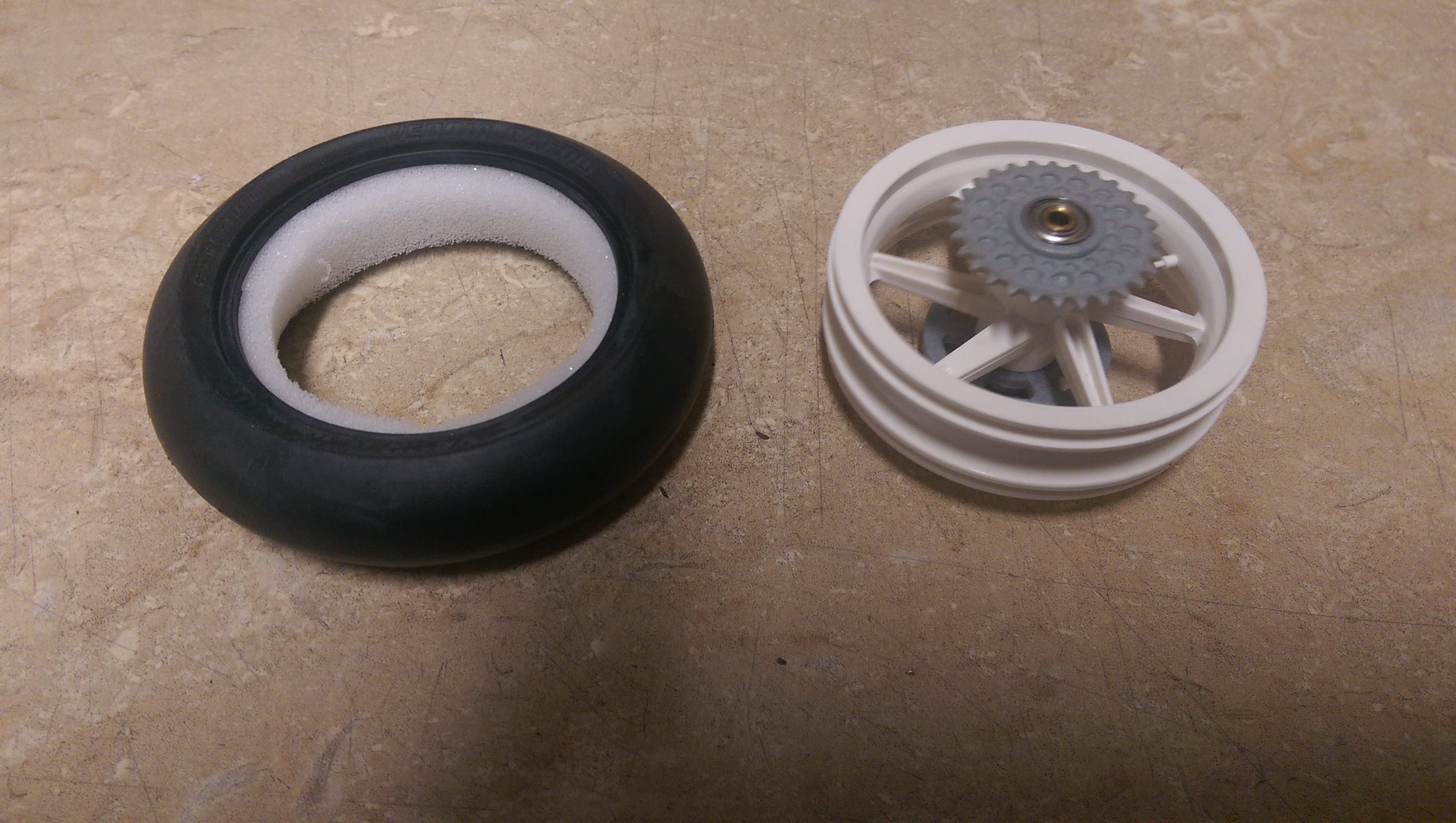

Weighted front wheel helps it stay upright, other than that it leans (stock) by throwing it's head off axis and the wheel just flops to where it's happy. The rider leans to help it also, but the old bike didn't and it handled better lol.
I just made a foam insert and mounted up the venom tire. Took it for a spin, it goes straight as a knife, leans instantly right to the bars but won't turn. On or off throttle. I have read that setting up the steering spring tension is the hardest part of the direct steer, so I guess I need to play with it more. It is faster than stock but so far the handling sucks hahaha
