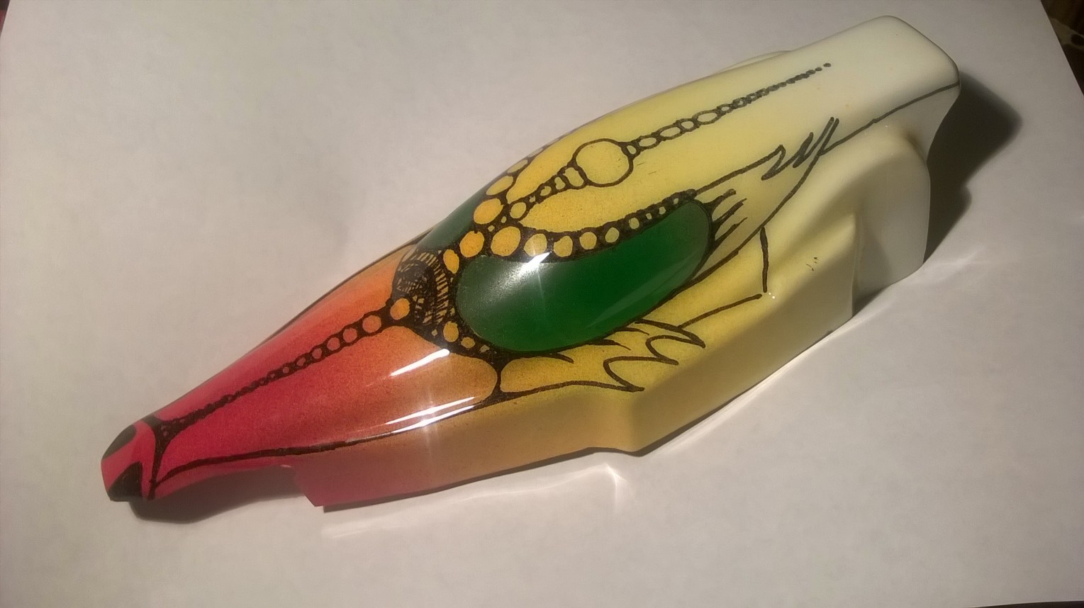

what im trying to do at moment. The darker part of the head is sharpie backed with the prismacolor marker. once the rest is back, ill try to mask it with liquid mask.

Re: Painting with sharpie pens
I just so happened to paint up this one about 3 weeks ago.
The black is alcohol marker, permanent marker or whatever you call them.
