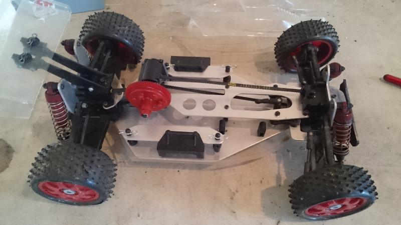

Anyway heres some pics of the cars, the NIB intruder box is in excellent condition, its tucked away safely for the moment and pics of the adonis
I just had a good look aver the Adonis, wow the car feels light, I know its got no electrics etc but I can tell it’s a light car, the body shell is very thin, its been cut pretty well, it will be a good shelf queen body. I’ll weigh the car as it is, then I’ll tear it down to nothing and start looking for suitable option parts, I’ve read that the kose drive shafts aren’t very good, I’ll make sure to Loctite the screw in it and running 540 shouldn’t stress them too much

You can run the adonis pretty hard. What breaks are the plastic suspension related bis. Hit a wall, or curb, and watch the unobtanium plastic bits break like a plastic model.
There was a guy in UK, who was going to list a bunch of tomy parts but apparently never did. Ive got same 2 cars,, the standard and the adonis. Both mine are used and abused though.
