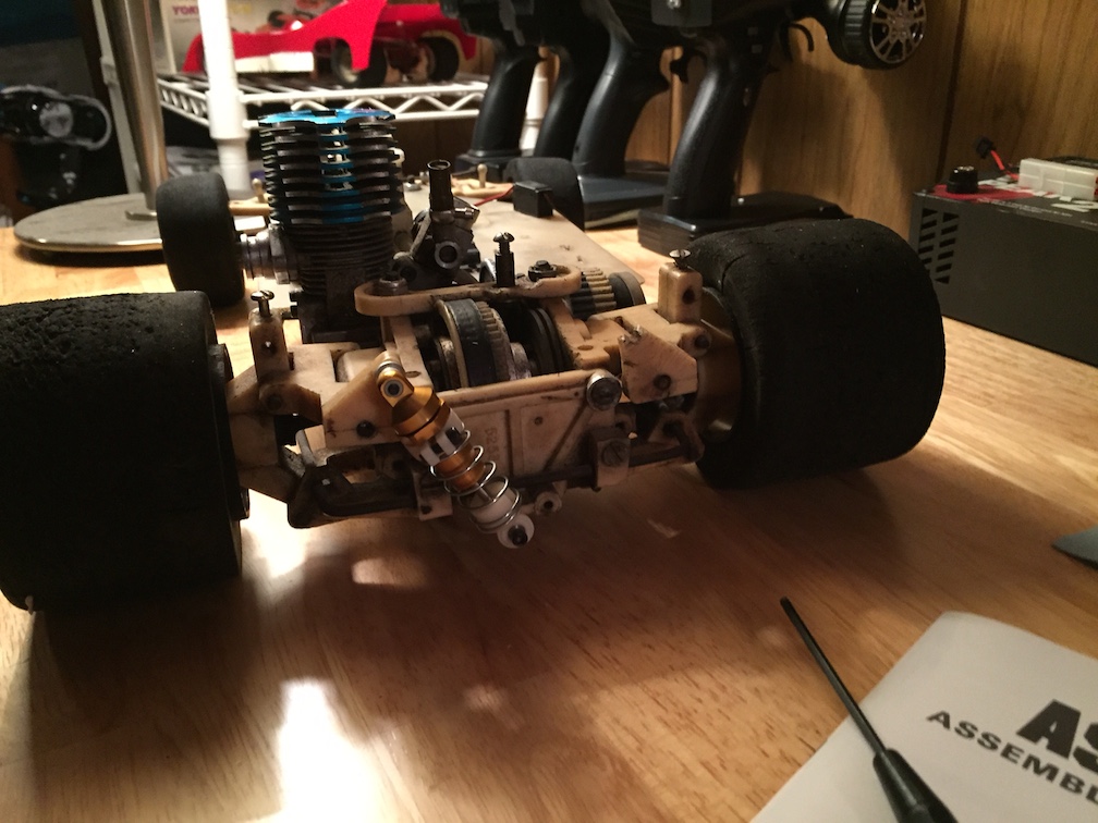

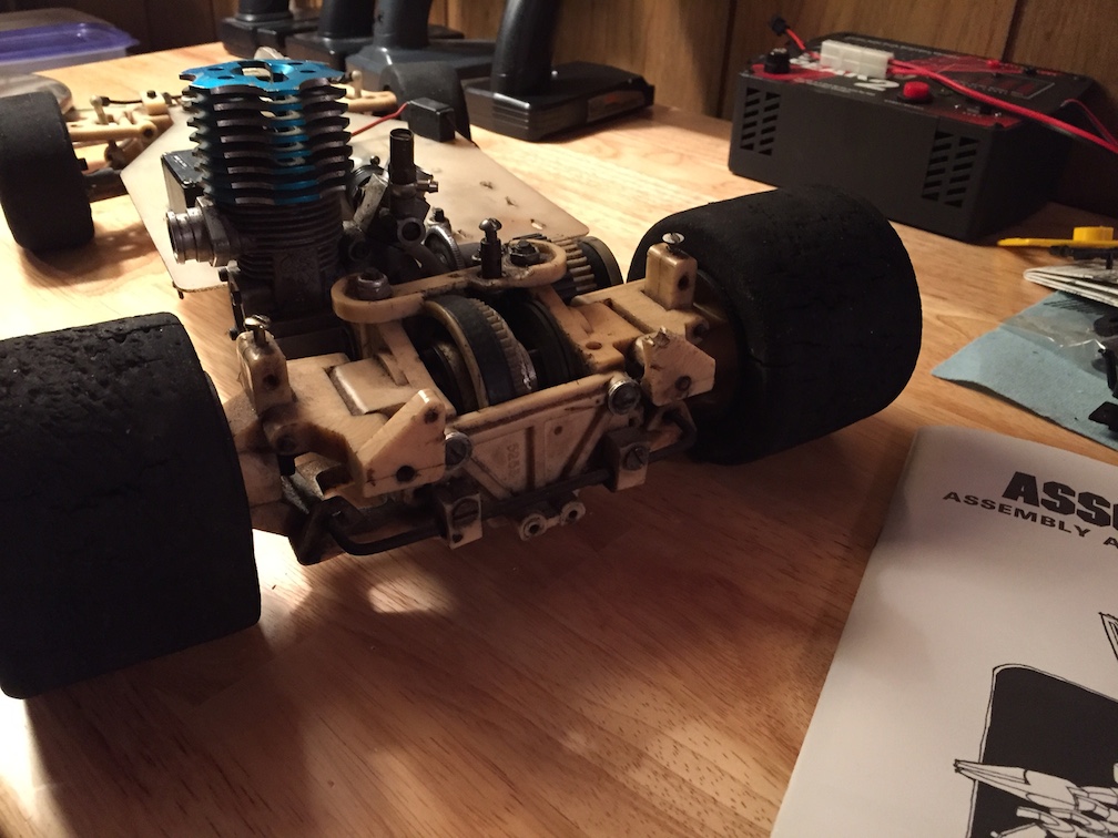

I picked up a 2wd RC500 a while back (pics below) without any rear shocks, and the upper shock mount broken on one side. In looking at a ton of threads and pics all over the place, it looks like there are two main rear shock mounting approaches. One, which is probably what mine had, that attaches the rear shocks directly to the upper arms and angle in to the middle at the bottom, and another that uses a separate shock tower and mounts the shocks vertically. This leads me to several questions:
1. Were those different versions of the car, or was the shock plate an option/upgrade?
2. Were the shocks the same? What shocks are they (in some cases they look like front early RC10, the fronts are the same gold, and I've seen references to "RC10 front shock conversion") ? I stuck on a random front gold shock and it fit pretty well - is that the same shock in the tower version?
I'm a long way from restoring the car, but looking to figure out what parts I need to be gathering.
Thanks in advance for the help!
Sten
Sten

I'm not positive if it was a running change or just a conversion, but here are the instructions for converting it along with part numbers

The shocks you have mount vertically. The smaller (older) style mount diagnolly.

Thanks guys! Great info! I think that, given the broken a-arm and the fact that I have extra front gold pan shocks, I'll go the route of the shock kit/tower - or at least start gathering parts for it. I love these cars/this era - they really expected a lot more ability and willingness to modify and be creative. Seems like half of the instructions were cutting up and modifying parts!

Be aware that the black rear shocktower requires two small spacers to mount it properly. The spacers are same material/thickness as the fibreglass shocktower itself, just under an inch long (I think...) and each one has two holes.

I have rebuilt about 5 RC500's, and I have found that most people don't pay attention to the assembly clearances of front, but especially rear upper and lower A-arms. These need to swing freely, and require a lot of careful trimming and reaming. Buy a few good chucking framers sizes .125" and .126" to make the hinge pins fit properly. But don't ream all holes, for instance the fit of the pins in the rear hub carriers should be tight.
Also, work in a specific order/pattern. For example, start on lower inboard, then outward below, then outward above, then back to inboard above...am I making sense?

Thanks - I was able to get the rear tower, and it has one of the spacers (I think - it's an odd shaped piece, 'bout an inch long with two holes, so sounds right) - will need to find, or make, a second.
Makes sense on the assembly/spacing front. I was just building a re-re RC10, and had to do much of that to get the front end working right.
