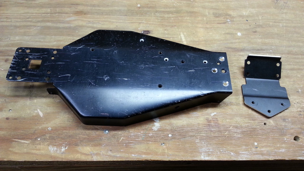

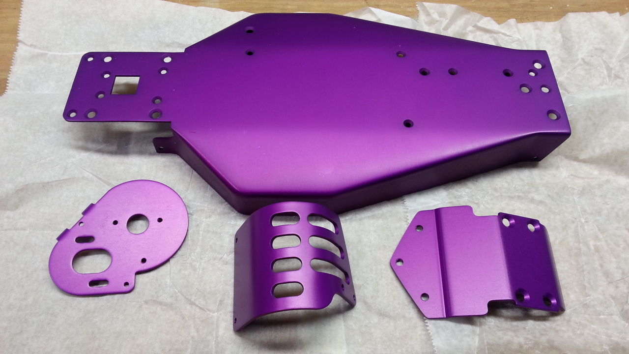

As if i really need another one of these, here's another one. :lol:
The starting platform....
I got the tub shortened and cut down the nose plate. There are a couple unfortunate holes in the tub. Two that were drilled to mount the servo a bit too far back, which wouldn't be a huge deal if they were straight. And then there's one in the tub side for the servo horn.
I don't have anything fancy planned for this. Basically just gonna build a used parts runner. If I make it too nice it will never get used.

I already did one purple. :wink:

Just curious what did it cost to have those parts anodized purple? I got quoted $90 to do a chassis, nose plate, motor plate and tubes.... Or $150 for piano black.

RC10th wrote:Just curious what did it cost to have those parts anodized purple? I got quoted $90 to do a chassis, nose plate, motor plate and tubes.... Or $150 for piano black.
$20, but I was in the position of knowing a guy that knew a guy....... :wink:

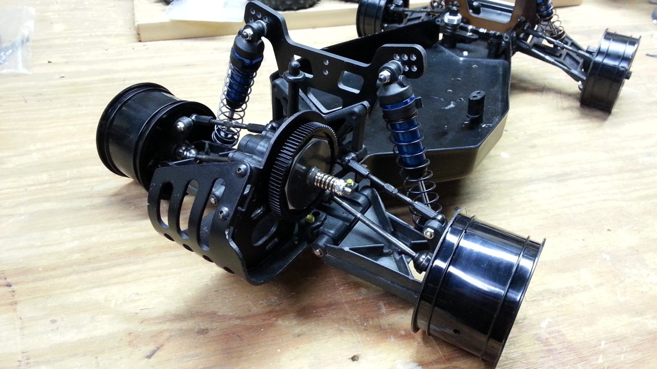

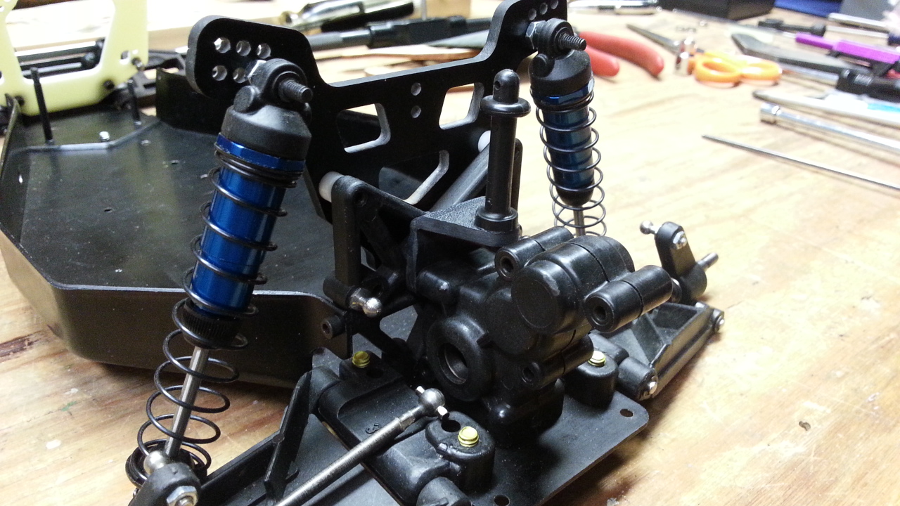

I haven't had much time these days for tinkering with r/c's. But this morning I sat down and fabbed up a kydex rear body mount. On this car, since I'm not planning anything extravagant (custom bulkheads and such), I decided to run the shock tower on the front side of the stock bulkhead with 1/8" spacers. Will probably need another 1/16" but it's a start. Shocks will be mounted on the backside of tower.
On my 1st and 2nd B1.5's i mounted a rear 10t body mount to the tower to attach the body. With the tower so far front that was not gonna be an option. So this 1/8" kydex serves 2 purposes: holds a front 10t body mount, and fills the void between the bulkhead an trans case.

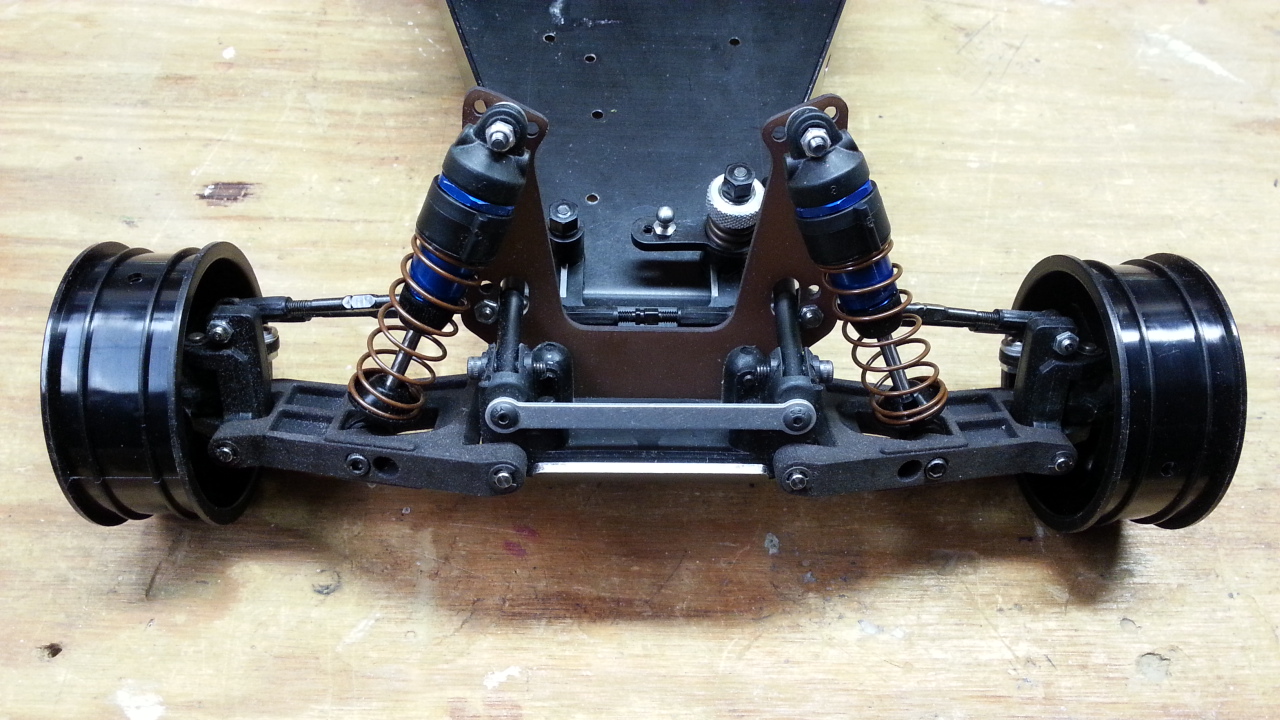

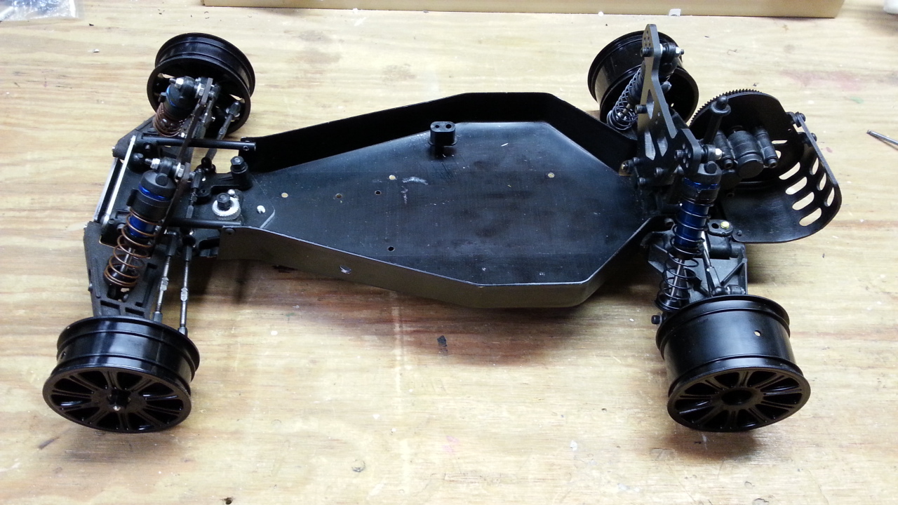

Made so headway on this one. It's a roller now. I still have to grab a front bumper and a pair of wide front axles, then figure out what i want to do about a battery box.
