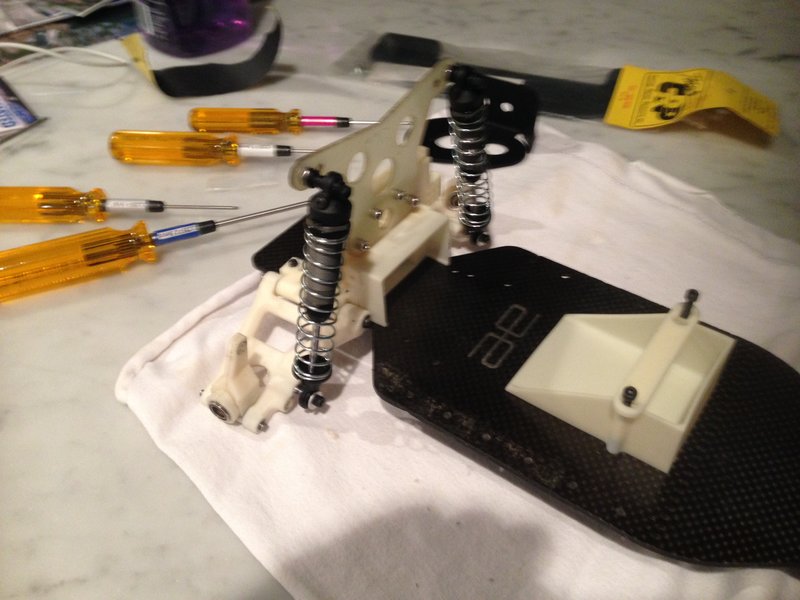

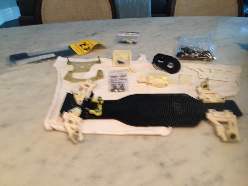

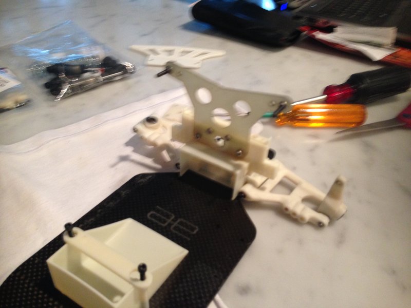

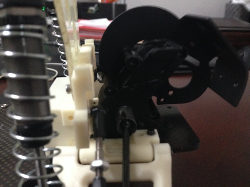

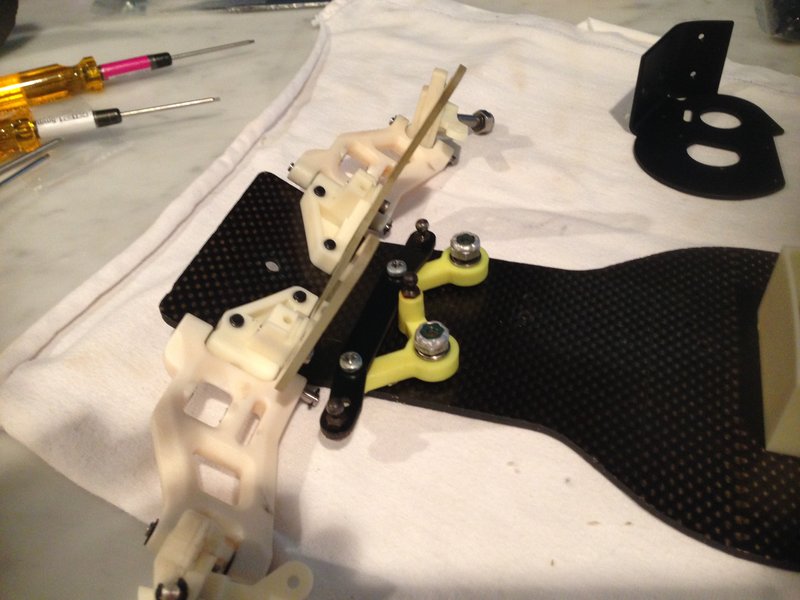

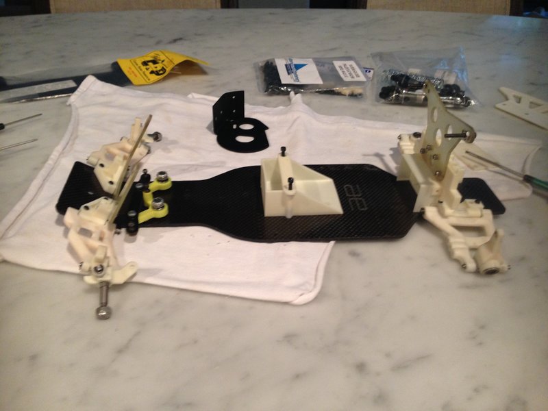

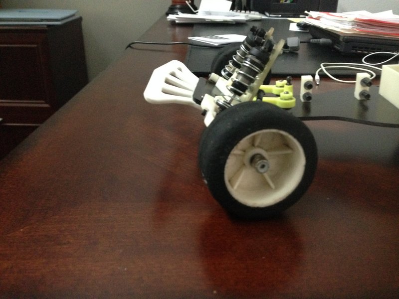

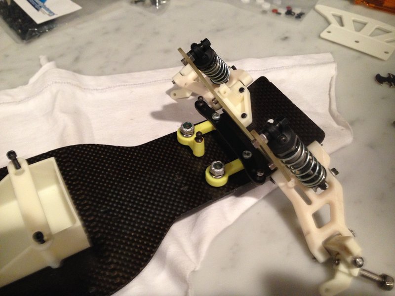

Here is the starting point - graphite chassis, MIP SP1 gearbox (freashly rebuilt), MIP CVDs (on their way), V2 shocks for now (if I can locate a set of MIP shocks I will swap out), lundsford retro turnbuckles (on their way), Andys arms both front and back, standard shock towers, Andy's front bumper, A&L steering (I have it inverted right now since I was having a clearance issue with the graphite chassis).
I am new to this forum, but the information exchange so far has been great. I was having so much fun with this build I started a similar build as well in a black theme though...almost identical as above.
If anyone can provide guidance on the A&L steering issue, it would be helpful.

I use a thin 8/32 aluminum nut to secure the steering post screws and add clearance for the chassis and linkage.

Thanks for the advice with the nut...I will try that.

Also, if using the thin nut you are not using nylon steering posts to secure the screws. The post can be left hand tight as they are no fun removing if the screws tweak!
Re: New Build - Graphite, Andys, MIP

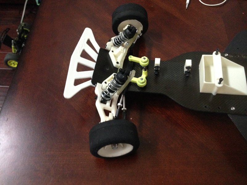

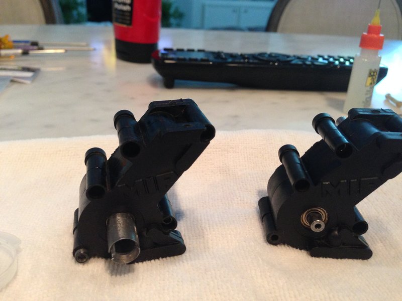

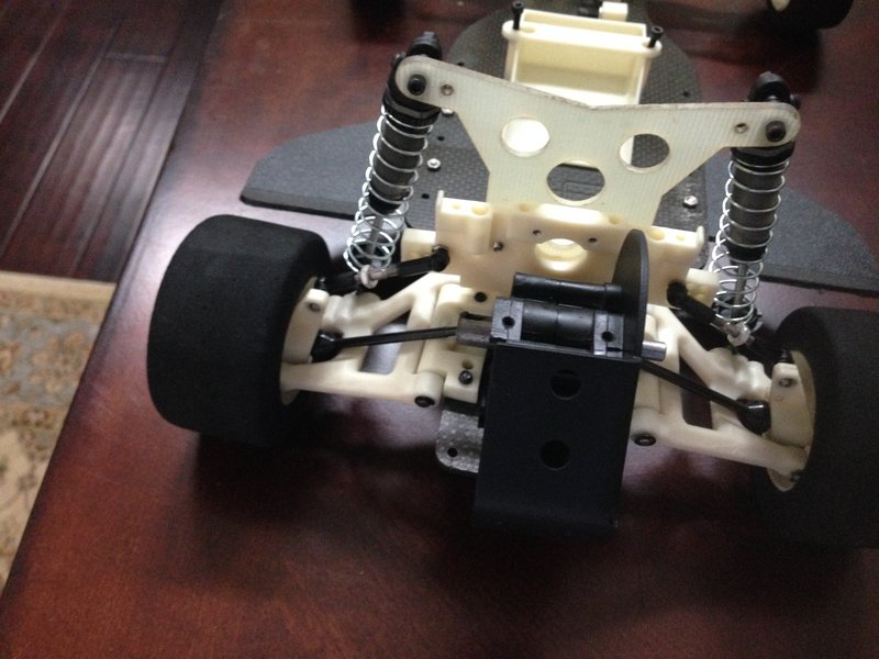

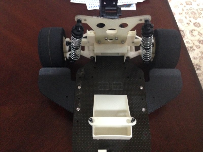

Had a chance to do some more work on the build. I fixed the Al&L sterring issue I had with a thin nut as a spacer (thanks knucklebuster). I added the Andys front bumper, Lundsford retro titanium turnbuckles, Thorp heavy duty front axles, MIP CVDs and a freshly rebuilt MIP SP1 gear box (ball diff) which feels great. I added the vintage Bolinks just like I had back in the carpet racing days...they are used a bit but overall in great shape
Next steps will be to get the motor, spur gear, servo, etc on. I also need to decide on the top brace and I need to fill the shocks (although I would prefer a set of MIP shocks if anyone knows where I could source:))

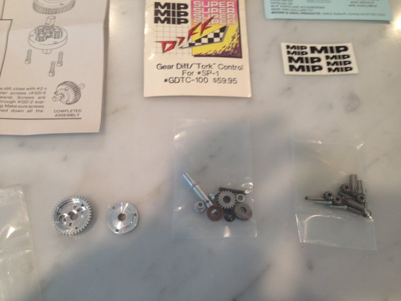

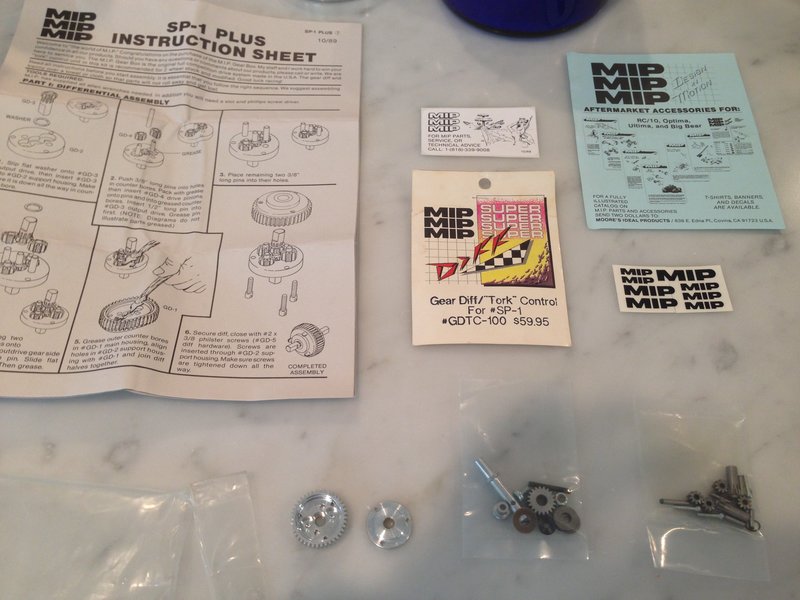

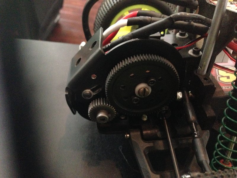

Picked up a MIP Gear Diff Set (thanks Phin!)...thinking about installing on this build. I would probably make this a brushless system so I guess the Torq control will have to stay in the bag since I assume it would not handle brushless 17t motor very well:)
I assume you would just drill the case for the torq control....if someone can confirm that would be good to know.

You will need to drill a hole through the side of the case for the torq control's adjustment screw.
I don't know how well the small planetary gears in the diff would hold up to a brushless motor. For running the car you may want to pick up a spare re-re Tamiya 84113 ball diff for a Sand Scorcher. You'll need to shorten the outdrive shafts but otherwise it's a drop in replacement.
If you want an additional slipper the A&L Power Clutch is available (http://vintageteamaandl.com/) or you can try to adapt a modern slipper clutch like I did awhile back. http://www.rc10talk.com/viewtopic.php?f=40&t=26414

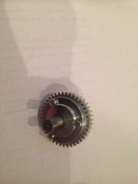

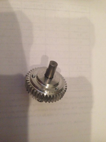

I had a chance to build the gear diff, but not sure if it is feeling right. I never owned one of these growing up, so I have no frame of reference....I guess I assumed it should be buttery smooth, but it seems to catch from time to time despite me re-building it a couple of times...anyone have any experience with this gear diff and what it should feel like? How do I know when it is right?
I was planning to use maybe modern 60K or 100K silicone diff fluid.
Phin - thanks for the heads up up on the A&L clutch...I have a plastic insert on my other MIP tranny's (I think it is also a sand scorcher fit) that just screws in directly - no spring, etc.
Again - any advice would be helpful.

There's some advice on that in this thread: http://www.rc10talk.com/viewtopic.php?f=1&t=4403Mwp1111 wrote:I had a chance to build the gear diff, but not sure if it is feeling right. I never owned one of these growing up, so I have no frame of reference....I guess I assumed it should be buttery smooth, but it seems to catch from time to time despite me re-building it a couple of times...anyone have any experience with this gear diff and what it should feel like? How do I know when it is right?
Ok...thanks to Phin for pointing me in the right direction...took the advice with the toothpaste and drill....wow...it worked!
I ran it on the drill for about ten minutes a side or so, cleaned it and re-lubed....buttery smooth now....
Thanks guys.
