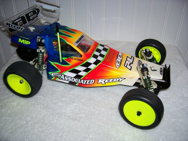

First time using liquid mask. Results are not to bad for a rookie . I just need more practice with the xacto knife and my shading skills still suck .

Looks better than any of mine! How did you find the liquid mask vs. tape?

How many coats of liquid mask did you use? I can't fade worth a crap, no patience, lol.

I sprayed on two coats using a touch up spray gun from harbor freight. Used a heat gun on the first coat and let the second coat dry overnight. My 101 class was a youtube video . My problem with fading I think is to much paint at one time. on the next body I'll adjust the paint flow down and give that a try.

Wow, you sprayed it on? I don't have anything that fancy, lol. Just brush mine one

Touche'. Any kind of free-hand paint-scheme is *much* easier to do with liquid mask than with tape. Tape has the edge with straight lines, though...but there's always bleed-through. I've had best tape results with that yellow Tamiya masking tape, it's very thin and sticks better than any other masking tape. That expensive blue 3M fine-line vinyl masking tape? Not so much. With that and any other cheaper masking tape, you'll spend more time scraping up bleed-through than the painting itself.rctenracer wrote:Liqiud mask is a lot easier to use than tape.

I'm terrible at fades, too--though that's all about airbrush technique, nothing to do with masking. My technique is that of a rookie.RC104ever wrote:How many coats of liquid mask did you use? I can't fade worth a crap, no patience, lol.
You need two or three good coats of liquid mask if brushed on--being careful not to brush it on too thick and pool in nooks & crannies, as it'll take forever to dry, and also not to have it too thin--which makes it rip & tear when trying to pull it off, which is a pain.
I airbrush it on with about 7 or 8 thin coats, and it uses about 2/3 or 1/2 the amount of liquid mask. I'll have to confirm but you have to thin it with water or Windex to the consistency of milk.

Yeah it does!!!integra22t wrote:a good clean duel action airbrush helps alot with fades
Nice clean lines with the liquid mask. I haven't used it myself, but maybe someday.

Also keep in mind with fades you don't want a high air pressure as it will create splatters. I usually drop my pressure lower when when I do fades and small details.
