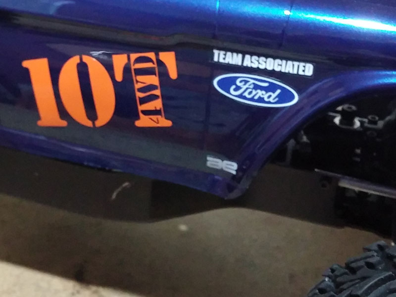

Teaser. Had to grab these from the phone real quick...build pics on Camera - left that at my folks...Grrrr.
Turning out real nice...super happy with it. :)
Still not done though waiting on a few parts...but the body is done! Muhahaha! lol
