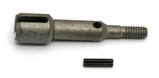

Not a problem! Question, is your 10t still equipped with the early thicker axles that taper down to the thread? Or the later thinner axle?
You will find more wheel options with the later thin axle then the early one.

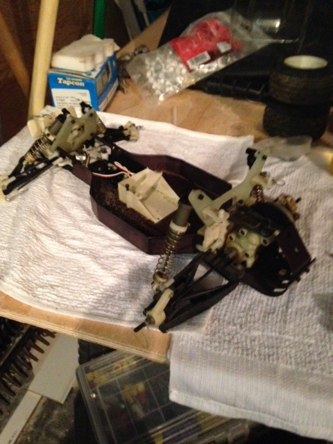

sorry for the blurry picture…I'm still getting the hang of this picture posting. It looks like it's the older tapered version. and yes i have dog bones so being that my spacers are a little banged up I should look to get the newer version of axels and the washer/spacer kit I see on tower hobby website.
