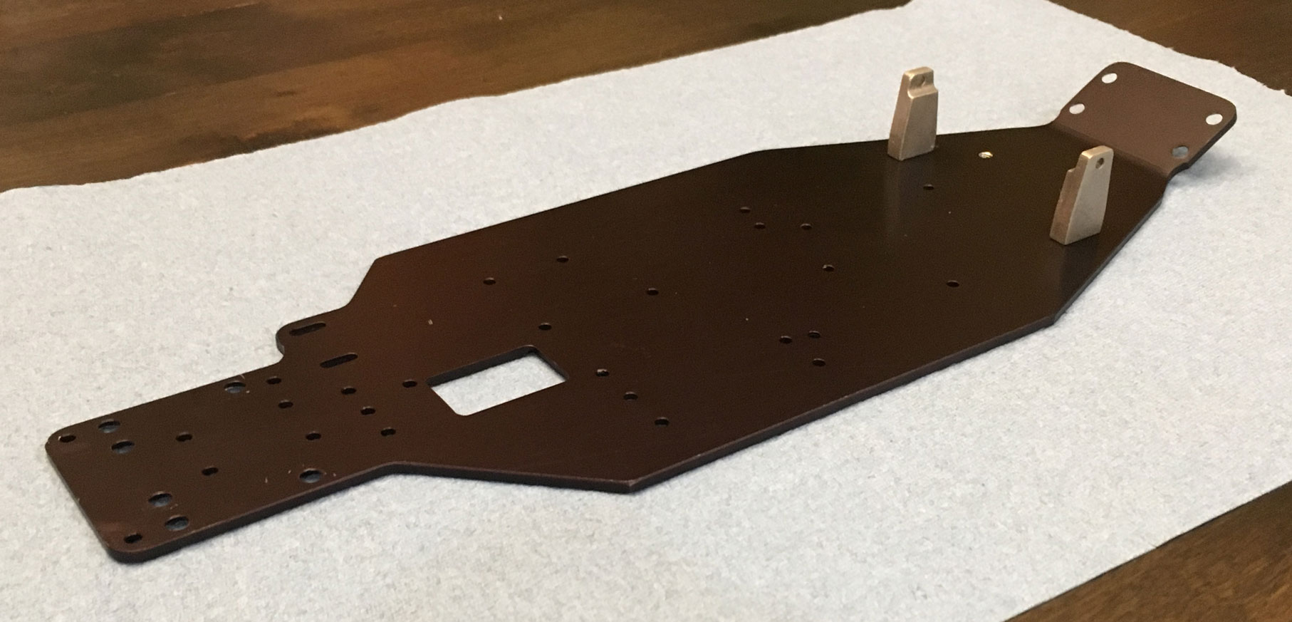

Holeshot Racing Chassis
What really distinguishes it from other available RC10GT chassis is the fact that it's completely flat - so there won't need to be any compromises made when laying out the battery and electronics. The other thing that's really nice is just how thick it is. From reading about other experiences with taking the GT electric, I know that one of the things that must go is the engine mount - which also served as a chassis brace. Having that additional thickness should mitigate flex issues. This is the only reference to it I can find online.
