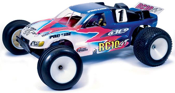

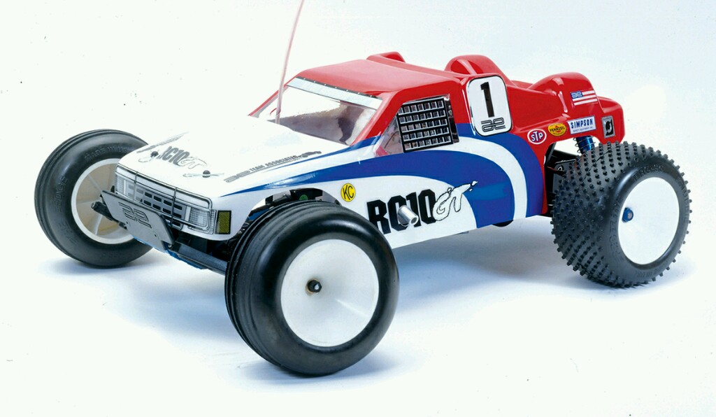

Hello, i recently have gotten back into rc after being away since roughly 96.
I always had rc10s, 10ts, but always wanted a gt.
I aquired a few rc10gts and im trying to figure out roughly the era of them.
They have a blue flat chassis, as best i can figure after reading up, one is a ft model, it has anodized shocks, graphite shock towers, blue hardware, mip cvds, titanium turnbuckles, etc.
The other chassis is the same, but it had blue shocks instead, and blue aluminum turnbuckles.
I remember i think in 93ish when the gt came out, its chassis was like my 10t, black aluminum tub.
So when did this blue flat chassis come out?
Ive also noticed that it seems bodies are not available for these? Has anyone grafted a different model body to it with luck?
One more thing, my turnbuckle ends on both are like an upgraded version, instead of a typical ball end, these have a spherical end, and a bolt going thru them.
Are those ends still around, and if so, where can i buy those?
Thanks for the help.

the flat blue chassis is about 2000.
one sounds like a FT
the other with blue shocks sounds like a RTR. (chassis might be different lengths also)
