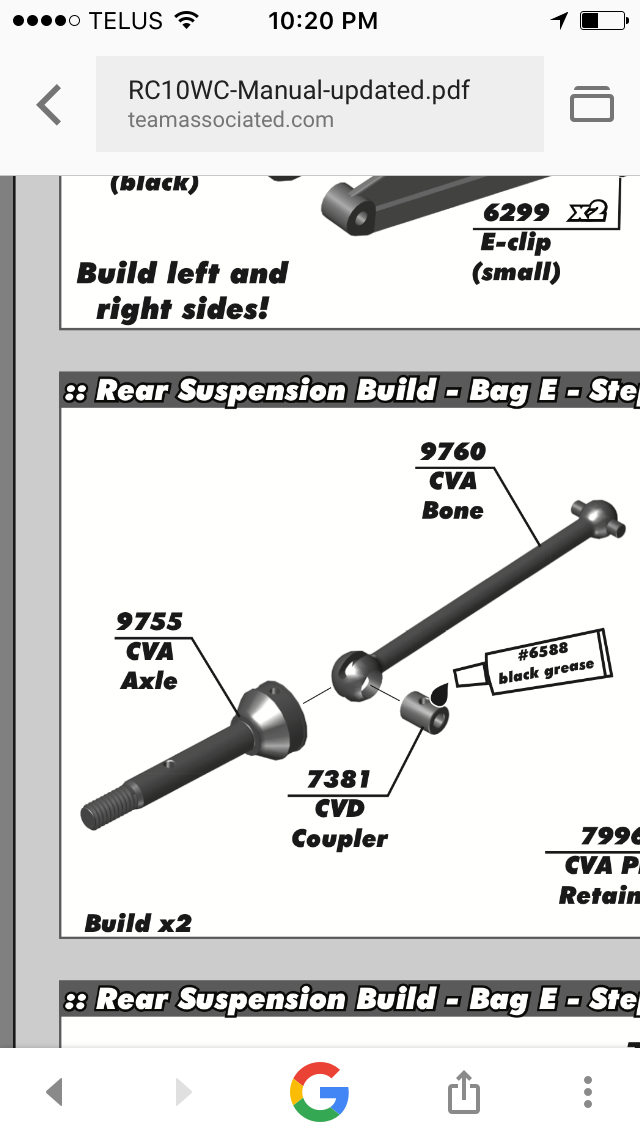

So in an attempt to modernize my Rc10 I converted the backend to worlds car hubs and CVAs. The problem is I need to have extreme negative camber in order to prevent the dog bones from falling out of the transmission (3 gear). So I suspect that the rear arms of the worlds car are shorter which would allow the dog bones to sit deeper into the transmission, but I'm not sure. Anyone have any experience with this? Any tips would be appreciated. See pics. Thx!

No, all the arms are the same length. AE screwed up and used too short of CVA bones in the Worlds rere. To remedy it you can severely limit droop, or move the spacers and shims, including the blue one, to the onboard side to move the stub axle inward.

Thanks for the response I did put 2 washers on the onboard side but still need a ton of camber to prevent the dog bones from popping out of the transmission.
Another possible option at my local hobby shop. It's the b-4 mip cvd set. (AE part 9599). I measured it and it's a good 5mm longer. So I think if I shim and washer the wheel pin side I think it it might work. Not sure if anyone has tried this?

If you have that blue anodized cone-shaped washer that comes with the Worlds CVA conversion kit put that inboard and maybe like 2 of the 3 thin washers, then put the 3rd outboard. Annoying that you have to do this, but works like a charm.
I need to make those extended length outdrives to solve this issue.
