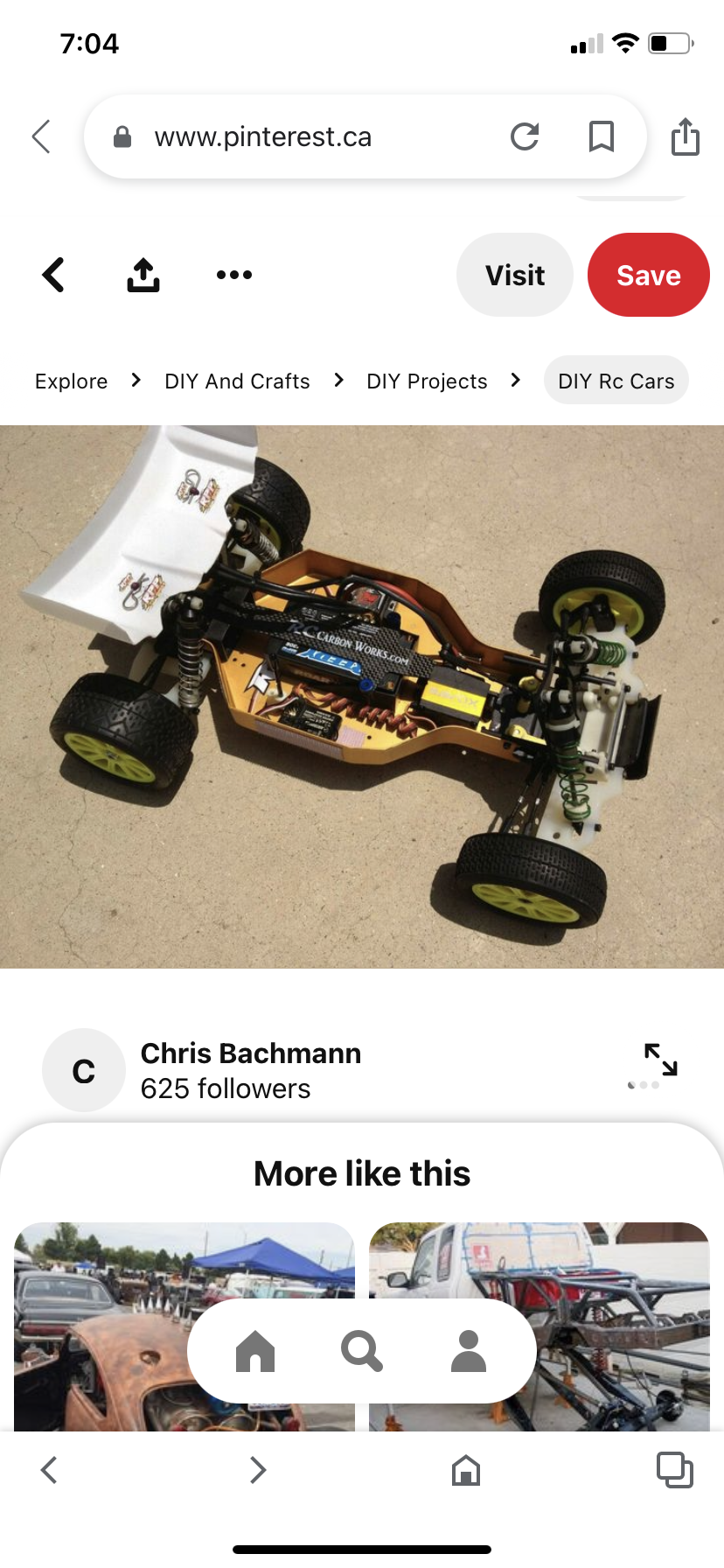

Been fiddling with rear wheel base for a while but still not satisfied. Found this pic online which may be a solution. I think they installed B4 rear arms/hubs maybe? Any help would be appreciated. Part numbers would be wonderful from the cva bones out to the rims.
Thx!!

Re: Modernized Goldpan, narrow rear wheel base
Those are Klein rear arms on that car, similar to the RPM Worlds arms. They are longer than standard RC10 arms. Depending on how you mount them, the axle can be positioned in the factory location or extended out.
Do some searching on WOIN (whats old is new) cars around here, you will find plenty of options.

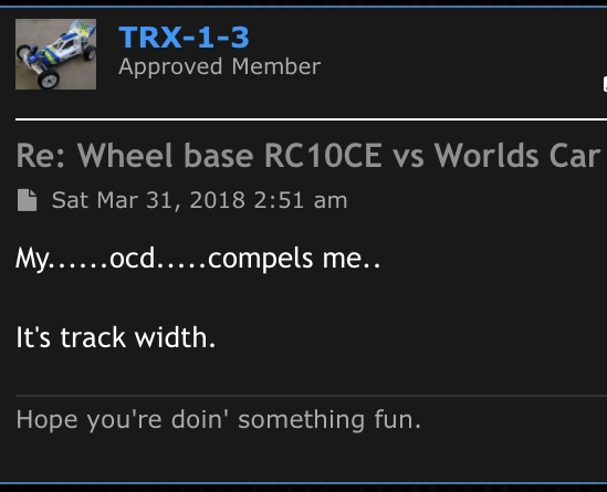

Post by TRX-1-3 »

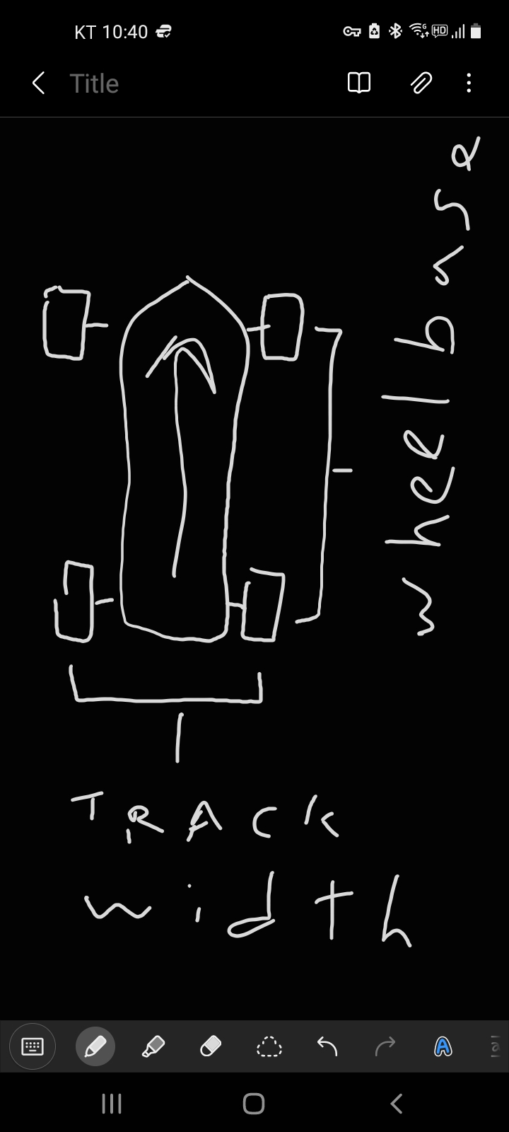

BACK_AT_IT
Posts: 32
Joined: Sat Oct 03, 2015 12:36 am
Location: Calgary, Canada
Post by BACK_AT_IT »
Thanks, I appreciate the correction and love the sketch!
