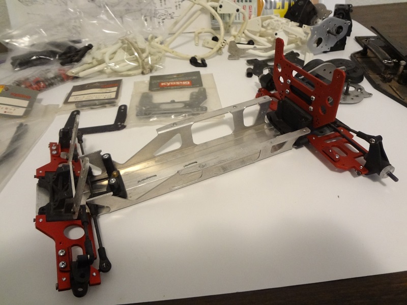

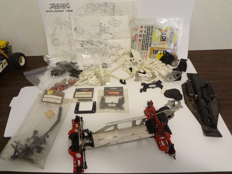

I've been collecting parts and trying to come up with a plan or a theme or something to get this build started for a while. With Sandkil recently starting his Sideways resto, I was inspired more than ever, and with the recent acquisition of a decent chassis, I'm finally getting this build off the ground. I have been hoarding a few Ultima/Ultima II/Sideways parts in preparation. I also have a set of front wide see's aluminum rims(no matching rears yet) and a complete set of sideways wheels and tires that havn't arrived in the mail yet. I'm going to start with a basic fitment of parts and then tear the car apart and do a final cleaning, painting, etc. before final assembly. I'm starting with an original ultima chassis fitted with Hot Trick front and rear arms and rear shock tower. I have a plan for the shocks which is to use a set of original optima 10mm shocks fitted with associated spring cups, traxxas ball joints and crp shock spring collars. I'm probably going to remove all red anodizing from all the parts and go with a satin or polished finish. I sort of have a blue/orange/white color scheme in my head and all the red anodized aluminum won't do. I still have to purchase a couple things, like a screw set, possibly the stainless set from RC Screws. The funniest part is, I don't know if I'm building an Ultima or a Sideways yet. I can't seem to make up my mind so I'm just going to dive in and I'll figure it out when I get that far.

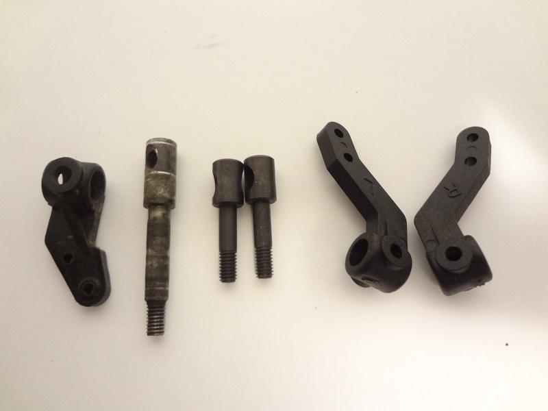

First problem was quick to show itself. In this pic, from the left, you will see the knuckle arms that I had (that came off of an Ultima 2/outlaw) and the axle that was on it. One of the Knuckles was cracked and the the long axles were not correct for what I'm trying to build so I ordered the knuckles and axles that are next to them. The axles are "UM8" and I'm pretty confident they are correct. The knuckles are "UM103" and are not correct. After a little research, I guess that any Ultima UM part 100 or higher is for the later model Ultima ST/RB? The hole that the axle goes in is too small and I havn't even got to any possible clearance or steering angle issues with those longer arms on the knuckles. I might try drilling the axle holes out and trying them. Does anyone know the correct kyosho part # for the knuckles? They are listed as part #32,33 on the parts list in the original manual but I could not find the "UM #" which is the replacement pack with right and left knuckles.

UM-11 are original.
UM-49 fit. They have an extra hole used for the onroad cars

Thanks. I'm going to search around for a set of those and do some experimenting with these ones I have. It's hard to believe that such a common part for such a popular car is so hard to find. I've never had a hard time finding parts for my RC10's. At least not the stock pieces.

Now I see my problem- I was searching "knuckle arms" and not "upright set". Thanks again GoMachV. Got a set of the right ones headed my way.

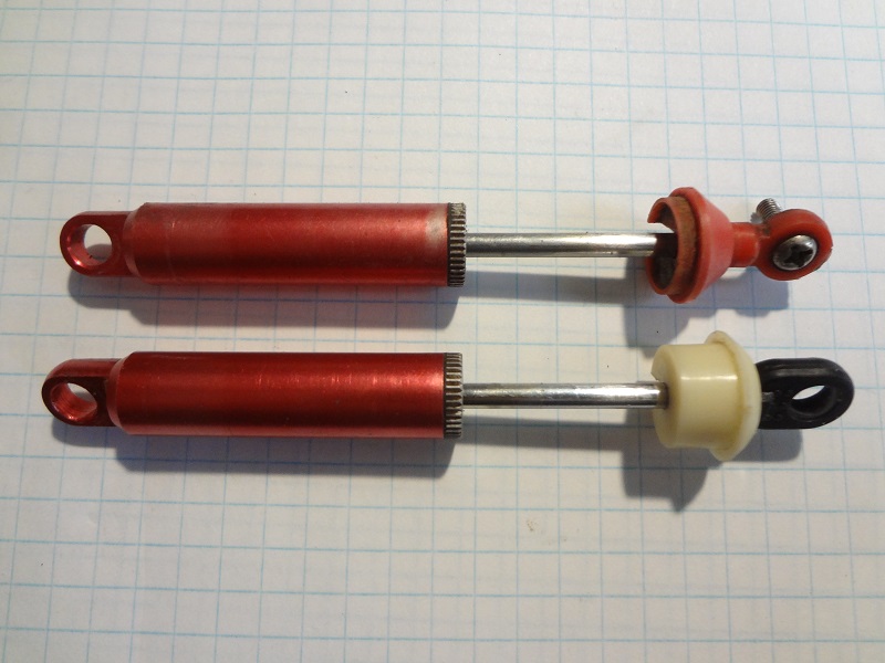

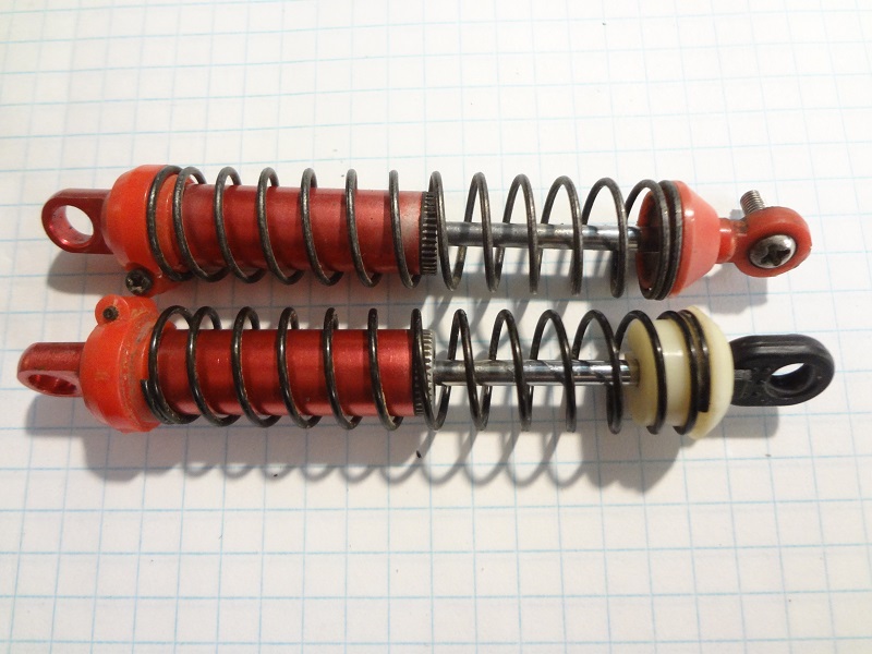

So I'm sure a few of you were thinking when I described what I was doing for shocks so I thought I'd show you. As I said before, I'm not planning on having any red parts on the car when I'm done, so it didn't make sense to me to try to source original red replacement ends and spring cups and then experiment with trying to dye them black. The black end is a heavy duty short rod end for a traxxas jato and the spring cup is a common rc10 piece. It all fits together like it was made to be. the original kyosho balls even fit perfectly into the traxxas ends. After I remove the red anodizing from the shock body, Dye the spring cups black (or dig around in my junkyard for some black ones), I will rebuild them using some old CRP rebuild kits I've been hoarding and top them off with some CRP shock collars. I'll keep you posted with some pics as I make progress.

Yup, those are Ultima ST/RB parts. Note that you can't use the Ultima ST/RB axles either, because those are not for metric wheels but for US competition buggy wheels.Basher67 wrote: ↑Wed Jul 05, 2017 9:07 pm The knuckles are "UM103" and are not correct. After a little research, I guess that any Ultima UM part 100 or higher is for the later model Ultima ST/RB? The hole that the axle goes in is too small and I havn't even got to any possible clearance or steering angle issues with those longer arms on the knuckles.

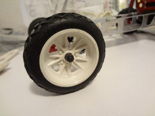

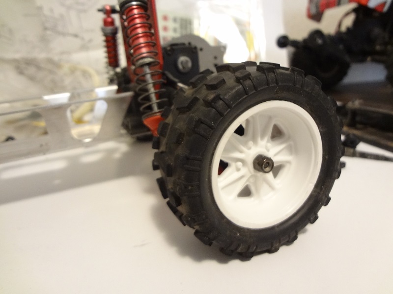

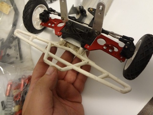

Ok. I've got an update. I've decided that the only way to get what I want is to build 2 cars. So the sideways project is getting put to the side for the moment and this one is going to be an Ultima buggy. Lonestar, you may have me convinced on the red for this one. I'm keeping it for now and we'll see how the final outcome looks before cleaning and final assembly. I got the correct knuckles and axles installed. Installed some turnbuckles. I also came across these wheels in my junkyard. They are off of a Kyosho Cosmo. They cleaned up pretty nice and I have to say, I'm really diggin' them. Threw some proline diamond treads on the front just to see what they'd look like. The rear tires are the original cosmo tires. Not sure if I'm in love with that tread or not. The white bumper from the front of the Cosmo looks like it would bolt up. Might look cool if trimmed down to a different shape. Not sure on that one yet. Anyway, here's a couple pics. Let me know what you think
