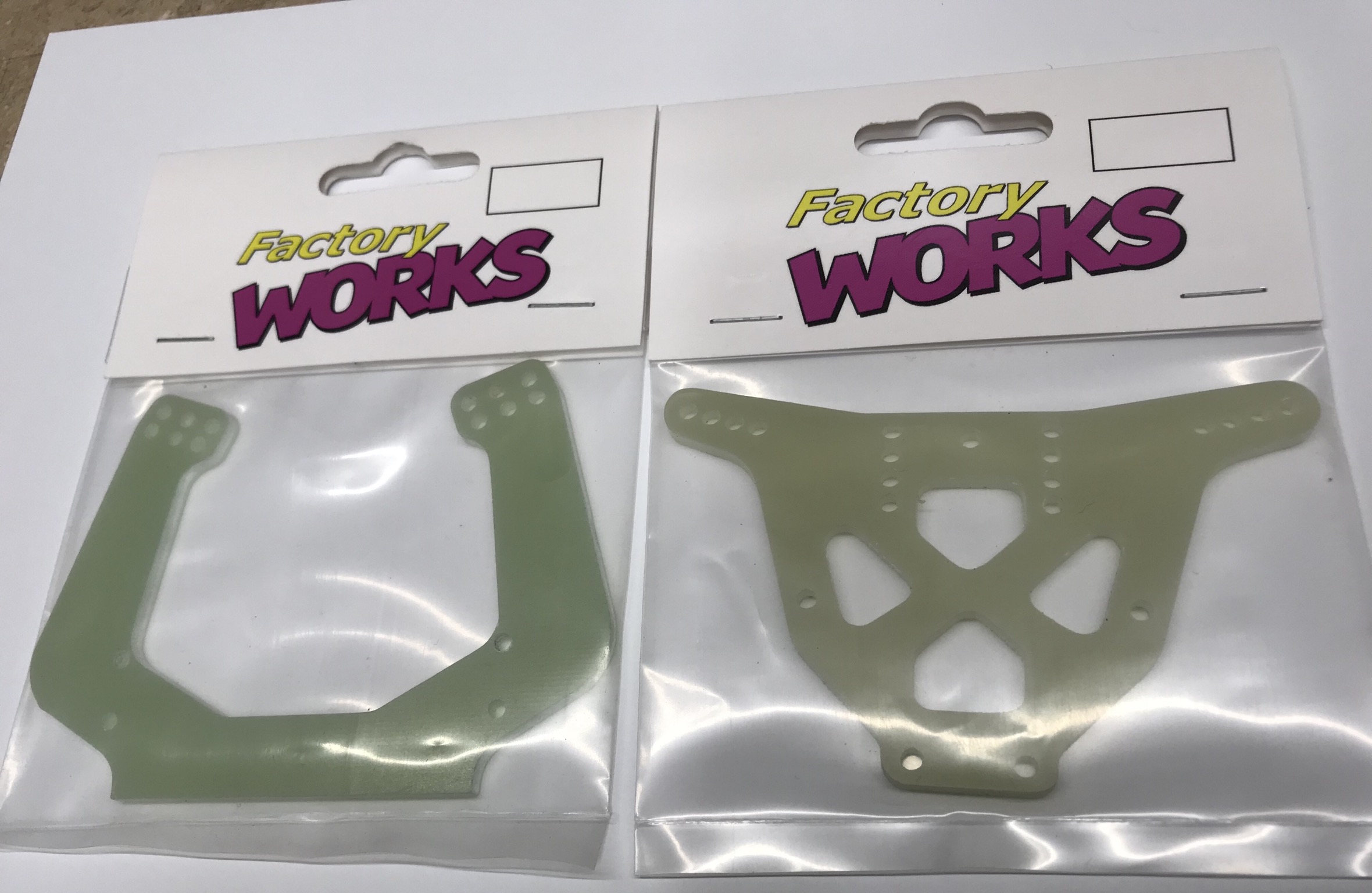

I have some compatible towers for the rear, front is standard buggy although a lot of people like the longer B2 shocks

Re: Buddgy from T2 chasis someone direct me toward a thread ?
Not mine, just a customers. Scr8p has some really nice builds on here.

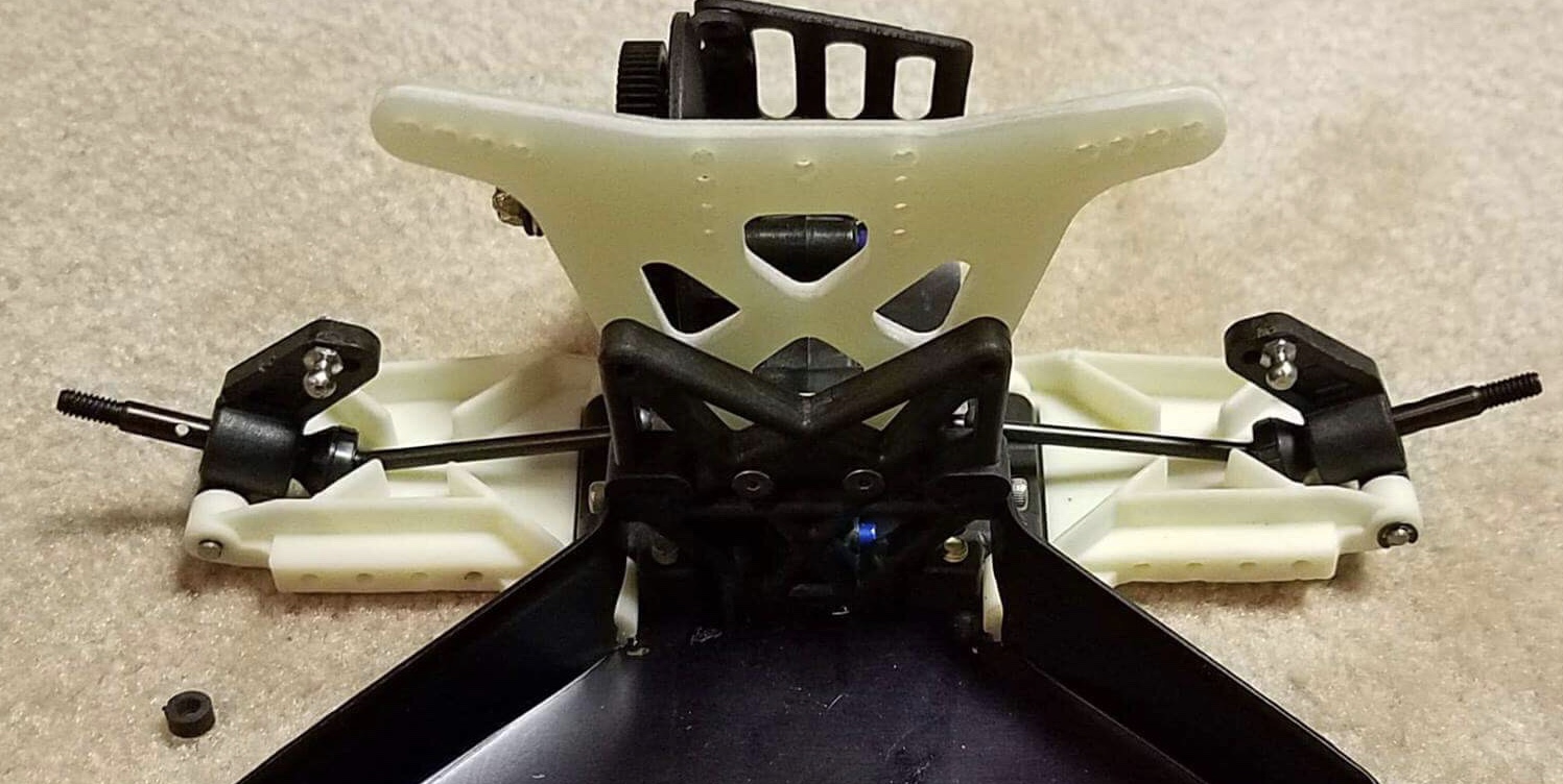

Well whoever that customer is, that is a realllllllly nice car! And I'm sure his other cars are nice too, but I'm just guessing.

Thanks guys
This is exactly what I needed. Cheers

I was going to see how far I could go before Jeff noticed, but I sent him a message and gave up the secret! I have been a little more active here lately, but my user name probably isn't that familiar.
As far as towers, Jeff is the guy to talk to. For bodies, I was just talking to Jason on this, and it sounds like the viper is one of the best options, since most bodies don't fit well over this chassis. I tried a viper myself, and its not perfect, but better than any others I tried. If you flip the car over, you can try out various bodies for fitment over the chassis without worrying about how the shock towers line up.
