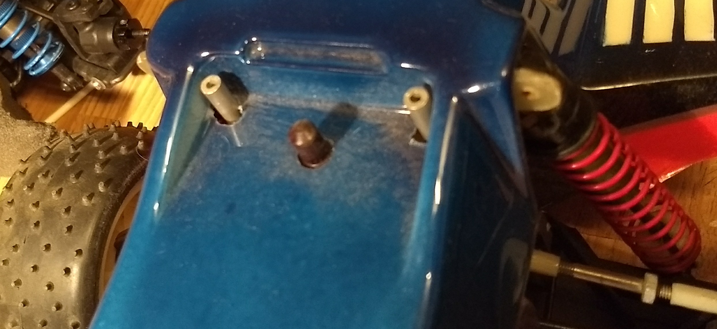

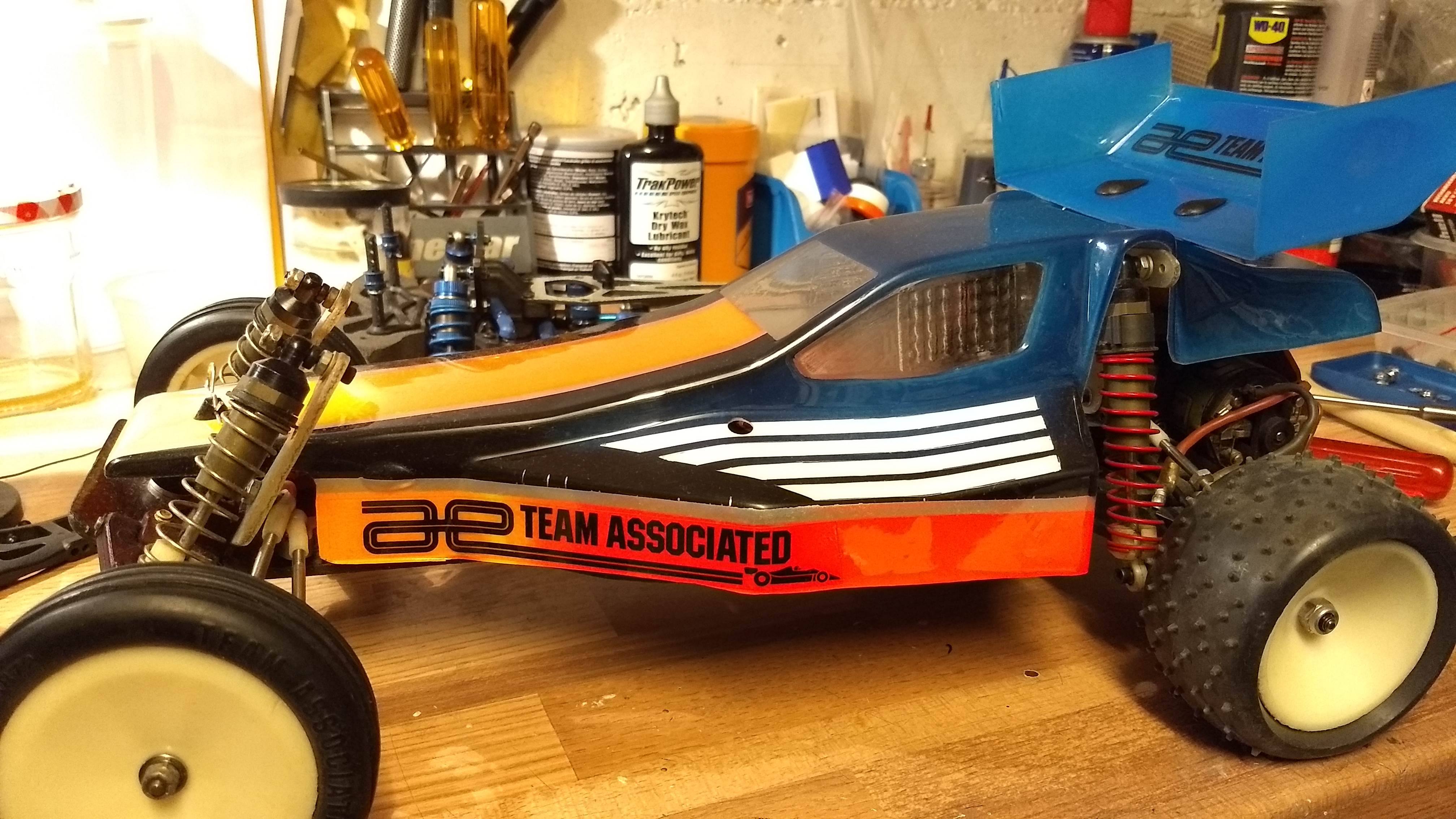

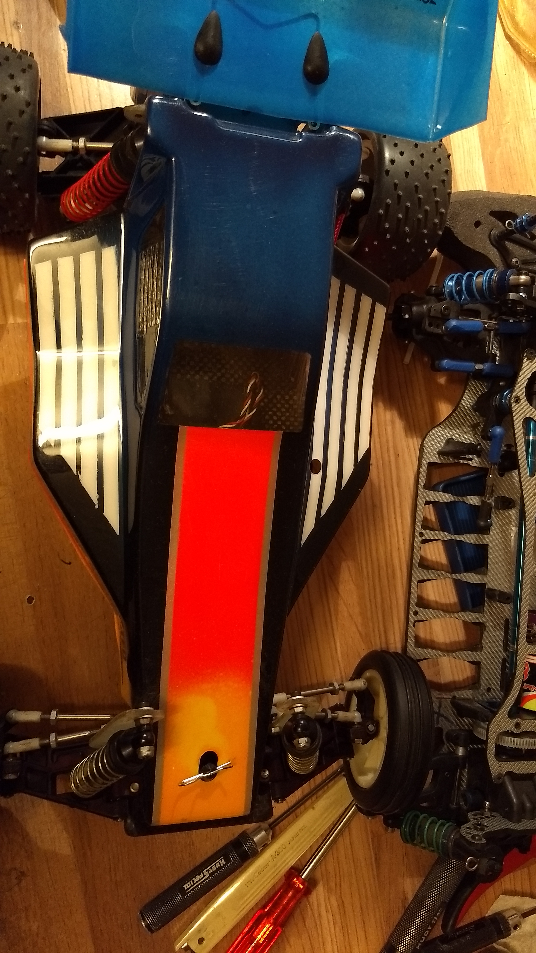

Re: Team Car body hole locations
this...
I'll take a pic of a well-positioned Viper in a short while
Watchout as the repop bodies sometimes are of a slightly different size... your best bet is to "ovalize" the front mounting hole, which is needed because of the angled post anyway.
Yeah I was aware of the need to tweak the front hole a bit. But I'm thinking the rear is most important as getting that right will dictate where the front will sit.
A pic would be much appreciated
- Lonestar
- Posts: 4270
- Has thanked: 623 times
- Been thanked: 171 times
- Lonestar
- Posts: 4270
Sorry for the dust !!!
Thanks for that. Confirms what I thought and what has been said earlier.
Looks like the wing tube holes are 6 or 7mm, with the rear post hole being around 8mm?
