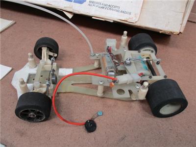

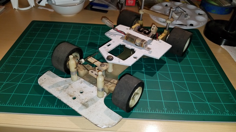

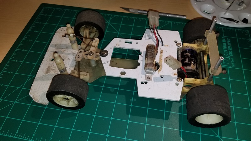

After a long stint away from the rc car hobby, I got the itch to relive a little of my past, and so I started looking an RC12e as it was the first race car that I had back in 1983, and was what started the rc racing bug for me. While digging around on epay, I found a a couple of cars, one 12e and a 12i. Of course I had to have them both, so I jumped on them and here we are. I hoping to do a complete period correct restoration on both cars, but we'll see what happens. So far I've found several new parts for them including wheels and donuts, so I should be good there. Cool thing is both cars came with original build instructions. As you can see, I've already stripped down the 12i and have the parts soaking in peroxide.

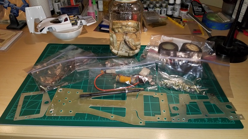

Thanks guys. Things are progressing right along. Both cars are stripped down and all nylon parts are getting a peroxide bath. They've only been soaking a few days but the change so far has been dramatic. I also spent some time on the chassis, giving the a light sanding to remove some of the scapes and polish them up a bit. My goal is not to over restore the cars, but to make them good clean examples of their type.

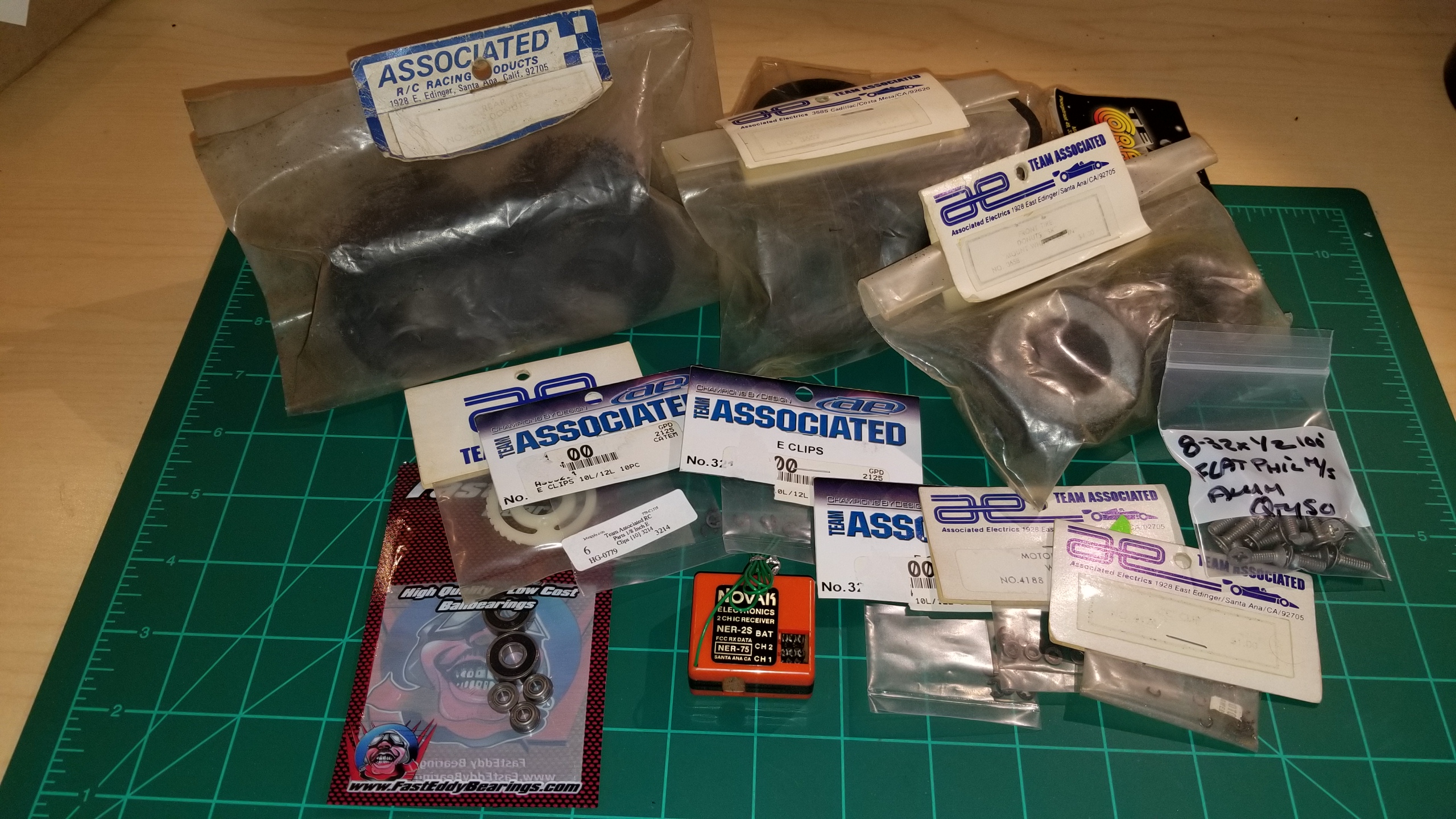

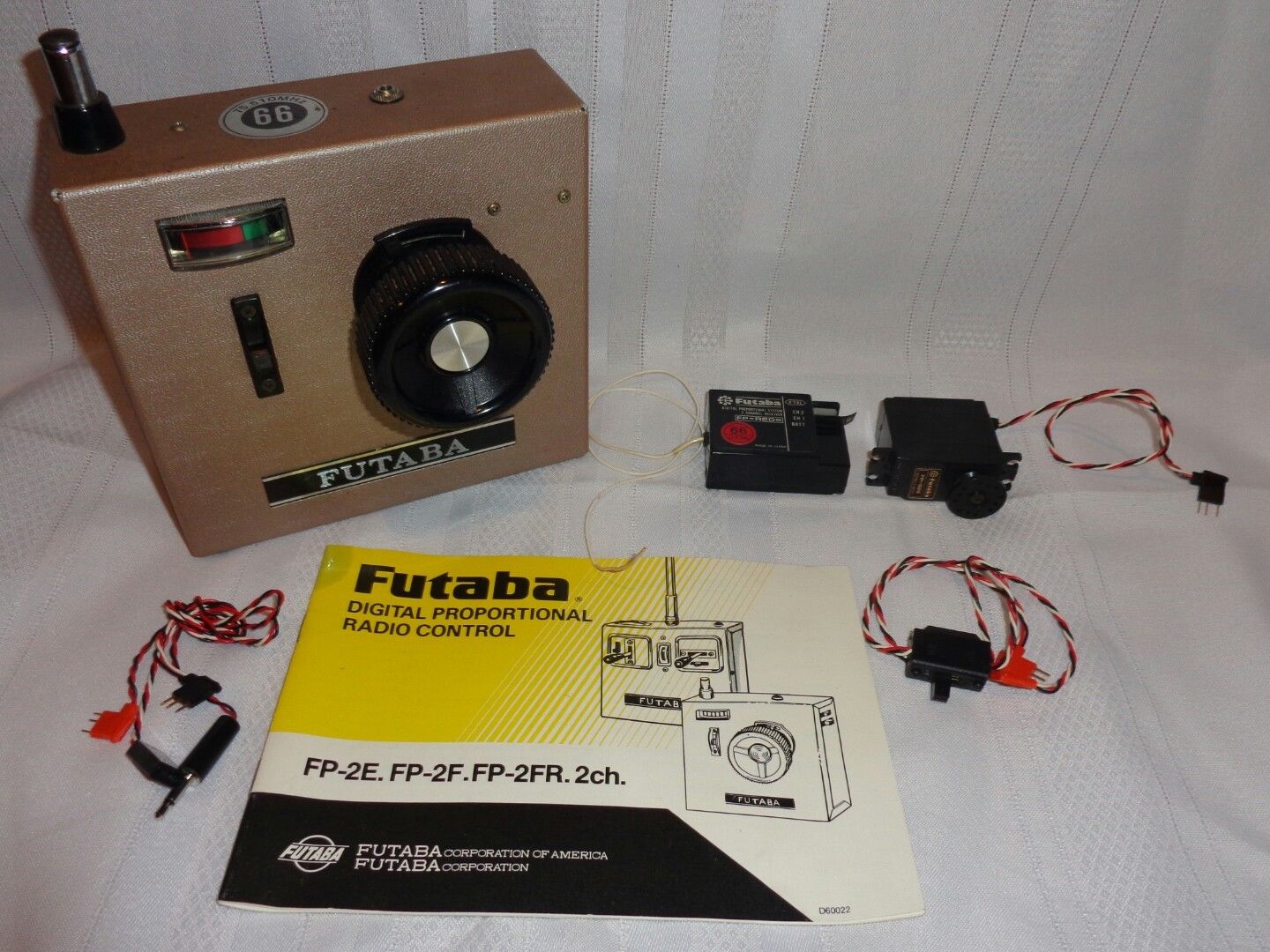

Parts are also starting to come in. I've scored some NOS Associated donuts for both cars, as well as an assortment of other small misc NOS parts. I also scored this vintage Futaba radio. I'll get more pics up tomorrow.

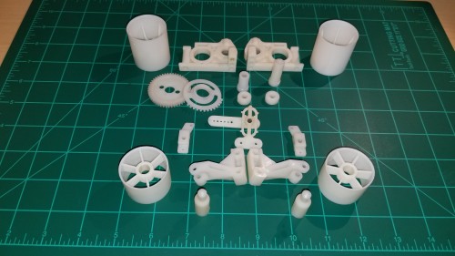

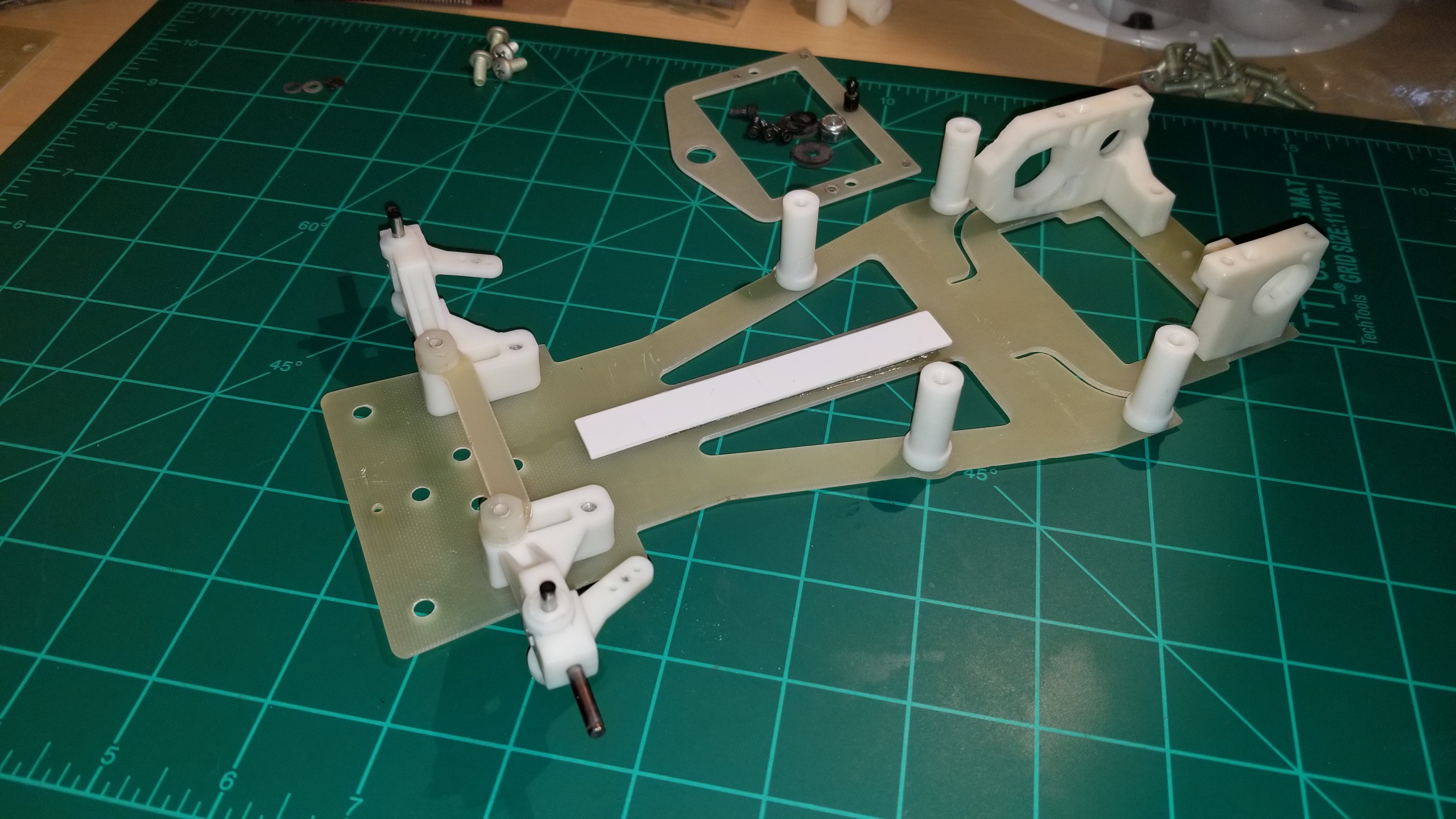

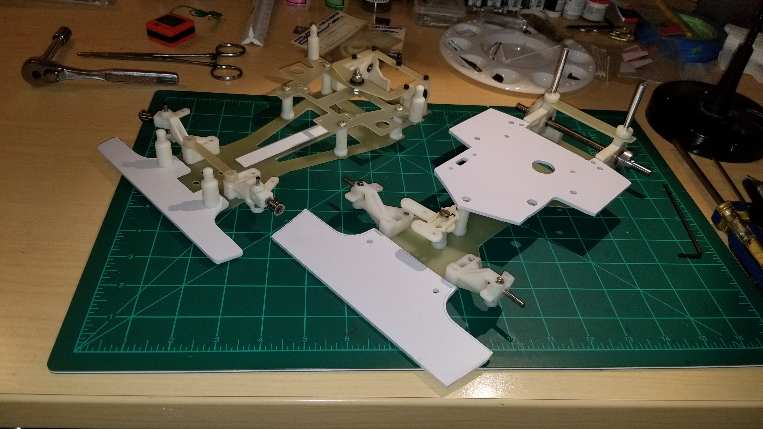

Ok guys, here's an overdue update.

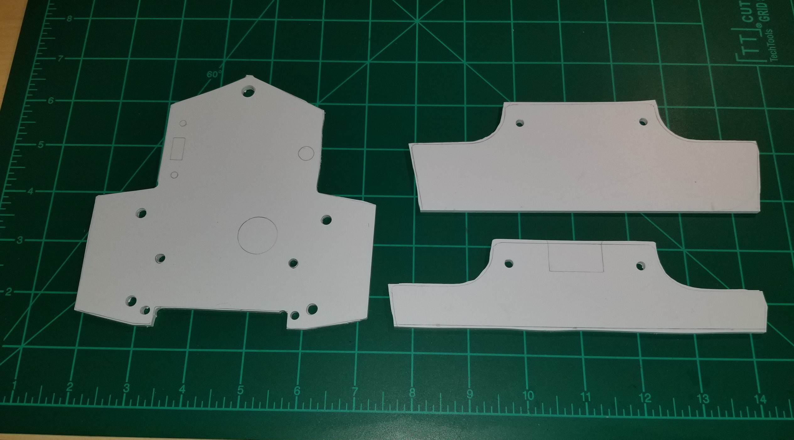

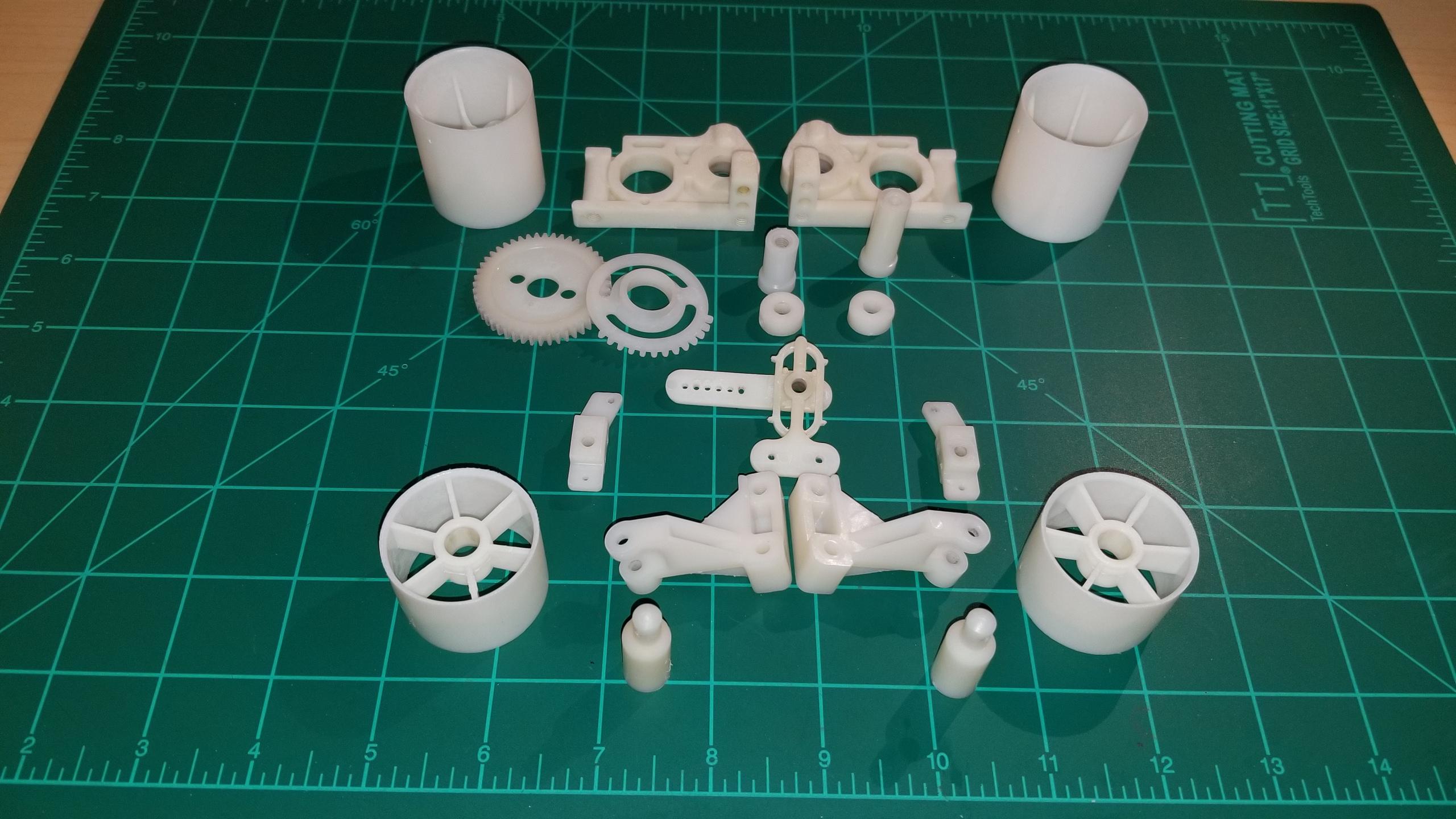

Parts have been removed from the peroxide bath and have been rinsed thoroughly. BTW, I let the parts soak for about 10 days total and I would pull them out and use an old toothbrush to clean the stubborn areas. I would also change the peroxide every four days, seemed to work well as the results are outstanding. Here is a pic of the 12 parts. While the parts were soaking I was gathering some of the small parts that I needed to bring these classics back to life. Between eBay and a few other sources I managed to gather up several Associated NOS parts including some of very elusive factory donuts. I still have more parts on the way, but here are a few. I also sourced some high impact polystyrene that makes a great substitute for the factory stuff. Same thickness, same flex and weight, just not shiney, but that can be fixed with some plastic polish. With my sheet of polystyrene in hand, Inset about making replacement bumpers for the cars and a new radio tray for the 12e. Here is a pic of the rough cut parts. Still have some cutting and drilling to do, but you get the point. I have also spent a little time polishing up some parts, again, I'm not going for show, but for a good clean look. And finally a little reassembly progress. Still haven't final sanded the replacement 12e parts so this is just a mock-up, but the bumper on the 12i is finished. I haven't decided if I'm going to polish the plastic or not. And another. Still figuring out the electronics, but I am going with a Novak receiver and speed control for the 12i. Just need to find an appropriate steering servo. I've also decided to use the resistor on 12e, but unsure about servo models. I know I want Futaba, but unsure of which ones....suggestions are welcomed here.

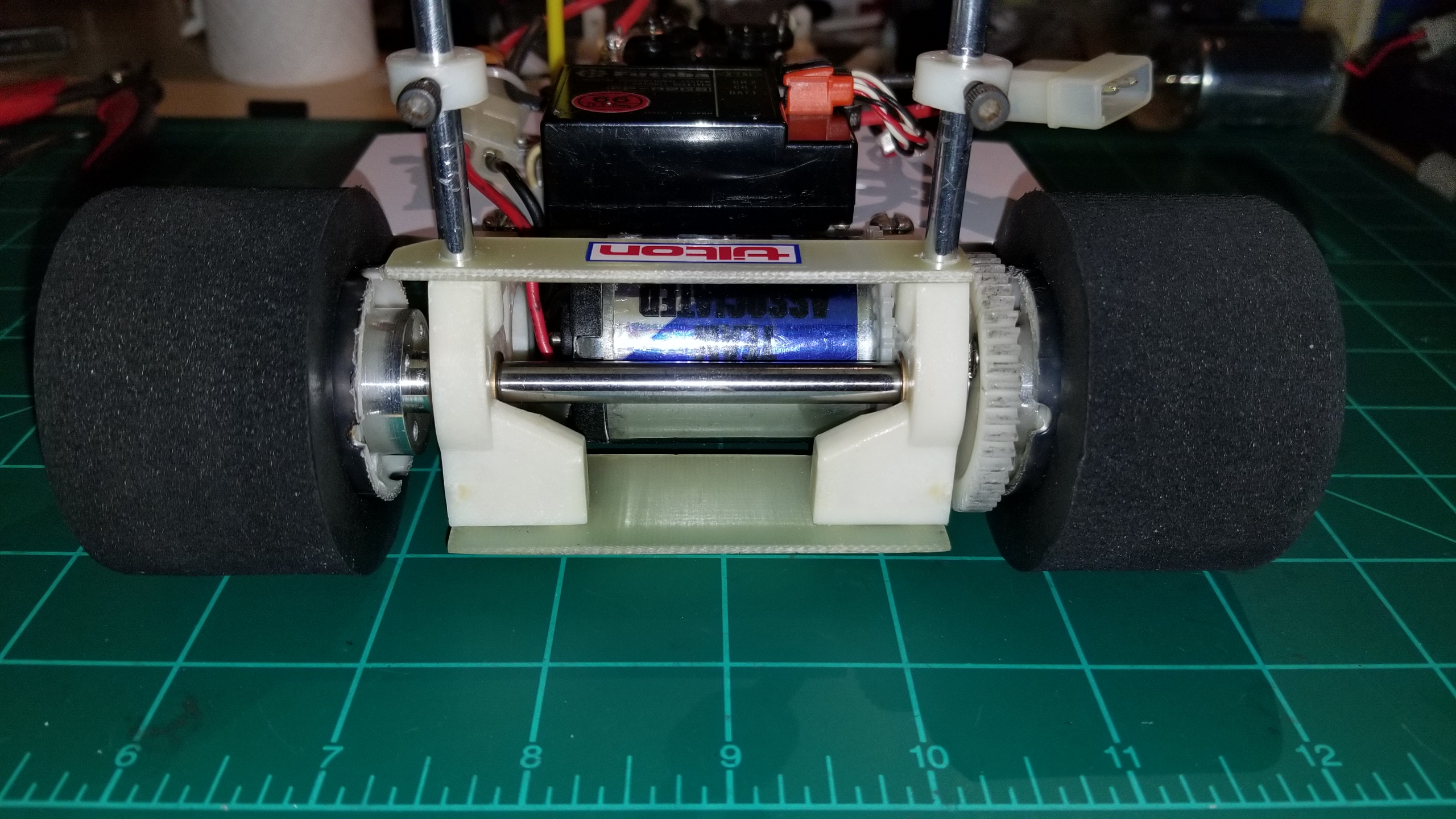

Re: A couple of new projects

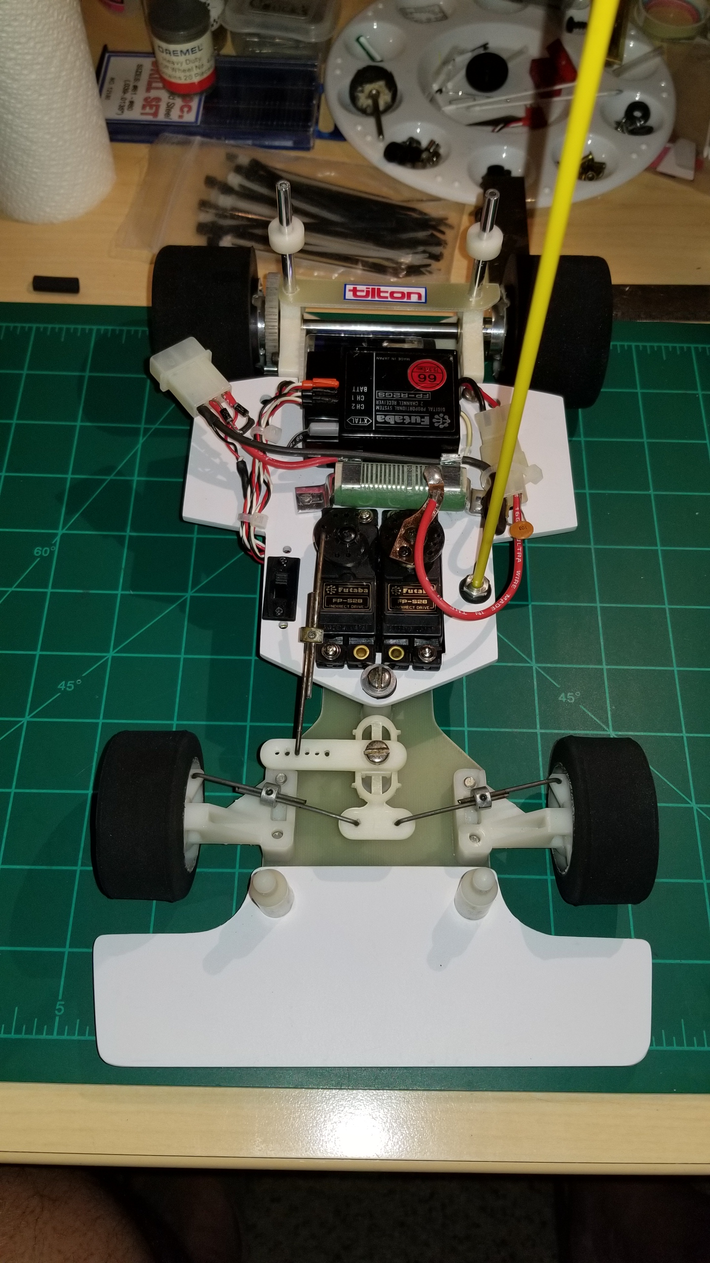

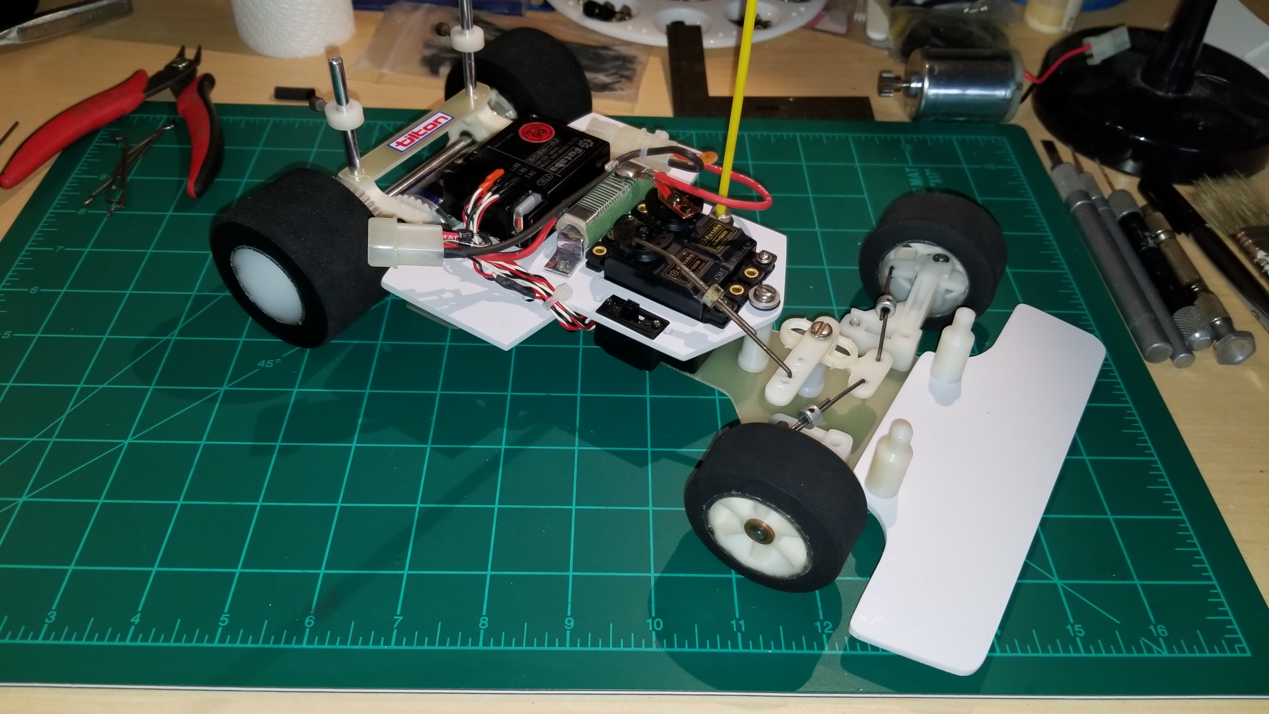

Well, the 12e is coming right along. Everything cleaned up and refitted. All electronics tested, motor cleaned and bushings lubed up and running good. Ignore the steering linkages, they are temporary until I can get some new music wire. Still need to glue and true the tires, fit and paint the TOJ body and few other little tidy up items.

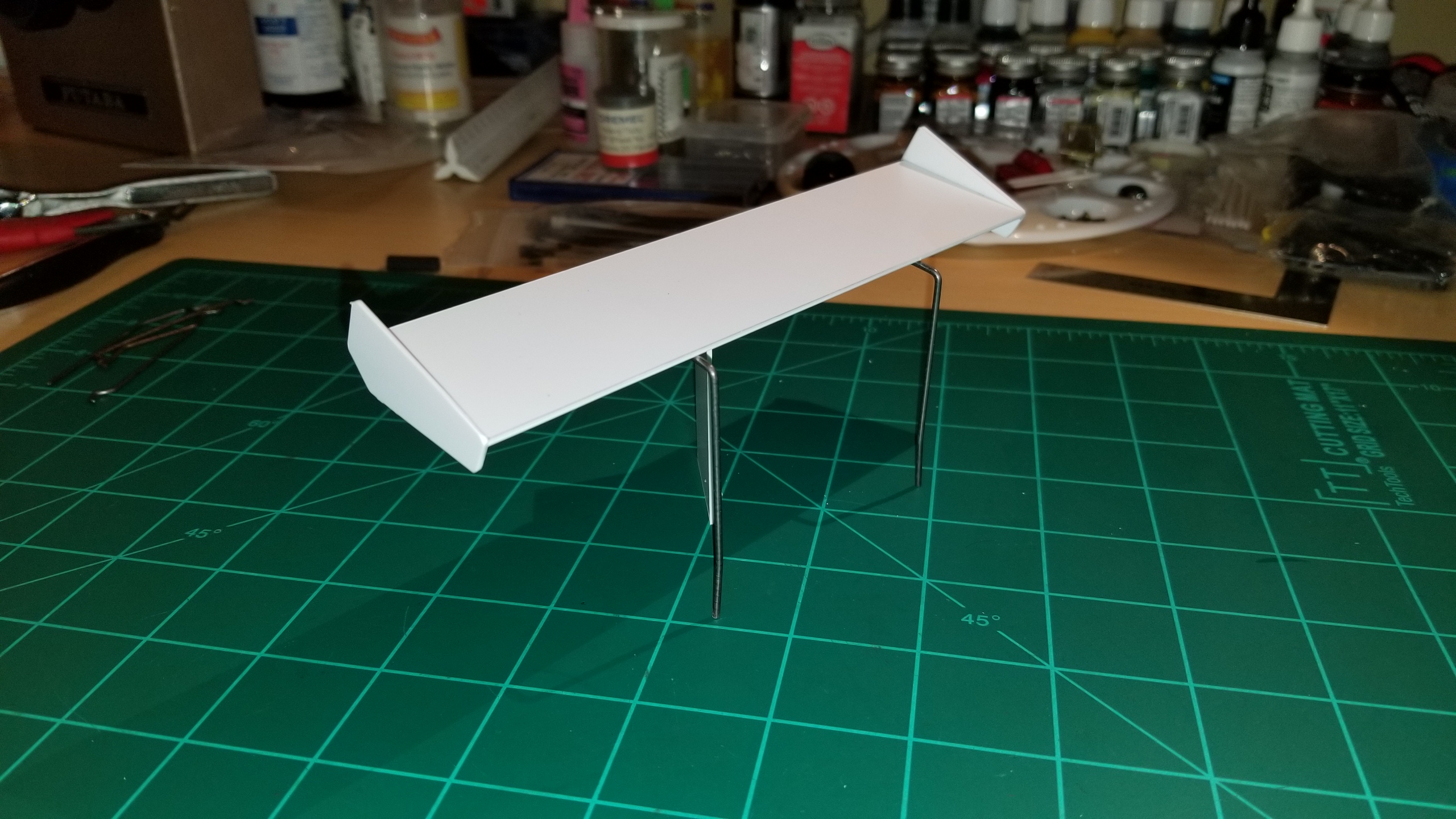

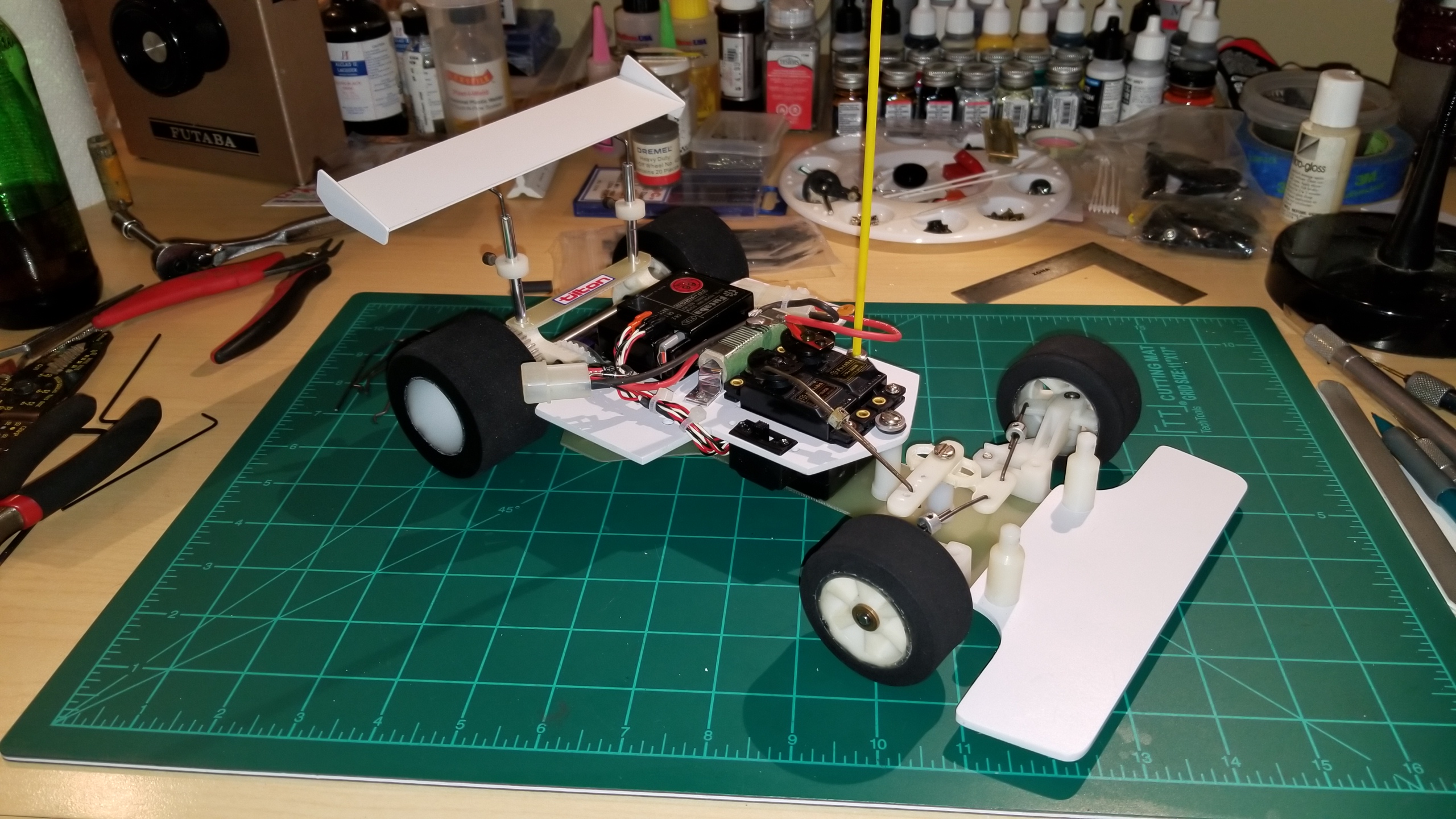

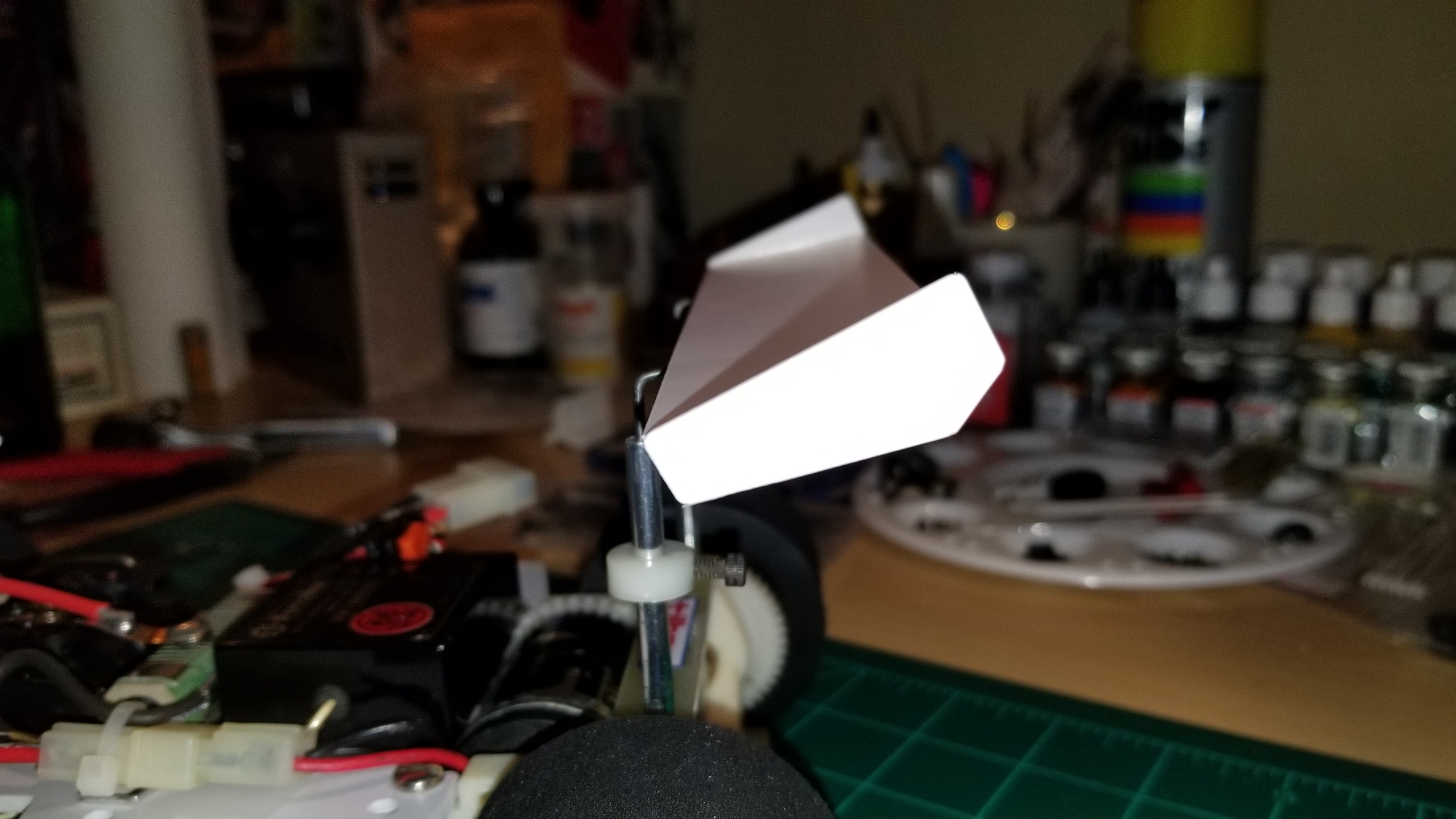

Had a few minutes to myself last night so I thought I would make a wing for the 12e. So, a little styrene and about 10 minutes later we had this. Not sure if I'll keep it or not, just playing with ideas.

Very nice work Chuck. Although I'd basically disregarded using styrene in the past for various reasons, I've recently discovered that it's actually a great material to use with RC. It's easy to work (shape, cut, glue, paint, etc.), it's readily available online or in crafts stores in a wide range of shapes and thicknesses and it's actually very durable. I've used it to finish the engine bay (body mounts, inner fenders, etc.) of an SCX10/Jeep conversion and I'm building a TF2/Blazer and using styrene to build a detailed interior, engine bay and even the faux motor itself. I've also used it to build a gear cover for my Pro SC 4x4. It's great stuff.

Thanks xlr8, this car will never be run in anger but only occasionally driven for fun, so I'm not worried about the wing breaking. This is just a mock up anyway, just wanted to see what it might look like.
I love styreen for modeling. Like you, I've discovered I can build most anything with it and it's really pretty durable. I like to use plasiweld to assemble it, it makes a stronger joint than CA.

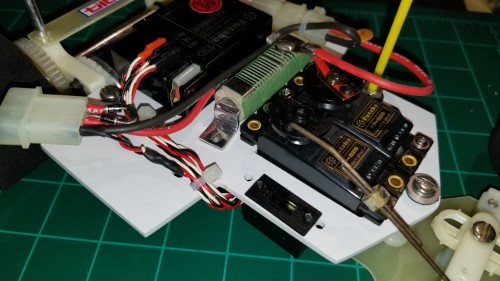

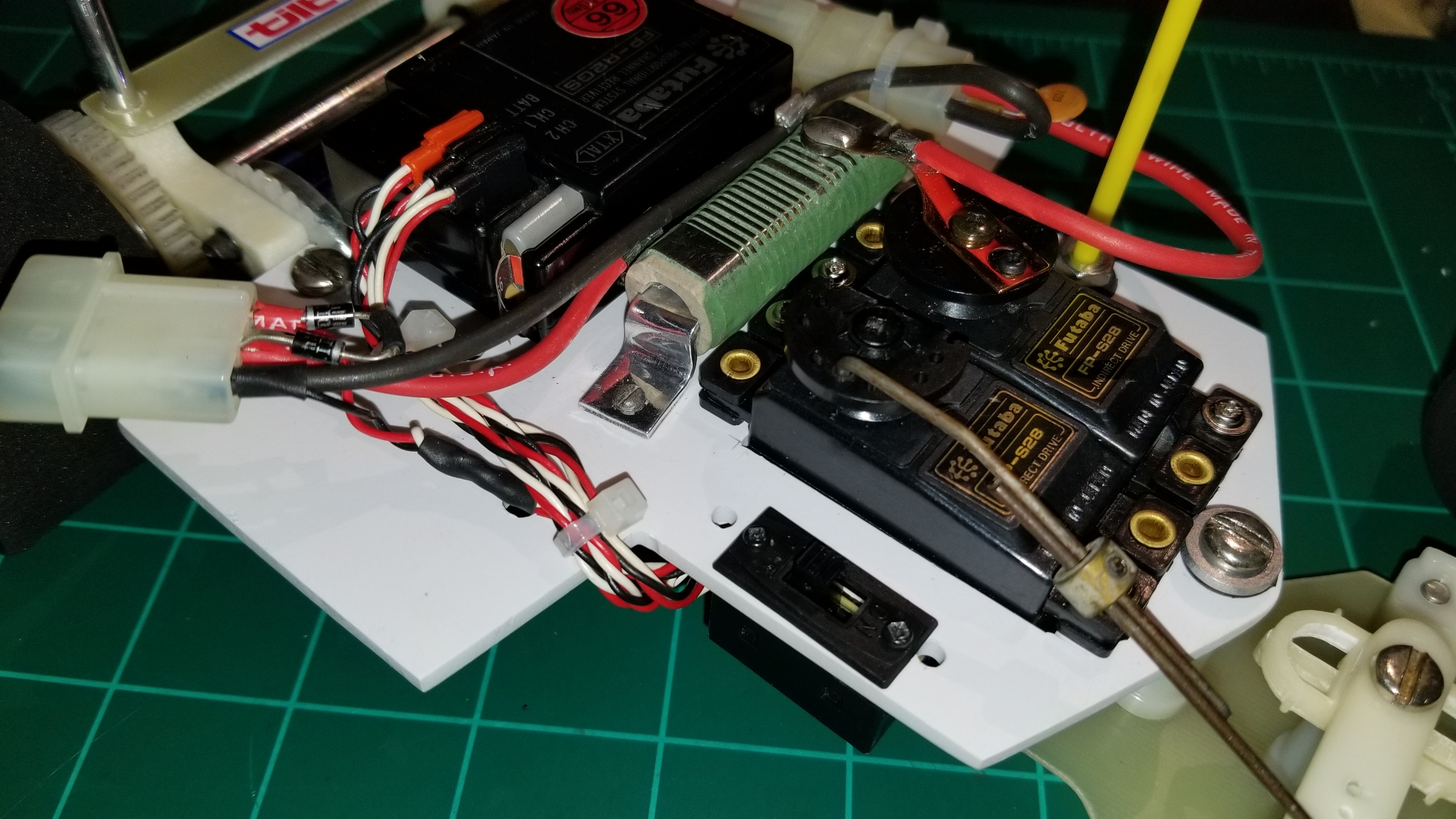

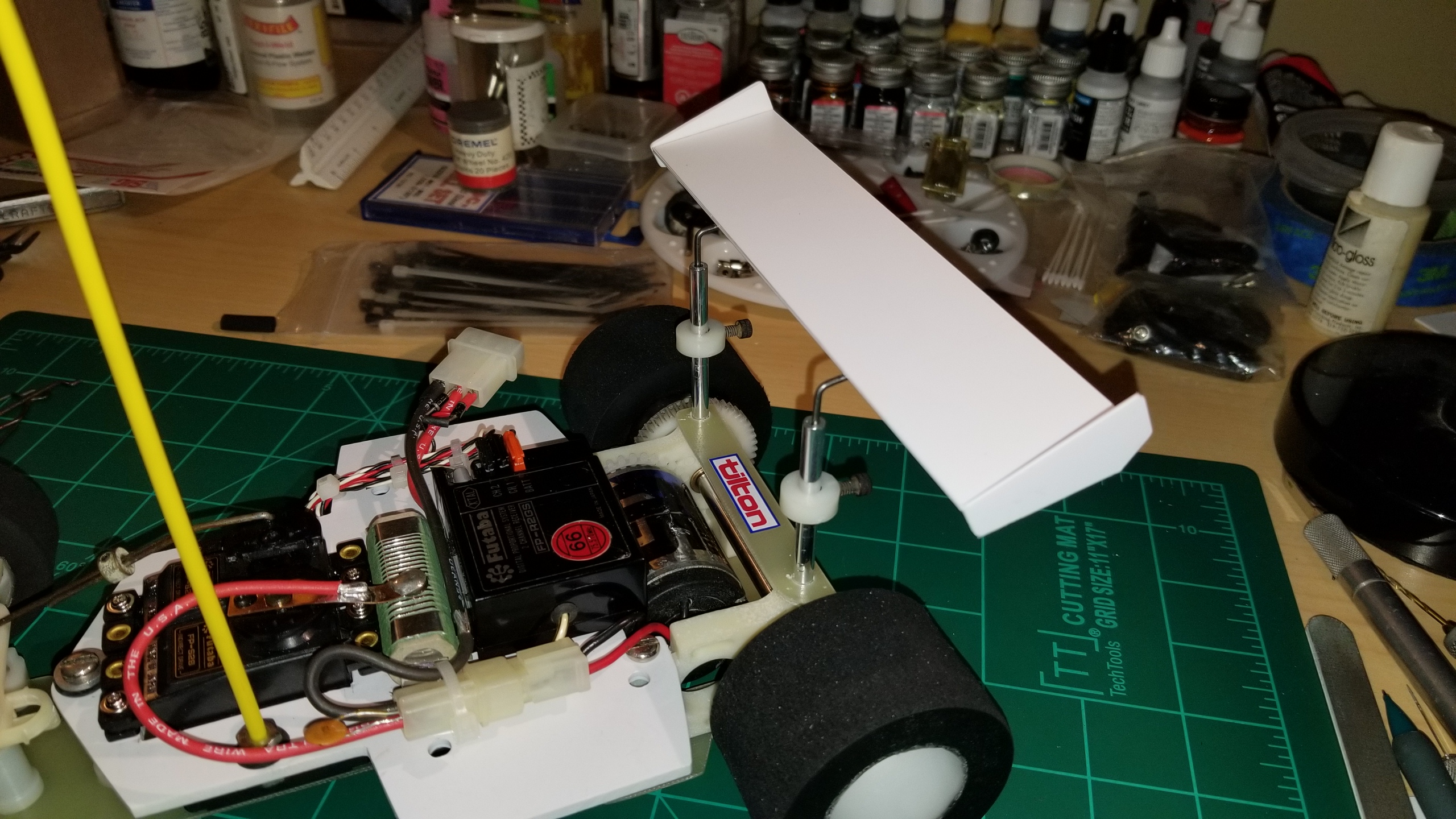

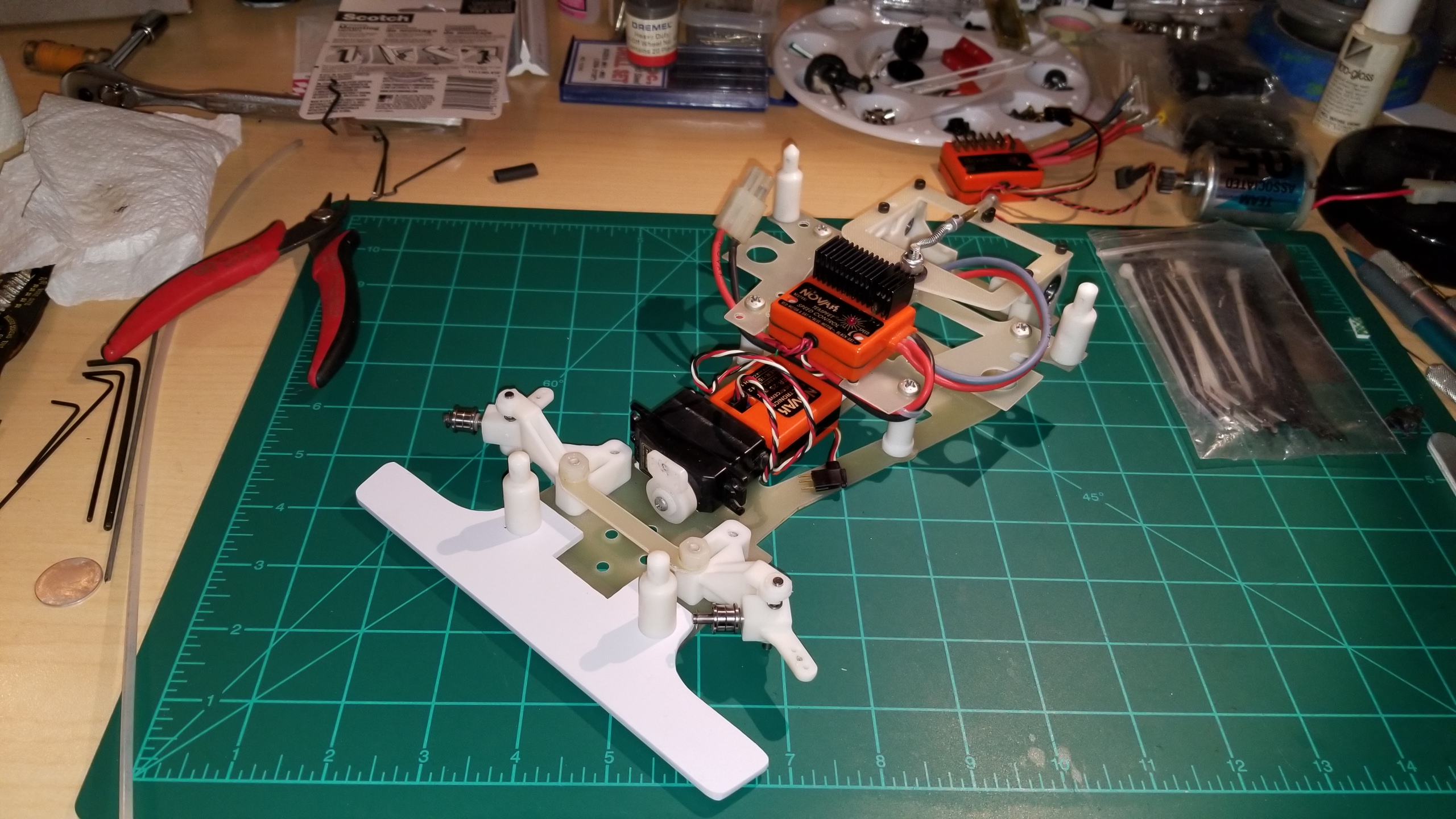

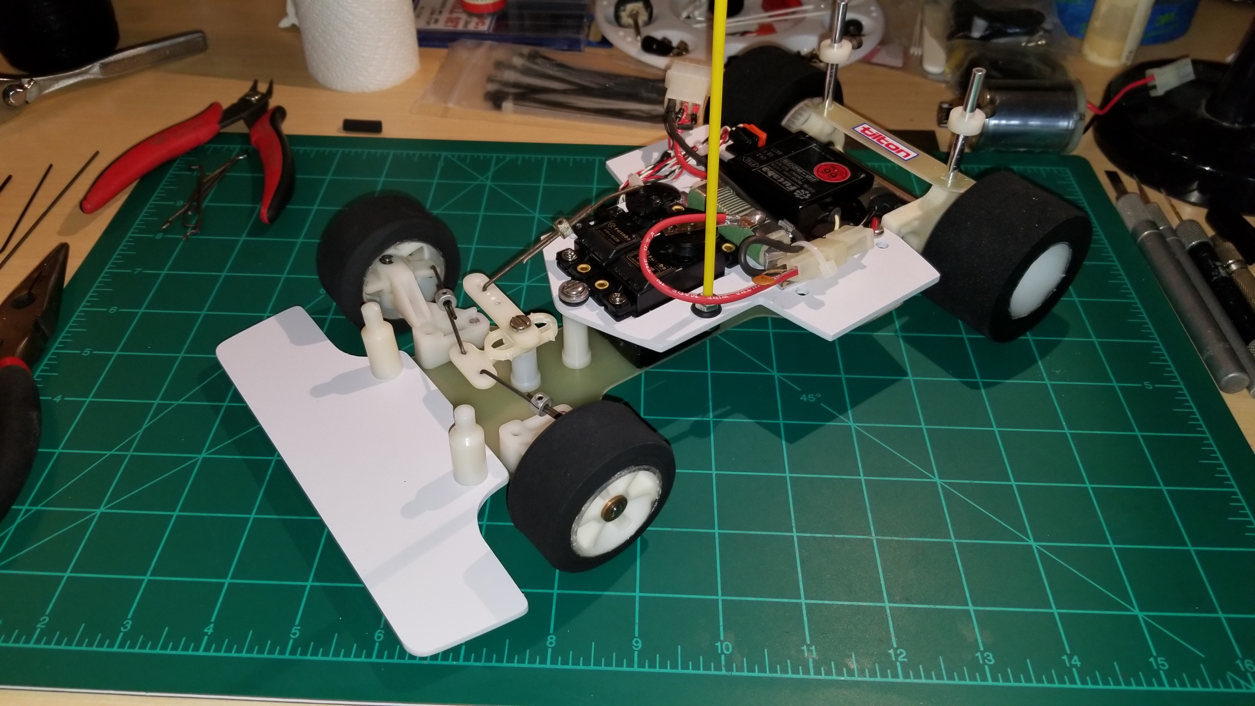

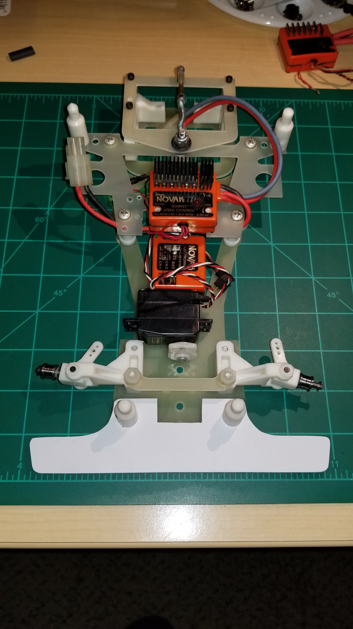

The fun continues. I started messing with the 12i a little tonight. Started placing the electronics and looking at wire routing and management. I still need to change the connectors on the speed control and the steering servo, but that is easy. I wanted to see how much wire I needed and where best to route it first. After I get everything placed I'll change the connectors and start assembling the steering linkages and get the motor and axle in the car. I also picked up some music wire so I can rebuild the linkages on the 12e. Once that's done I'll be on to painting up and mounting the TOJ body....I think....maybe, still undecided on the body.
