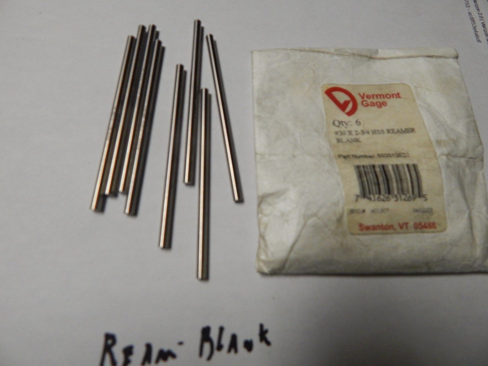

I've noticed that many of the hinge pin holes in Niki's '91 Stealth "racer" parts that came from iMaterize are printed oversize (a standard 1/8" pin is way too loose).
A #30 drill bit which is 0.1285" diameter fits almost perfectly. I've found reamer blanks in this size (#30 x 2-3/4" long) posted on ebay. Although I've never done this before, I think I can cut these blanks to length and grind the e-clip grooves using a thin Dremel cut-off wheel. Is this the best solution or is there a better way to solve the problem?

did you run a 1/8" bit through the parts? If they are oversize, I think it warrants a call to imaterialize to discuss the issue. they would have been manufactured incorrectly.
otherwise, sure, you could make any size pin you wanted as long as it fit the holes. the biggest issue is if the blanks are already hardened, you are going to have a hell of a time making e-clip grooves.

The problem is that an 1/8" pin or bit literally falls through the hole so drilling isn't possible. I hadn't consider this before but you're right, I probably should contact imaterialize to make them aware of the problem. The parts seemed to be fine otherwise but the sloppy pin fit makes them useless.
So, do "reamer blanks" typically arrive hardened? Won't they require some flutes to be added to turn them into a reamer and will these flutes be ground into the blank? I'd assumed the blanks were hardened after the grinding process. If I can't grind the grooves then I'll need to scrap the reamer blank idea. I could fill the holes with epoxy and re-drill them to the correct size but what a pita.
Meanwhile, I'll send a note to imaterialize and wait to see what they have to say.
Here's a pic from ebay...

They are usually ground in the hardened state.
Another option which I have done in the past is use brass tube with a 1/8" Id and make the od a light press fit and glue in place.
