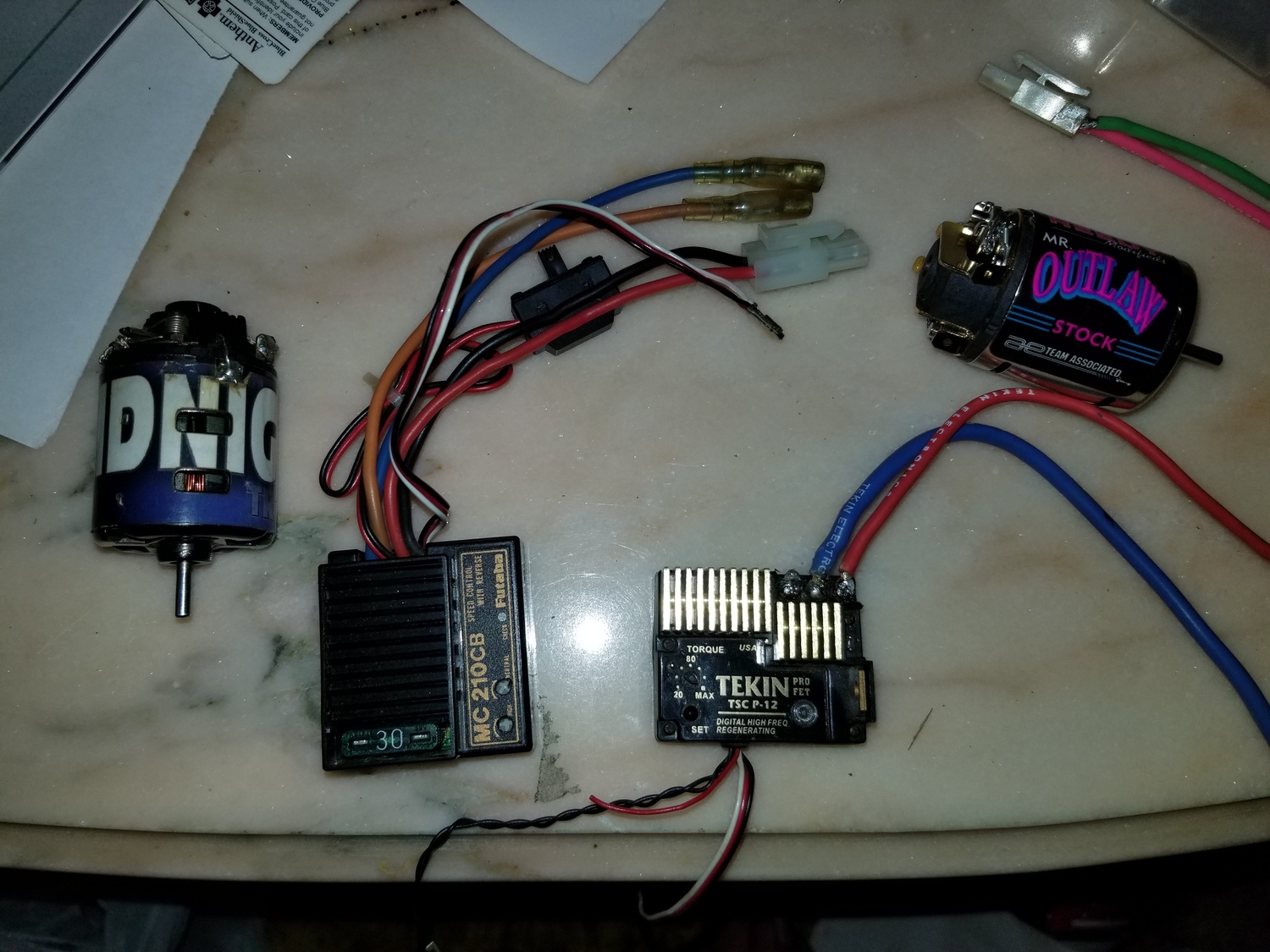

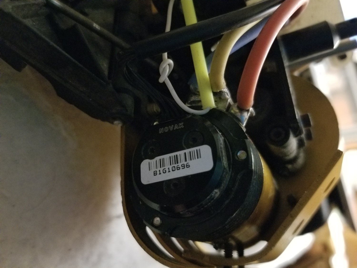

it has been converted to brushless ; Tekin R5 ESC and Novak motor - brl-2011-2012 m0275 b1g10696 (I have no idea???) {these are installed}
Also came with trinity midnight + Reedy Mr Outlaw stock motors and tekin profet tsc p12 + futaba MC210CB ESC's (unknown if they work)
So here is where I'm lost... plug in battery steering servo twitches for a split sec. and the ESC lights blink but nothing happens ?

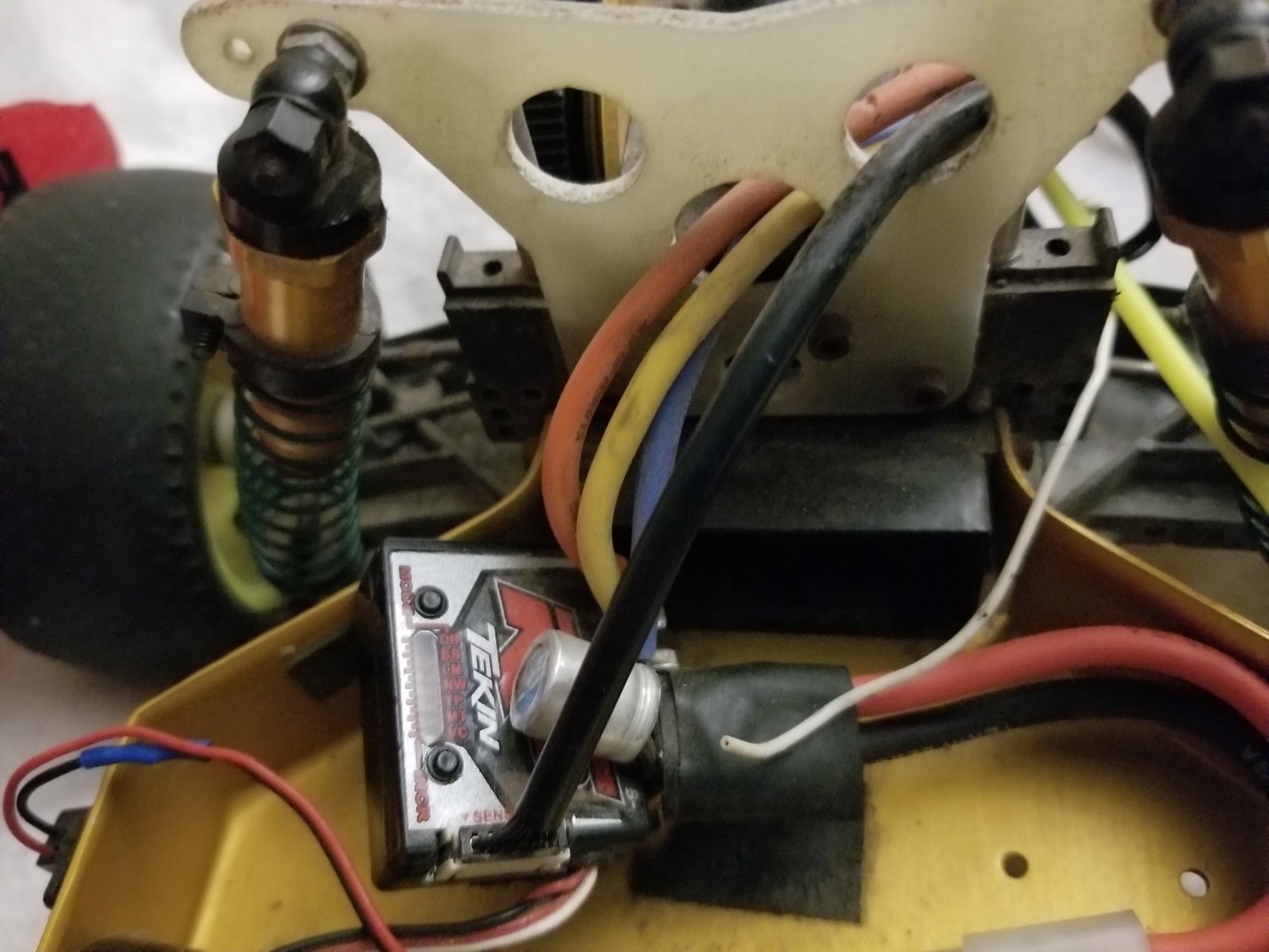

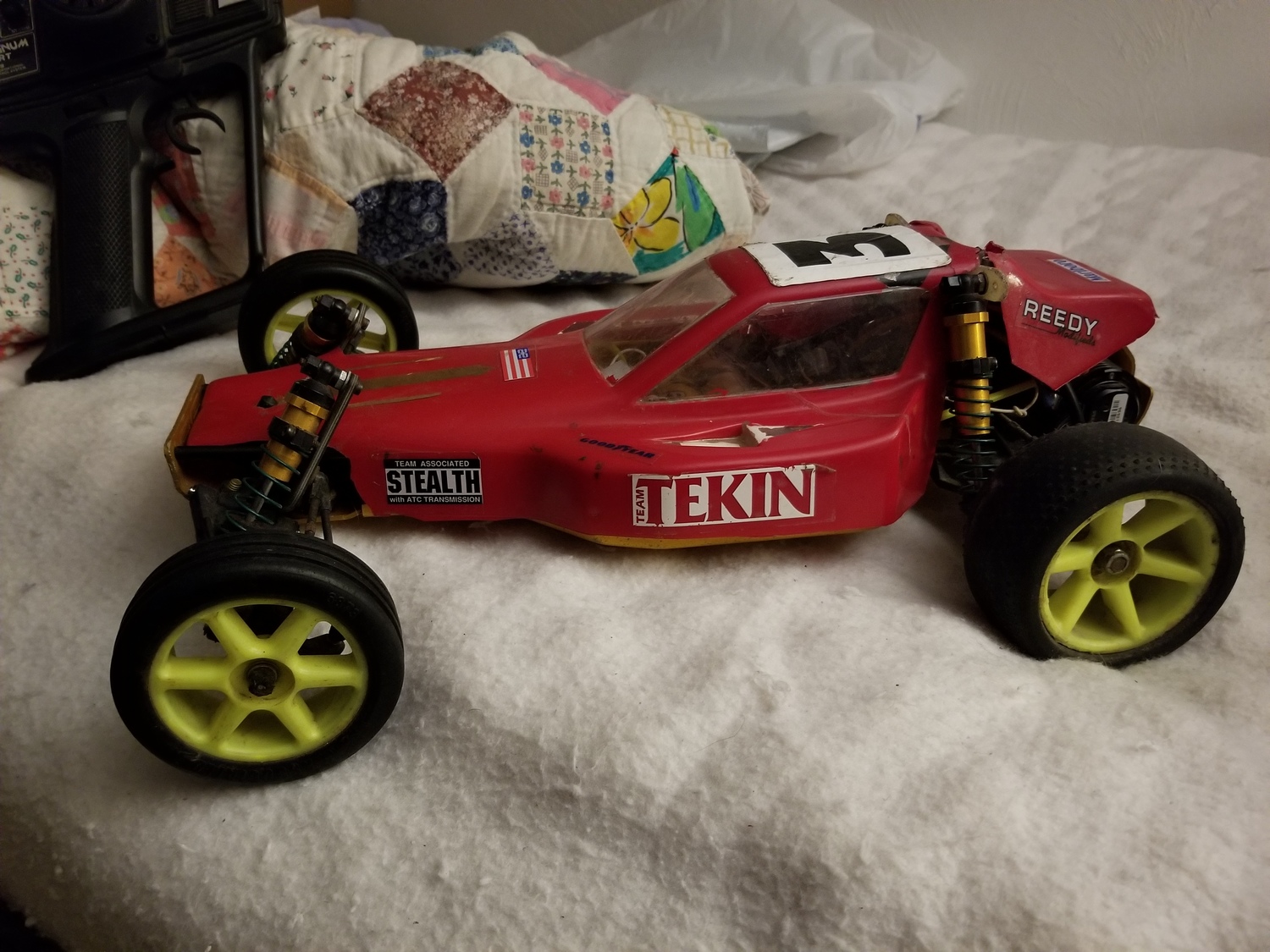

Here are some pics...
