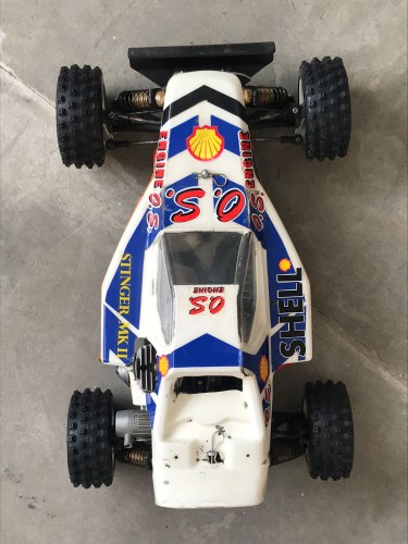

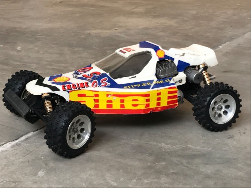

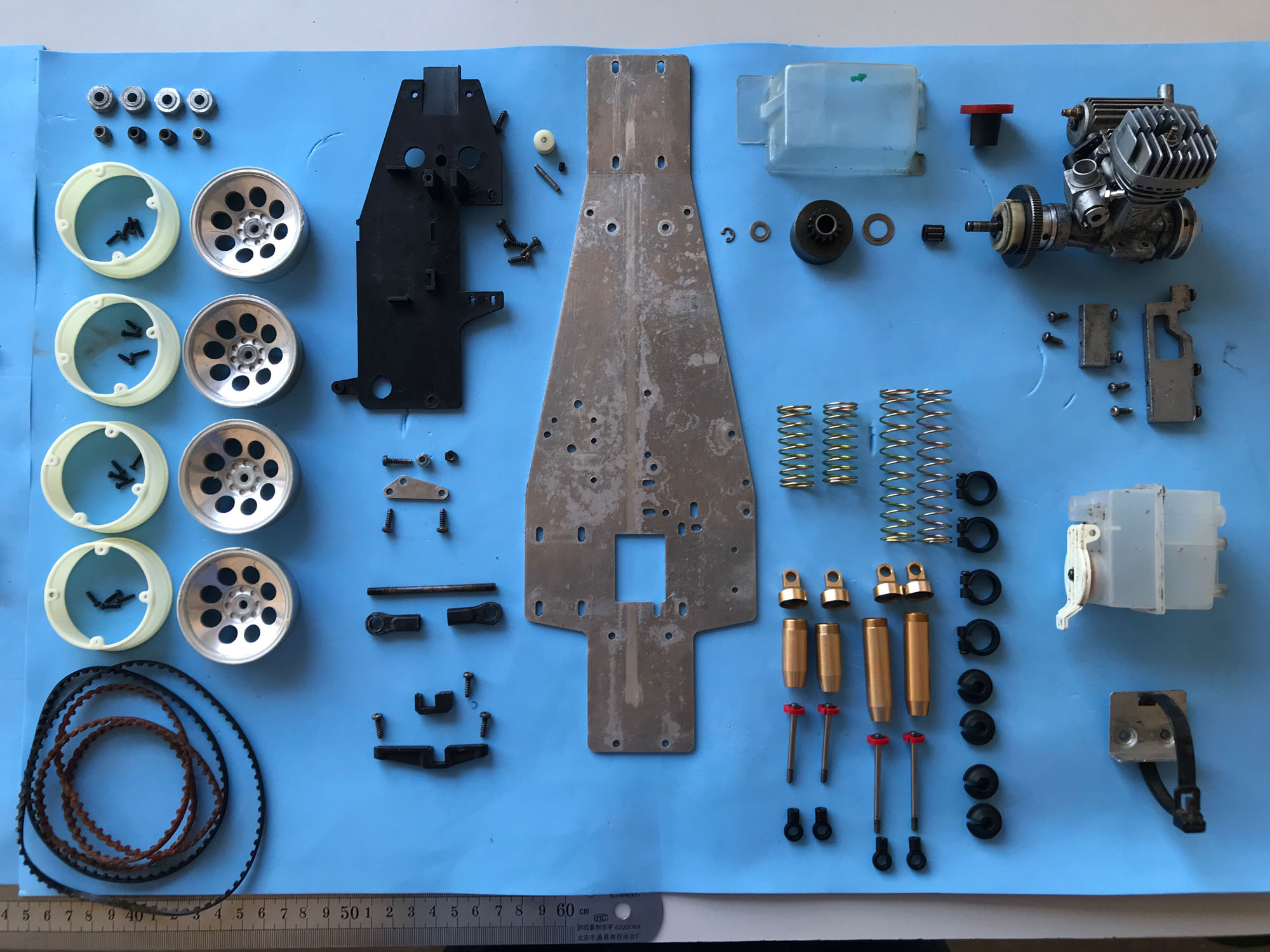

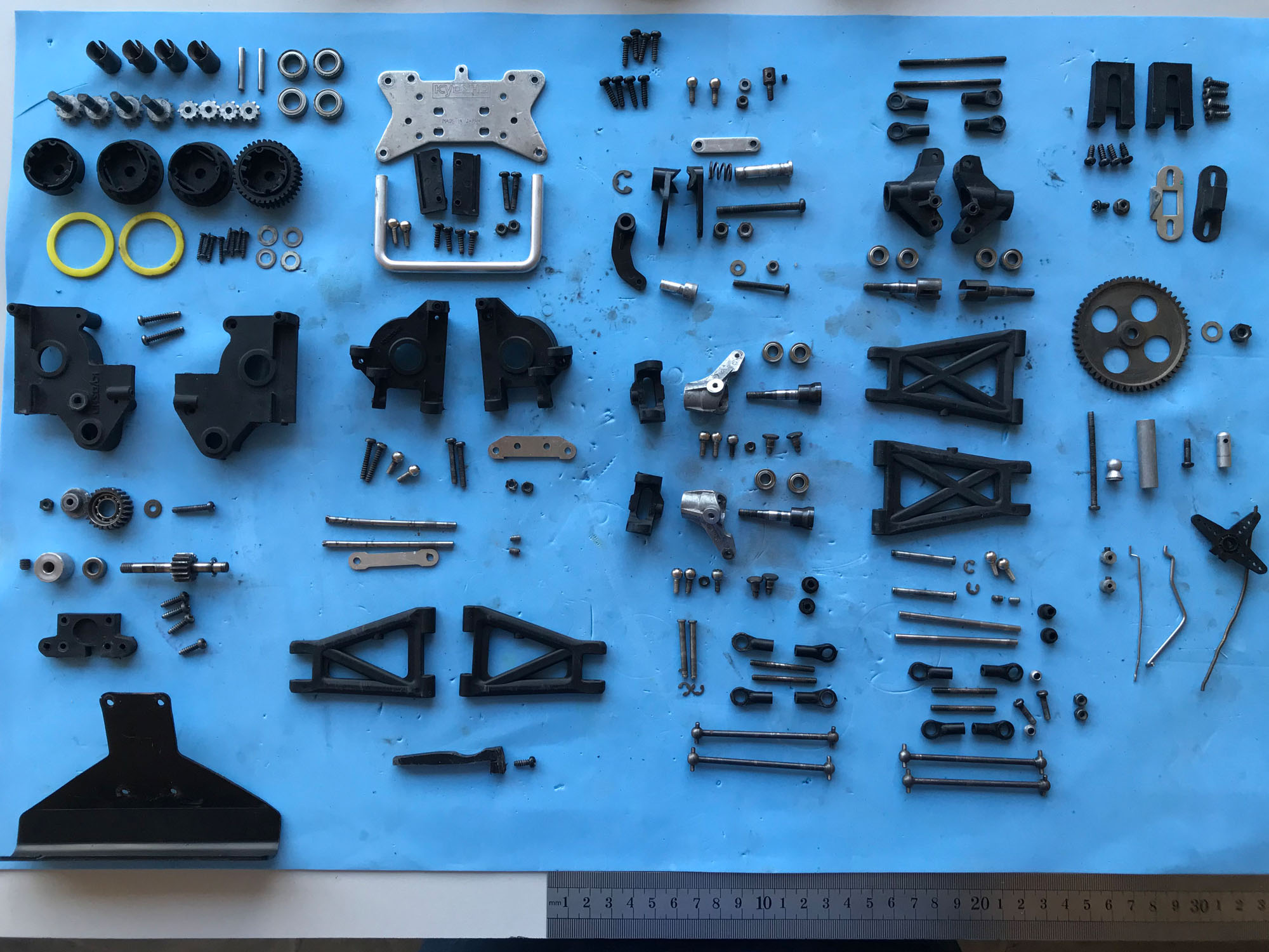

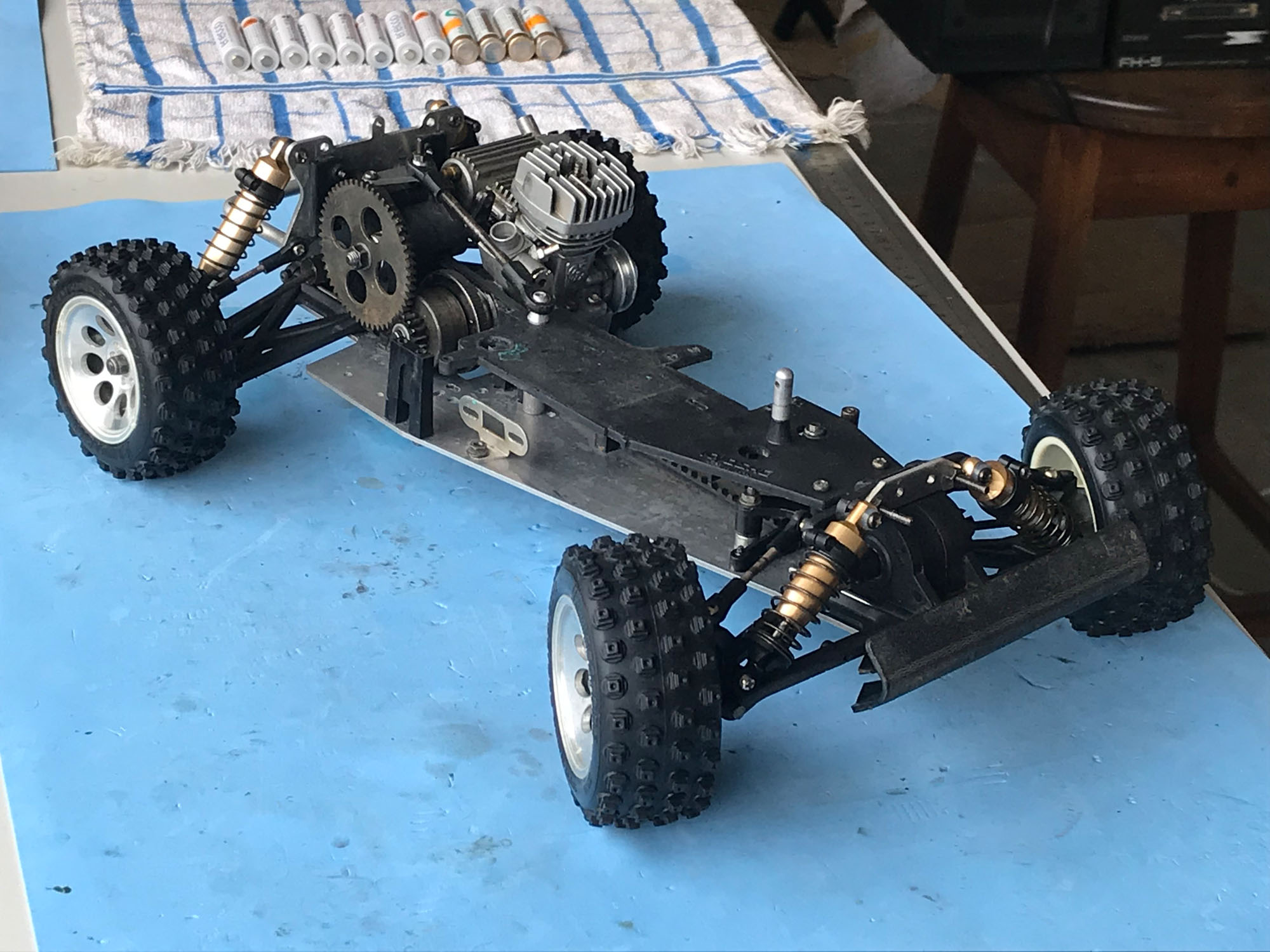

I have had my Kyosho Stinger MKII stripped down to the last screw for a few weeks now. I needed shock oil, and diff grease before I could start to rebuild.
The car has had quite some use and It took me quite a lot of work just to get the parts moderately clean.

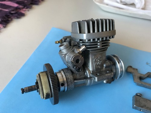

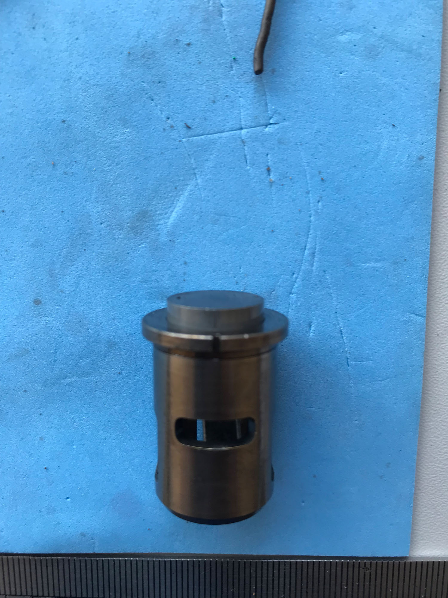

Unfortunately, after having worked on the thing for a while now, I've come to realize the O.S. CZ-2 engine has no compression. After a suggestion from the guy at a local hobby shop, I pulled the piston and sleeve from the engine and confirmed the piston goes right through. Bummer. I didn't want to spend any more money on this, but I may have to buy a new engine. There's a NIB O.S. 15 CV-X with recoil pull start on sale locally for approx U$190. It would be a direct drop-in.

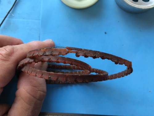

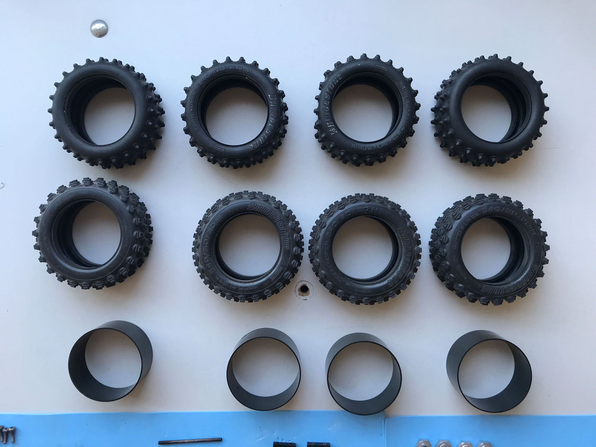

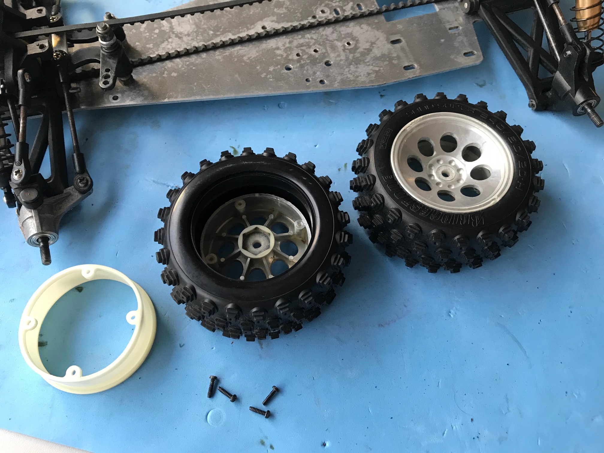

Original belt is disintegrating and tires are flat on the side they sat on for years (as well as cracking). Luckily I had the foresight 30 years ago to buy a new set of tires and belt. I had also added ball bearings and Gold shocks back in the day. Lost the wing unfortunately.

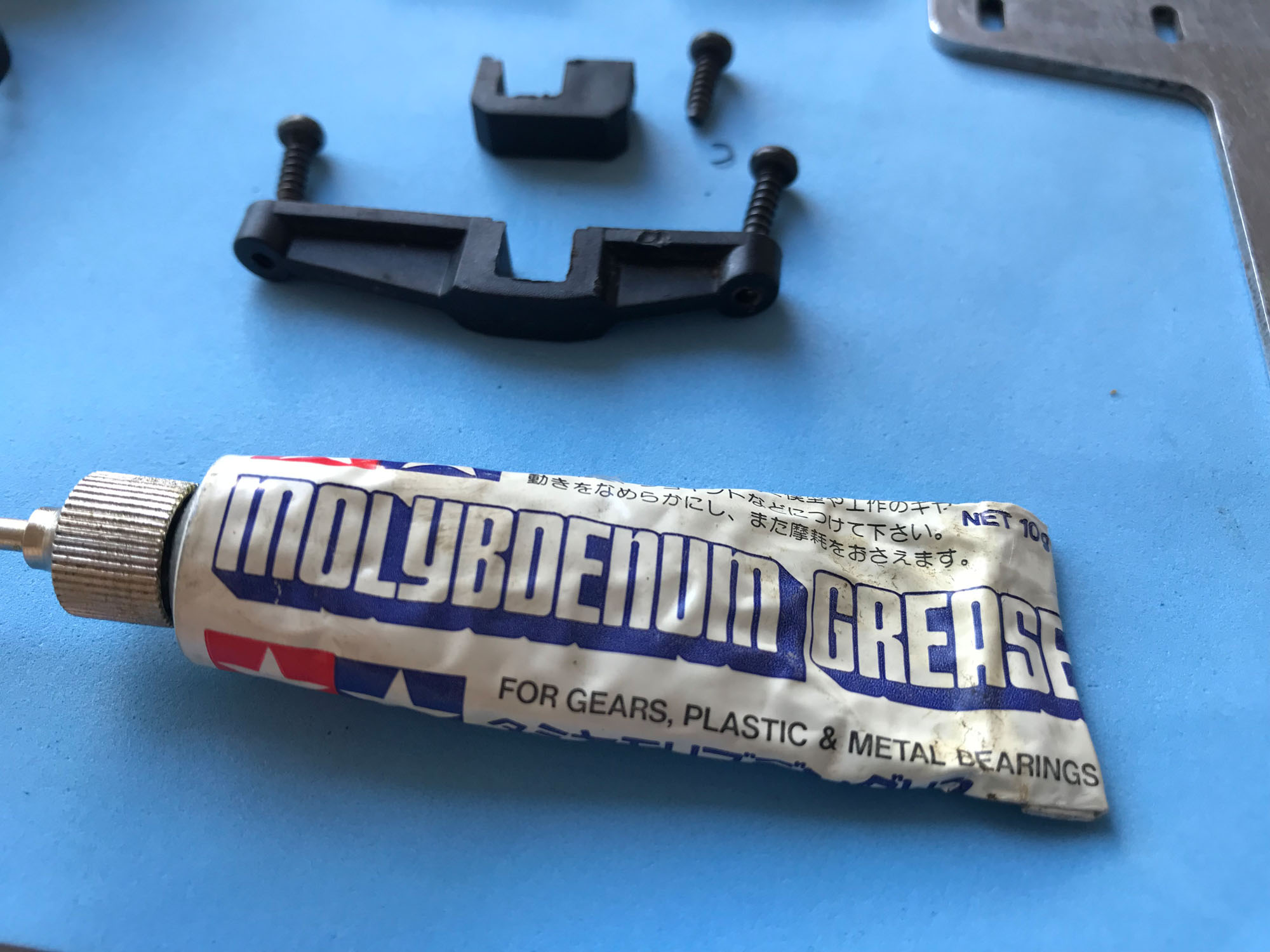

I'm planning on using a thirty year old Tamiya Molybdenum Grease, which I found with my old kit, in the differentials. Anything I should be aware of?
Hera are some photos (of a load of parts!)

Nice build, i will be watching. That grease is fine, actually any automotive grease is fine in the diff. U can get that sleave repinched for about $25. Need to stay with that engine! Rayaracing - Resizing Service & Equipment

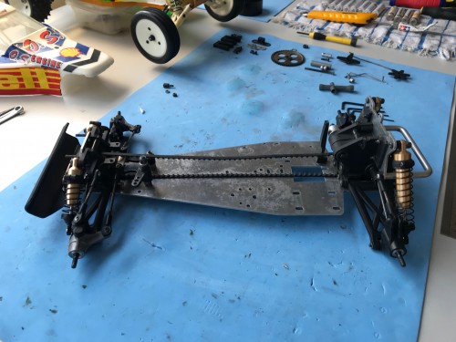

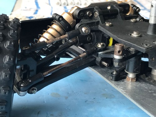

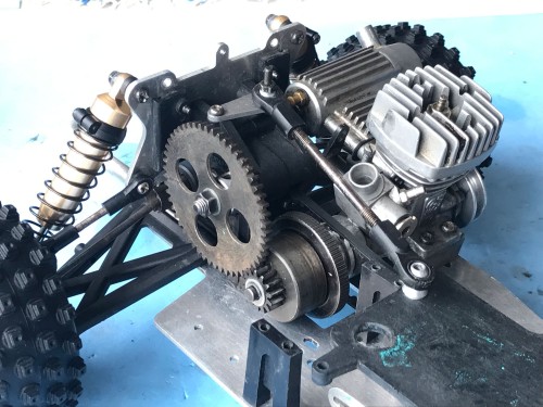

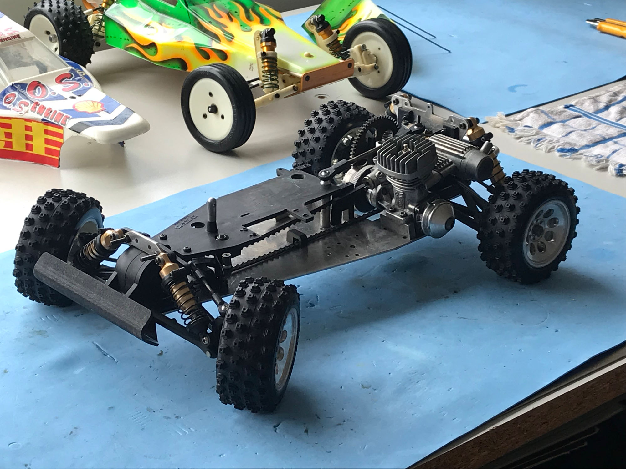

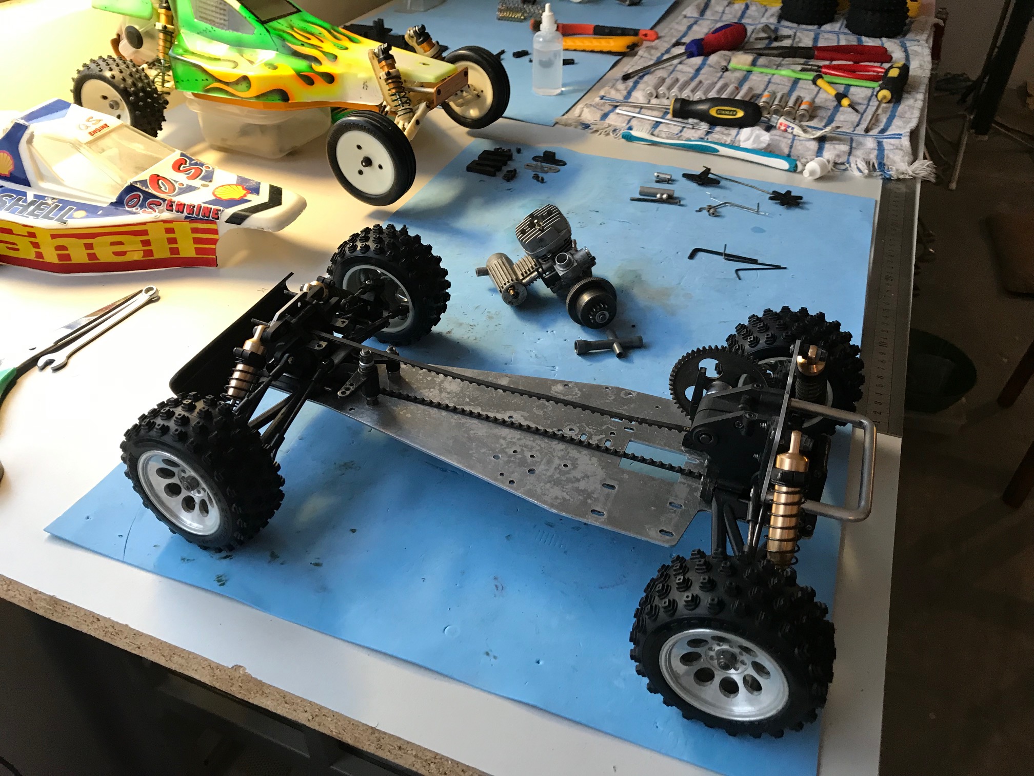

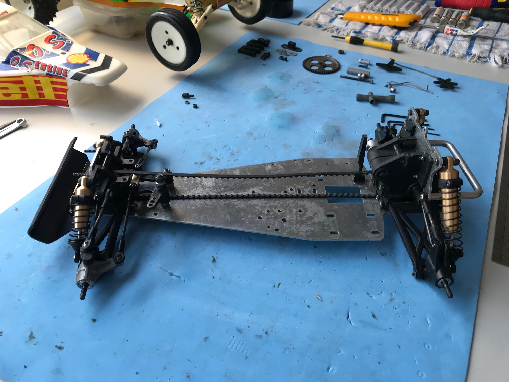

Here are a few progress shots of the rebuild:

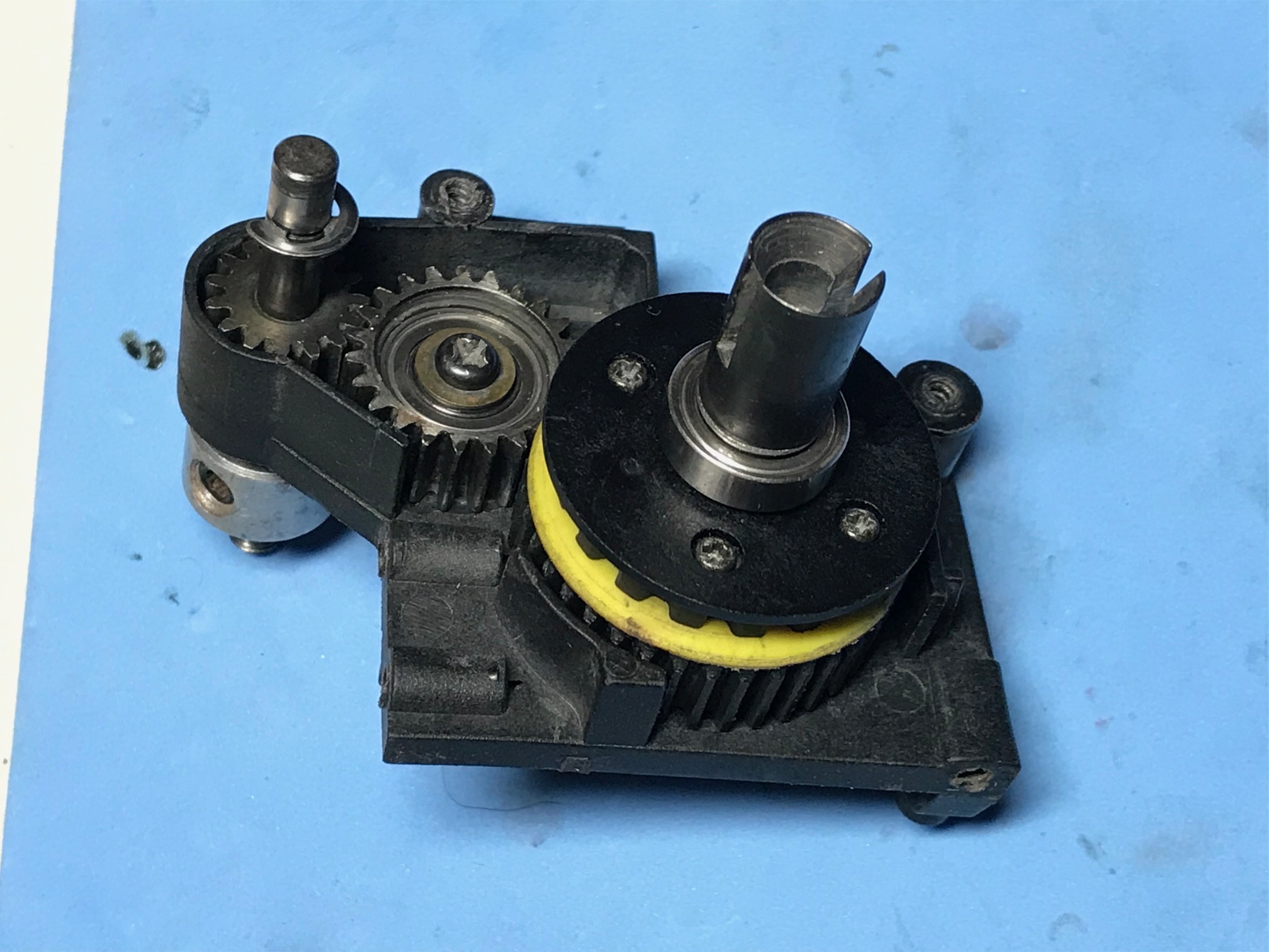

Rear tansmission. Teeth are in pretty good shape. Front diff. Note the belt is narrower than the splines on the diff. This belt is likely not the exact replacement. Maybe an Optima spare. Not sure. Wheel assembly includes tire, plastic insert, two piece wheel and 4 screws. These arn’t the original tires. I remember buying these because they were the closest ones available at my LHS. First part done:

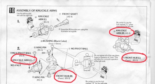

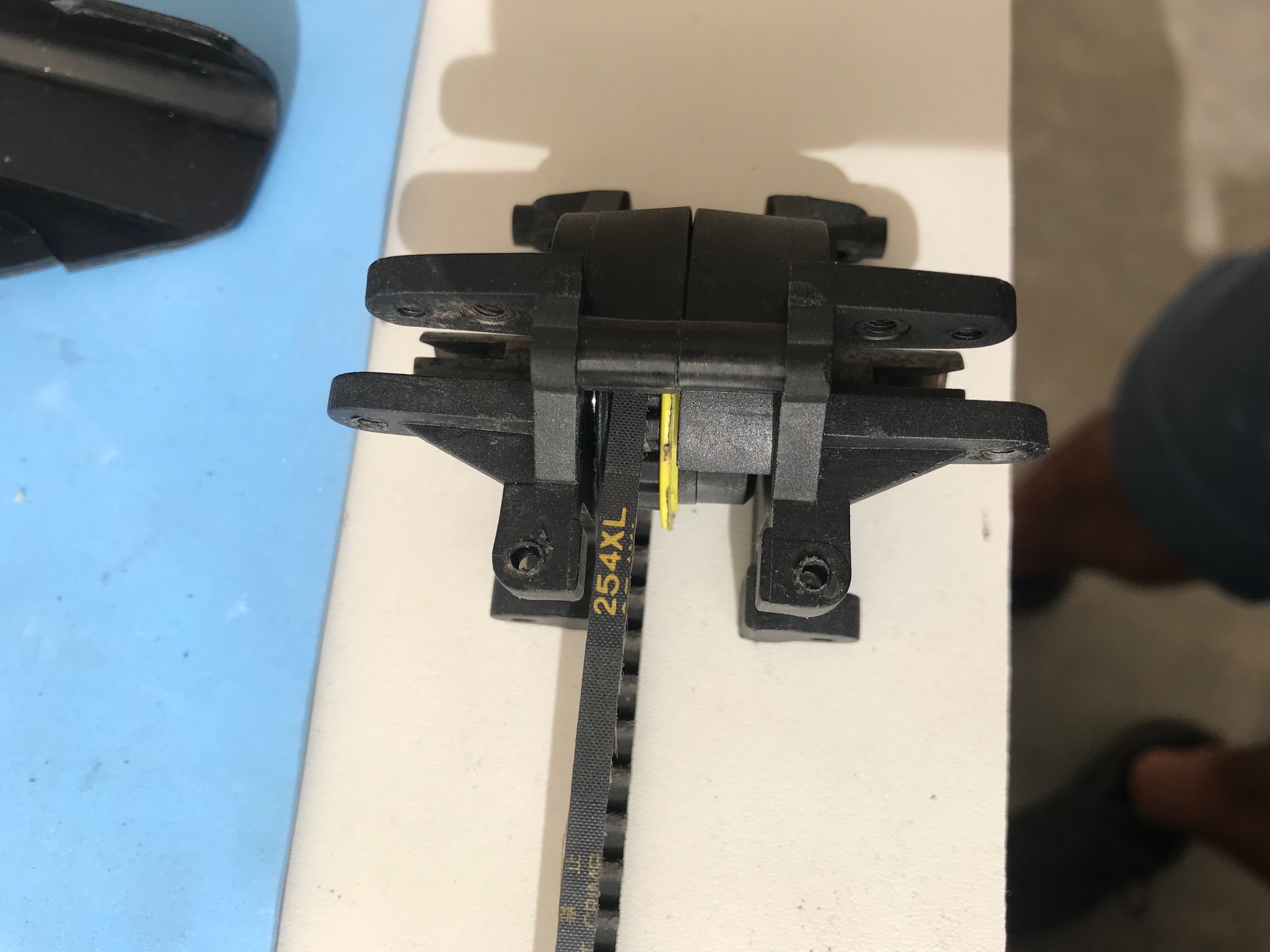

Regarding the manual, I noticed an inconsistency (maybe a Japanese quirk) while assembling the front drive train yesterday: It emphasizes you should assemble left hub with right knuckle arm and vice versa. Both knuckle arms look identical (other than the markings), so I went ahead and did what the manual says. But it defeats all logic.

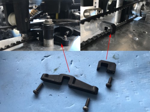

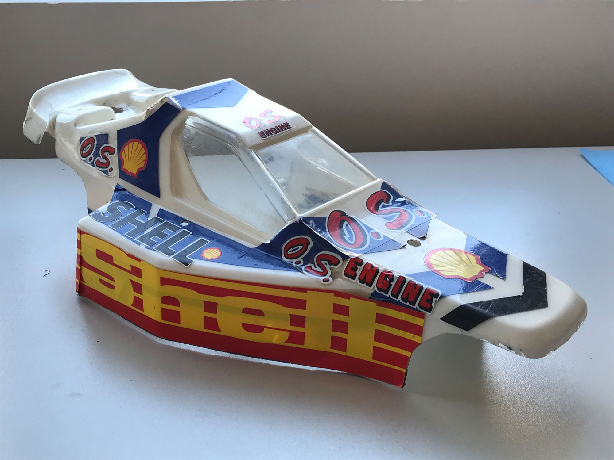

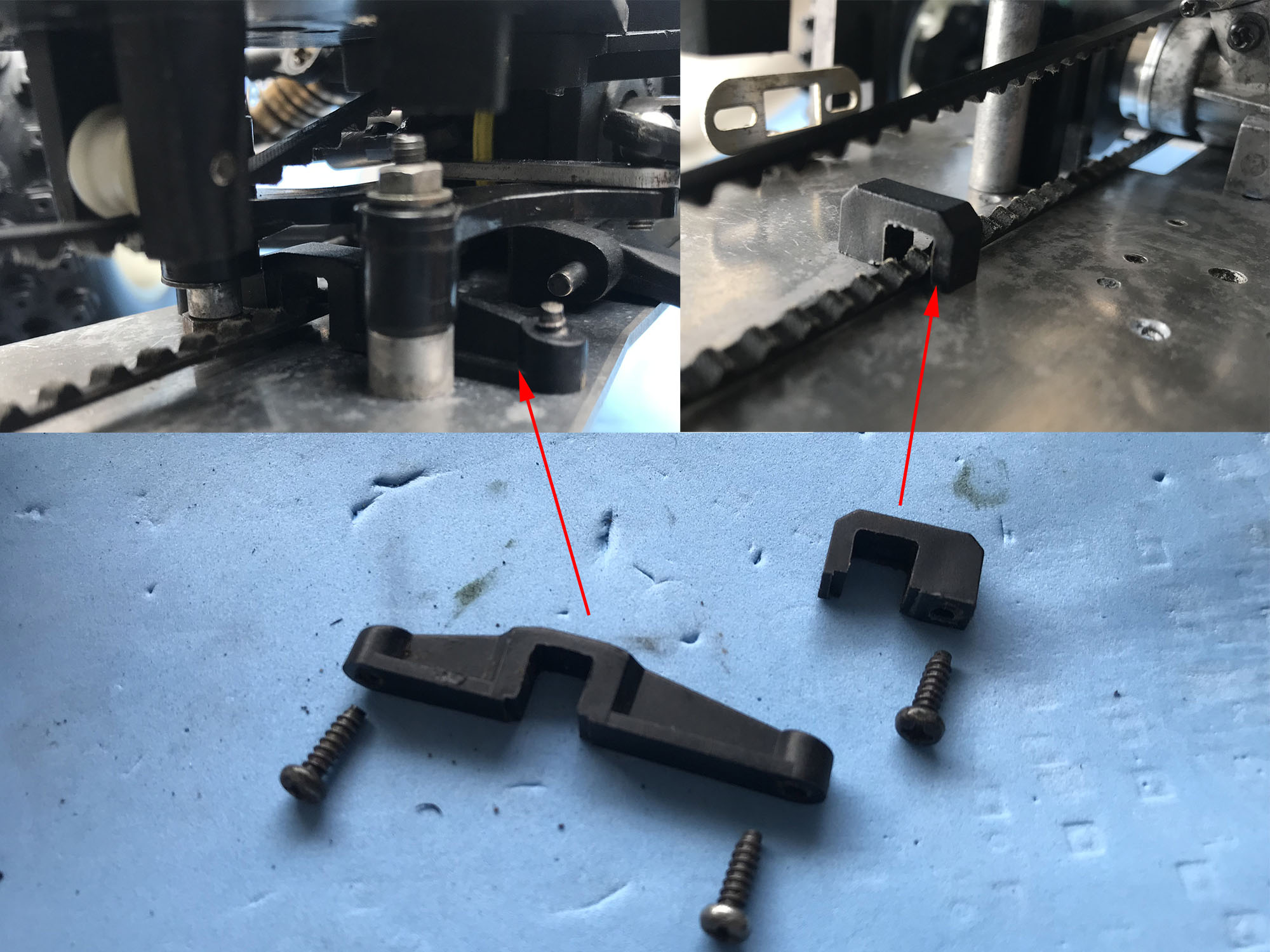

Continuing with the manual critique, I came across a couple other issues:
1) The car came with a transparent plastic belt guard/cover which ran along the base plate from the rear to the front diff. It was held down with a couple of braces. However, (other than I lost the guard/cover long ago) there is no mention of these parts in the manual. It might have been a later addition, and I may have lost the manual errata. 2) The other thing is, there is a connecting rod which connects the rear bulkhead to the top plate. The manual indicates a reference length for the rod, but when I pressed it into place, the spur and piñon jammed up. There are three adjustments which affect this: The rod length, the front diff position (which can be slid for-aft to adjust belt tension, and the engine mounting which can also be slid back and forth. The manual does nos mention in which order one should adjust each of these. Nor does it mention how much tension the connecting rod should exert. Well, thought I would document this in case anyone comes looking.

I like how those engines sit at an angle, looks tits!
Also, how do u get those red arrows like that?

Yeah, the motor mounts are angled at the base. I suppose it's meant to expose the heat sink forwards.
I put the arrows in in Photoshop. I can show you how it's done if you have access to the software.
