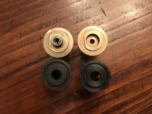

Hey everyone, just joined the site after recently acquiring my first hobby grade RC car. I’ve dabbled in RC aircraft, but never cars. I was probably naive buying a cheap old RC car, thinking it’d give me at least a few runs trouble free. My XX is in pretty rough shape; seems to have been neglected, lots of rusty hardware and worn out bits. My first time running the car was fast and fun...for about 5 min. The spur gear stripped, ending my fun rather abruptly. I think I attributed it to the slipper being completely cranked down, plus I haven’t checked the mesh between the gears.

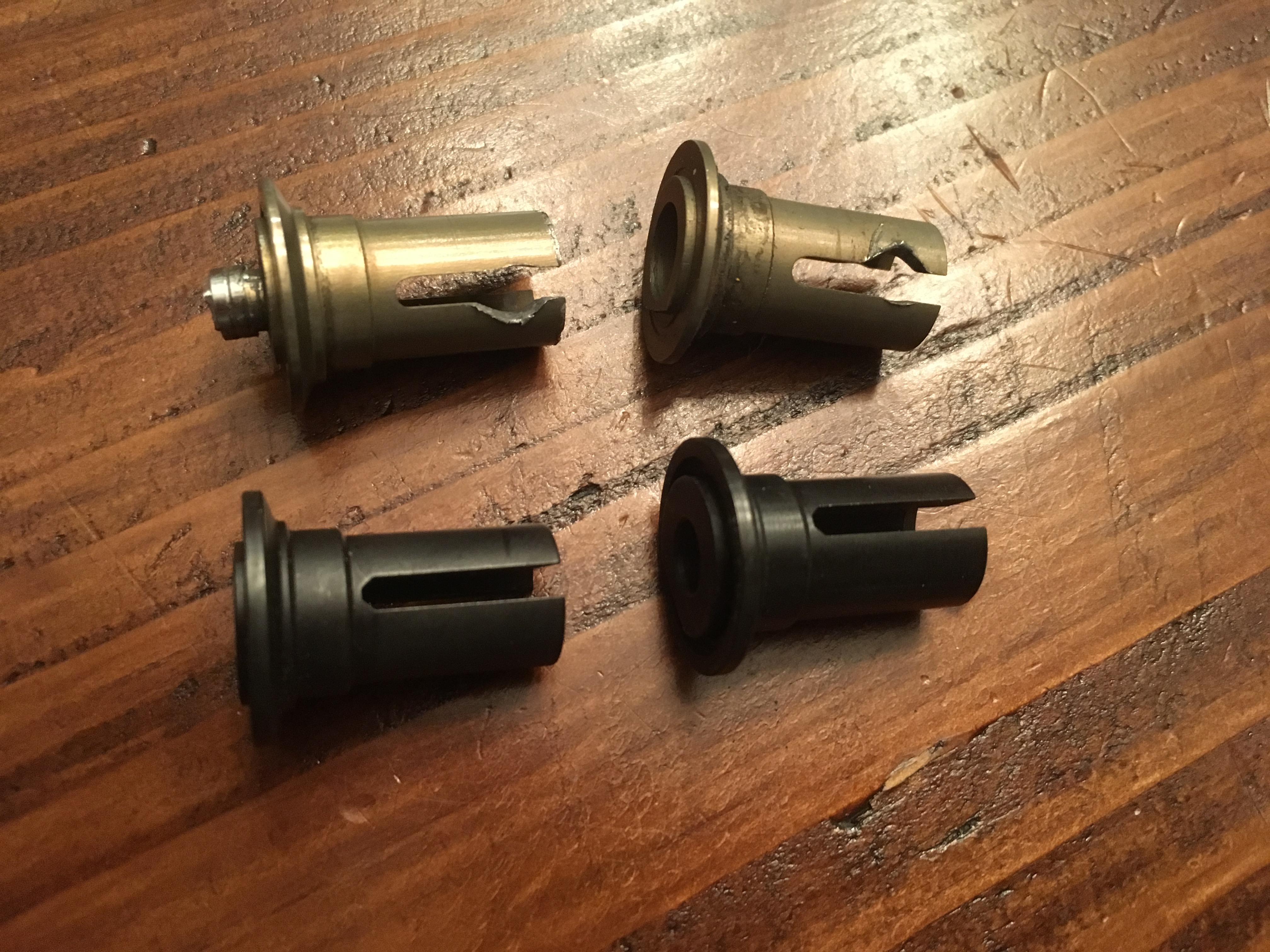

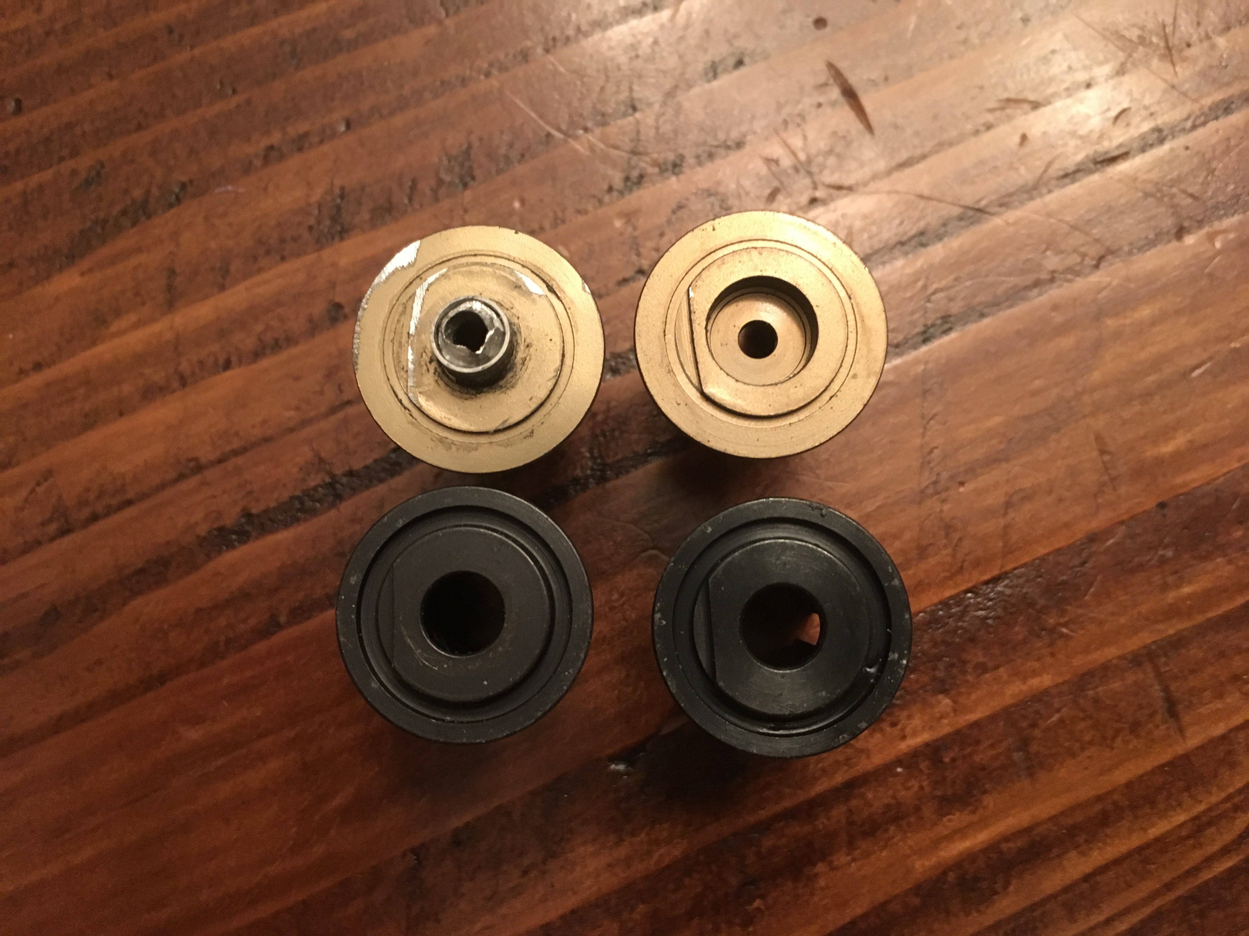

So long story short, here’s my problem. The two diff halfs were worn out, with the slots being obround where the axles make contact. I found a manual online, found the part # for the diff halfs, and ordered two up that I found on eBay. The new ones don’t match the old, other than overall dimensions. I don’t know if I ordered the wrong parts, or if maybe this diff isn’t original...I just don’t know enough about this car yet. Can anyone shed some light on where I can go from here? I managed to damage the original diff halfs (more), so just putting it back together won’t cut it.
Pics of old vs new (Gold is old, Black is new)

I don't have much insight on your issue, but I would probably just rebuild the entire diff with new parts if available (and according to the parts #s in the XX-CR manual). Just looking at the state of the outdrives it's been pushed real hard and I'm guessing not setup right. Might want to take a look at the other side of the drive shafts/CVDs and make sure those are in OK shape in case something is binding during use.

the original worn out drives are aluminum, not sure if it was a losi upgrade or an aftermarket one. either way, not really intended to last very long, more of a super stock type application. the bone pins should show very little wear, that's a good thing.
the new ones appear to be steel and the correct parts for your build, should last a good long time.

Looks to me like you just need a Diff Tube (A-3072) and a new 5mm x 8mm Bearing (A-6907) and you should be all set. www.sabulatech.com has both in stock.
