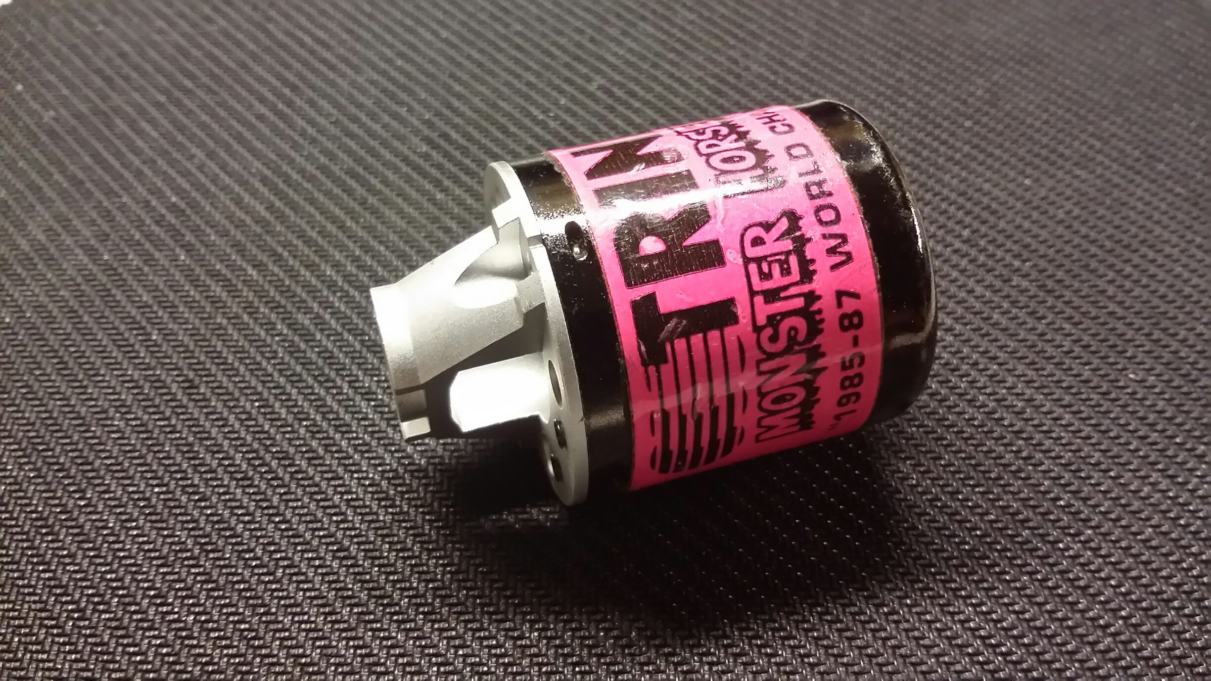

Came across this recently and had to pull the trigger. Not too sure what is in it - check. Well aged yellowed plastic case -check. Small bits of dog hair tangled around parts -check. Attempt to bring them back from the dead? Sure, why not? :D
I think I can work with these.
This was a pleasant surprise. Not sure which Trinity model this is but it has the cool aluminum end bell and can/label is in good shape. I will need to fab the missing parts. King Kong motor? Dunno.

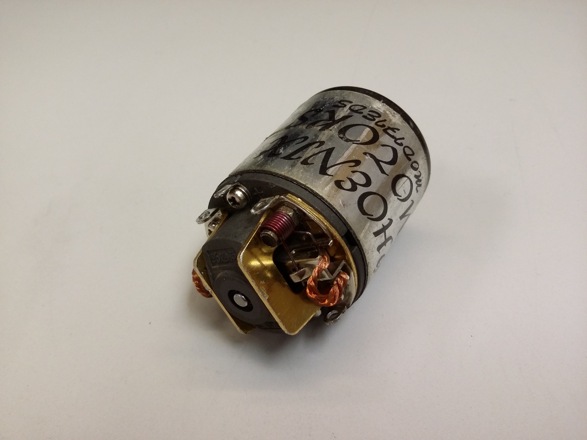

This is kinda neat too. An old Bolink that will go nicely with my future Eliminator 12 revival.
Never seen this one before. Look at that comm! That one is toast. I will get this one running once again too.

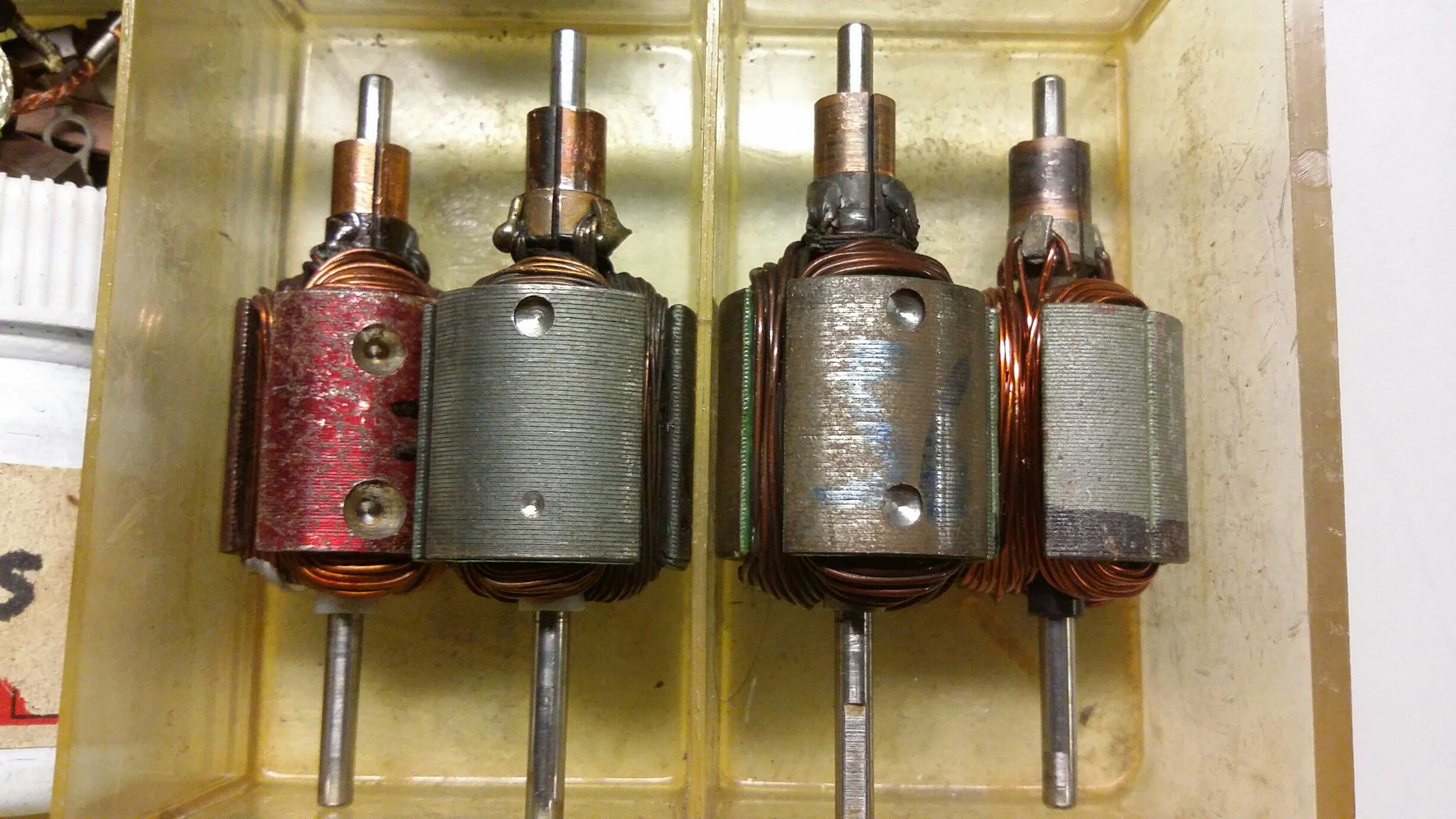

All the arms still have more life left in them. This will keep me from getting bored for a while. :D

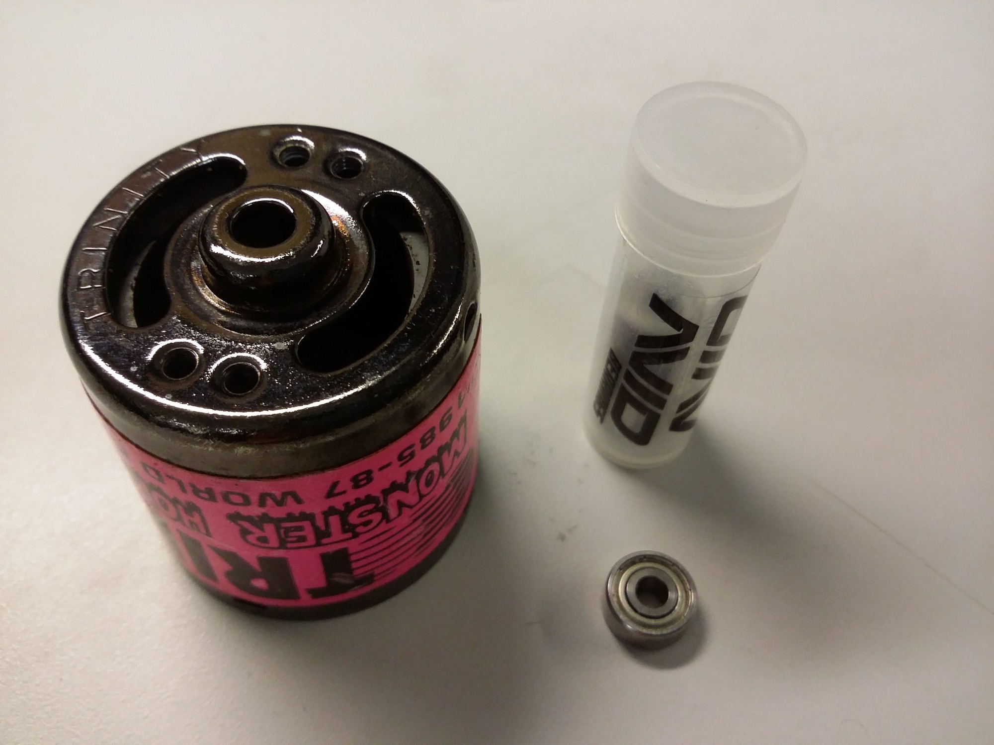

Working on the Trinity. Installed new bearings from Avid.

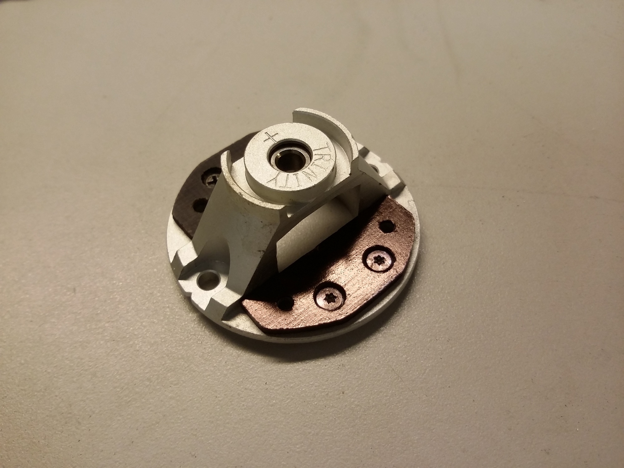

Had to fab the missing isolators from frp board. The holes had to be drilled spot on. I went through several pieces to get it right.
painted them black with a sharpie :D
Finding the little screws was difficult. Managed to locate a few that worked.
Sacrificed an old Yokomo motor for the proper brush hoods.
Aligning the hoods.

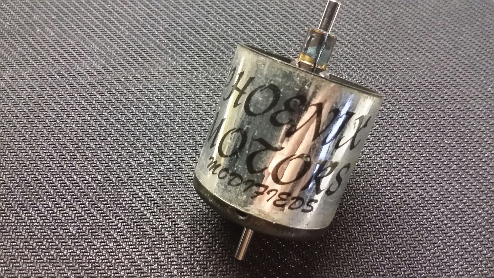

Had some time to bring this one back to life. I put in a little used arm with a unknown wind. It looked like an old twisters arm but who knows. Anyway, I did the usual clean, oil, fitting of brush hoods, shimmed the arm, matched the springs and installed new brushes. I then applied power and tweaked the timing. It slowly spun up and then roared back to life! Neat, this unknown wind motor is a hot little number. This is fun, moving on to the scrappy lookin twisters can.....
