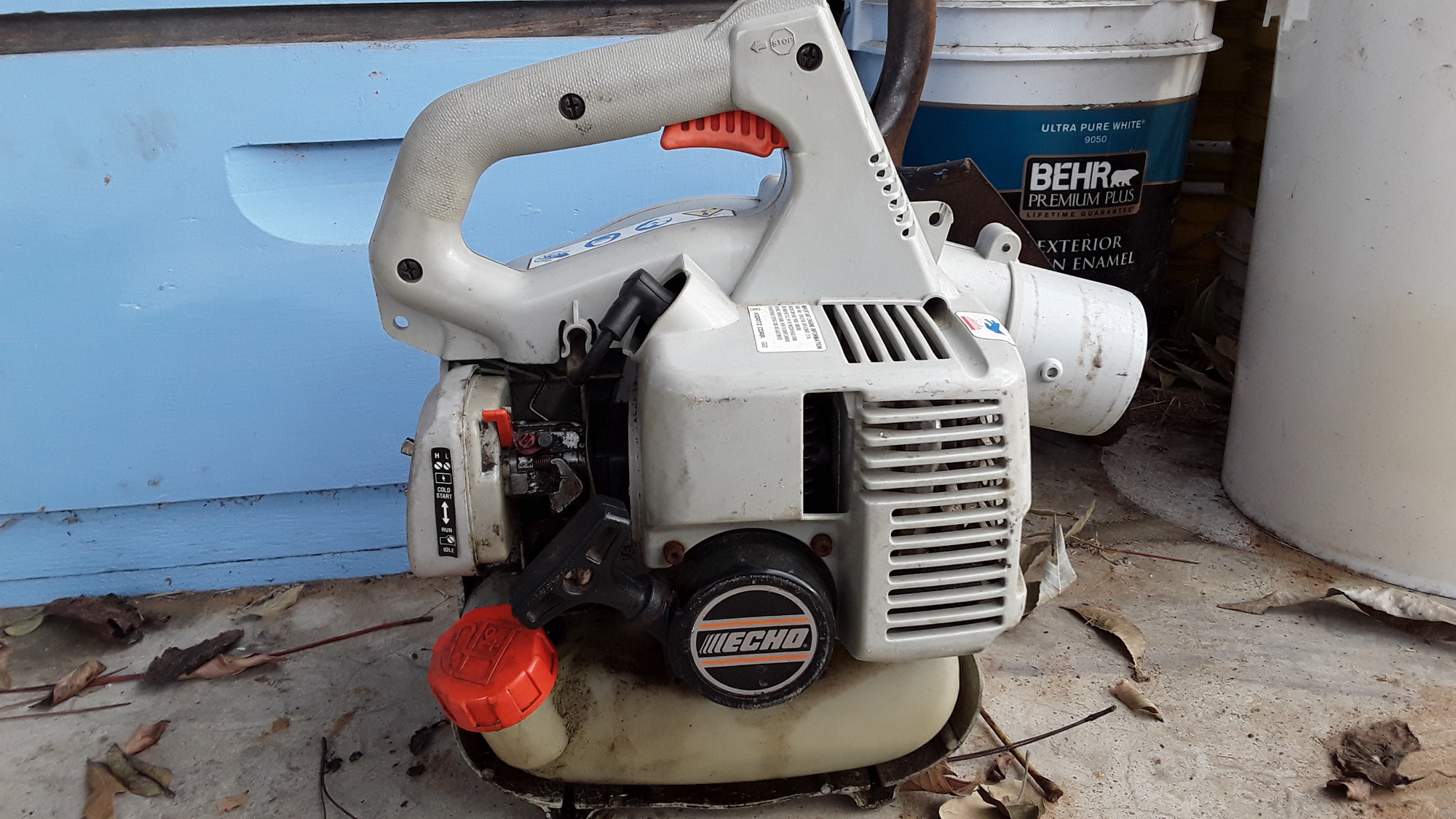

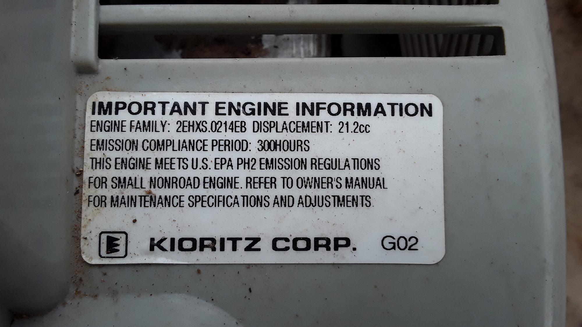

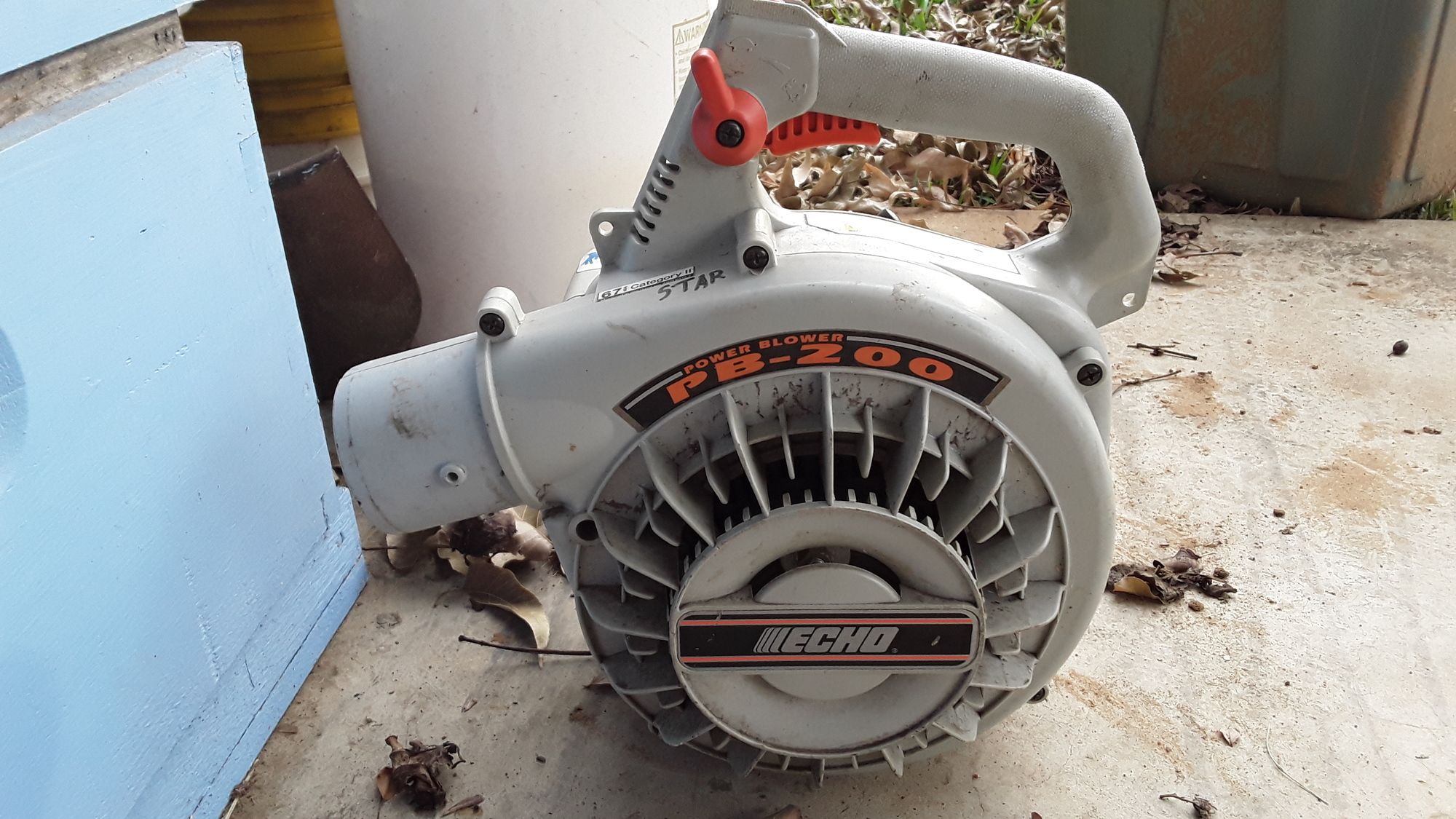

Sourced a powerplant!
Got this for $3 from a neighbor that has previously sold me a project. It's an Echo PB-200 blower, minus the tube. 21.2cc.
This is actually a secret project from my parents, because my dad has put a limit on my number of projects, so this exceeds that limit. But it's not gonna stop me. :mrgreen:
Anyways, it turns over nice, feels like good compression, and incredibly, it had a clean and dry tank! I don't have to clean that out! Great spark! When I looked into the cylinder, it looked a little scored, but it should be fine since it has compression.
The purge bulb was totally busted, so a new one is on the way. Otherwise, I think it should fire up once I install that.
I may end up building a scooter for it from scratch, since I'll probably get a welder this year for Christmas. Otherwise I can just modify a Razor scooter.
My plan is to get it running, and eventually stick it on a scooter. I'll remove all of the plastics to make it more compact and aesthetically appealing, I'll have to change the exhaust direction, and maybe a few other things.
I'm really pleased with this purchase, since it was only $3, Echos are extremely reliable, plus this engine was made by Kioritz Corp in Japan, compared to our newer Echo trimmers, which are made by Yamabiko Corp in China. Made in Japan = QUALITY!!
Original Cadillac A stamp AE RC10 with Hot Trick parts! That's how I roll! 8)

Even if it ends up needing some rebuild you can't pass that up for only $3
