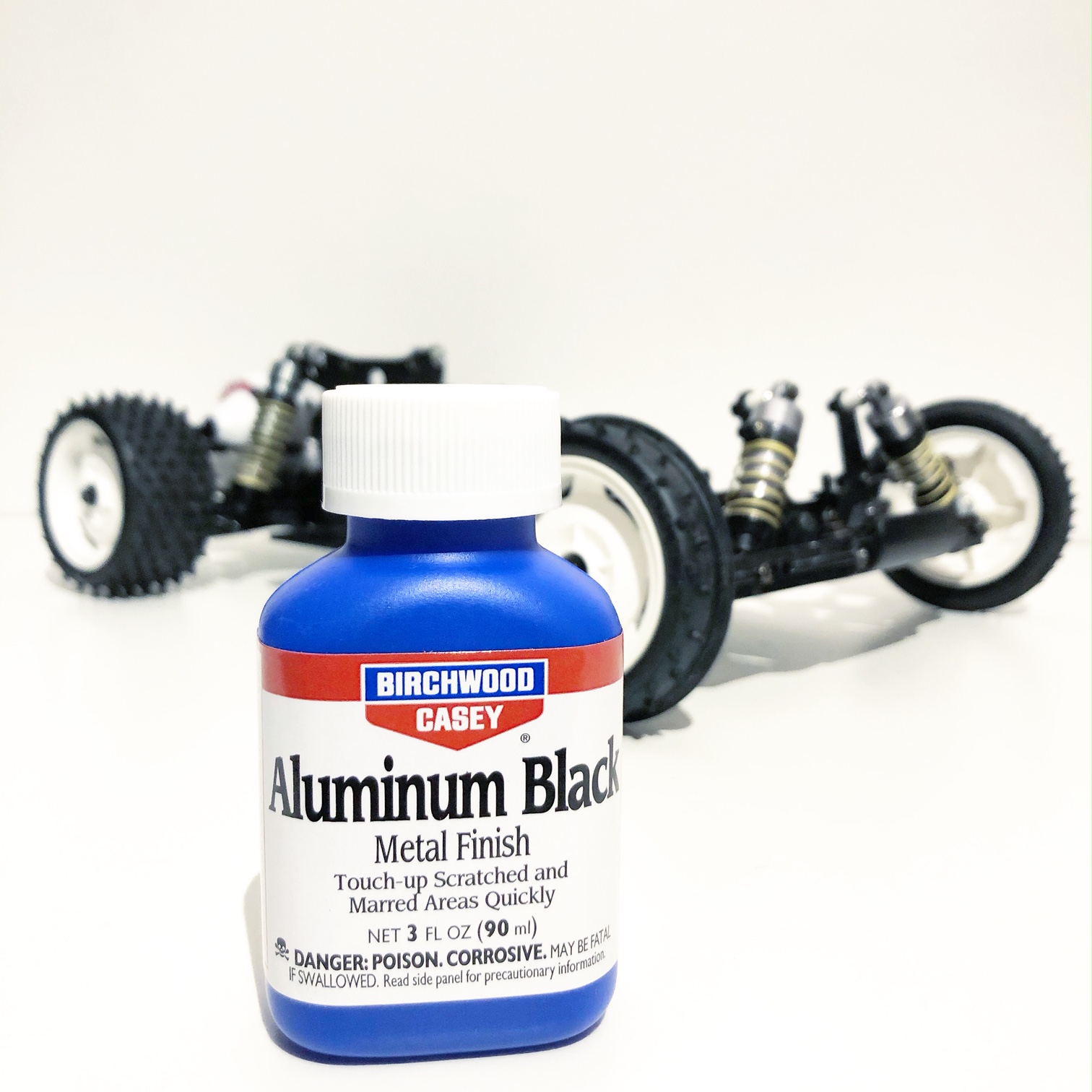

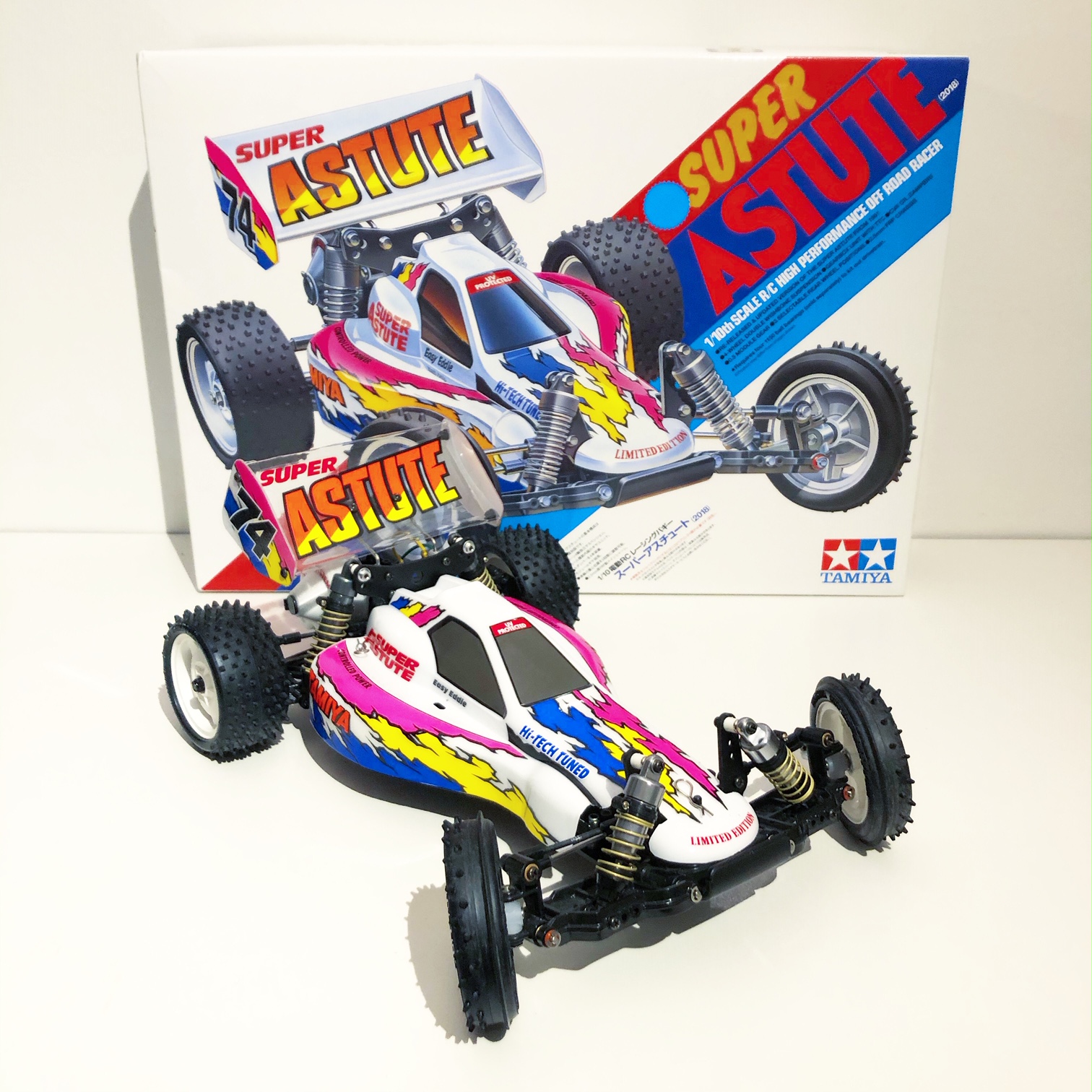

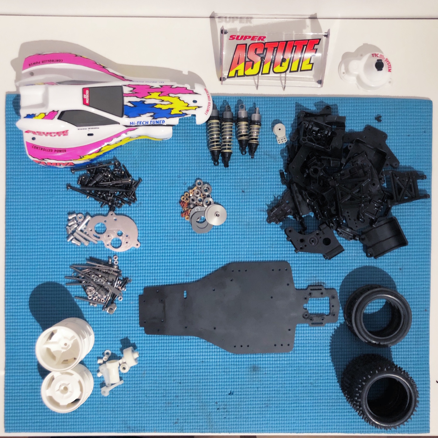

I got a good deal on a built Super Astute rere.
Thought about how to go about this build/mod and figured I'll do a all black and gray version starting with the hardware.
I've never used Birchwood Casey Aluminum black and Super Blue (not yet received), but thought I'll give it a try.

I've used the birchwood Casey ally black a lot and its not easy to get consistent results , the parts need to be super clean and even be rubbed over with wire wool just before application , it acts fast so be ready with a bowl of water or you just get a sooty deposit that rubs off easily , it can be buffed with T-Cut ( popular brand of car paint polish in the UK )after blacking and then a clear or matt lacquer to protect the finish , on some alloys it gives a nice blued finish , on pot metal just a sooty black , oh and wear protective gloves ,it does nasty things to skin and finger nails become easily broken if they get contaminated .
Best of luck .
Best of luck .

Thanks for the advice Dadio, I've been doing some test trails and think i've got the hang of it.Dadio wrote: ↑Thu Nov 14, 2019 6:37 pm I've used the birchwood Casey ally black a lot and its not easy to get consistent results , the parts need to be super clean and even be rubbed over with wire wool just before application , it acts fast so be ready with a bowl of water or you just get a sooty deposit that rubs off easily , it can be buffed with T-Cut ( popular brand of car paint polish in the UK )after blacking and then a clear or matt lacquer to protect the finish , on some alloys it gives a nice blued finish , on pot metal just a sooty black , oh and wear protective gloves ,it does nasty things to skin and finger nails become easily broken if they get contaminated .
Best of luck .
Really surpricing how different alloys and metals react to this stuff depending on compositions oh and I promise to use gluves..

Not sure if the bits your doing will allow this but if you can spin the part in a lath or drill chuck and apply the blue its easy to get a consistent finish then use a damp cloth to neutralize while still spinning and go straight to polish , it would work on shocks really well .It really is surprising the difference in colour you get with different metals .
Oh i almost forgot , don't get it on or use it near steel , it corrodes it fast ! I spilled some in my workshop on the concrete floor , didn't notice i'd done it and had some steel tubing in a rack nearby , next day it was all covered in rust !

Now thats a great tip. Thank you so much.Dadio wrote: ↑Mon Nov 18, 2019 4:55 am Not sure if the bits your doing will allow this but if you can spin the part in a lath or drill chuck and apply the blue its easy to get a consistent finish then use a damp cloth to neutralize while still spinning and go straight to polish , it would work on shocks really well .It really is surprising the difference in colour you get with different metals .
Not alu black on steel. Check.
I will get Super Blue for the steel parts.
