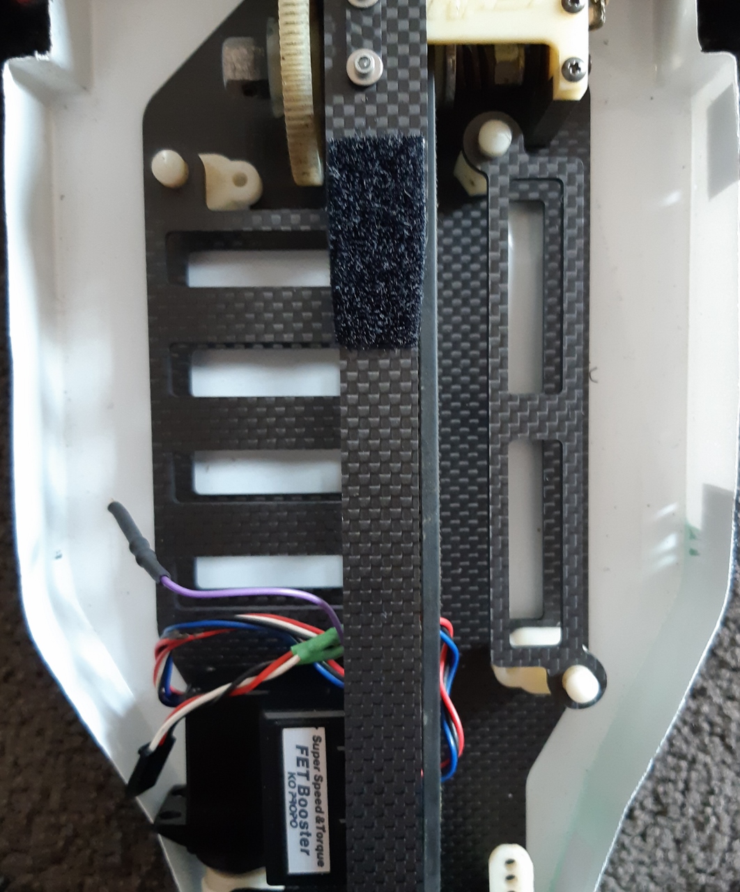

Hi,
Not sure if I'm in the right forum but can someone share the battery soldering configuration used in the 4 + 2 chassis?
More to the point how to connect the two on one side to the four on the other and join through a single battery plug?
Thanks

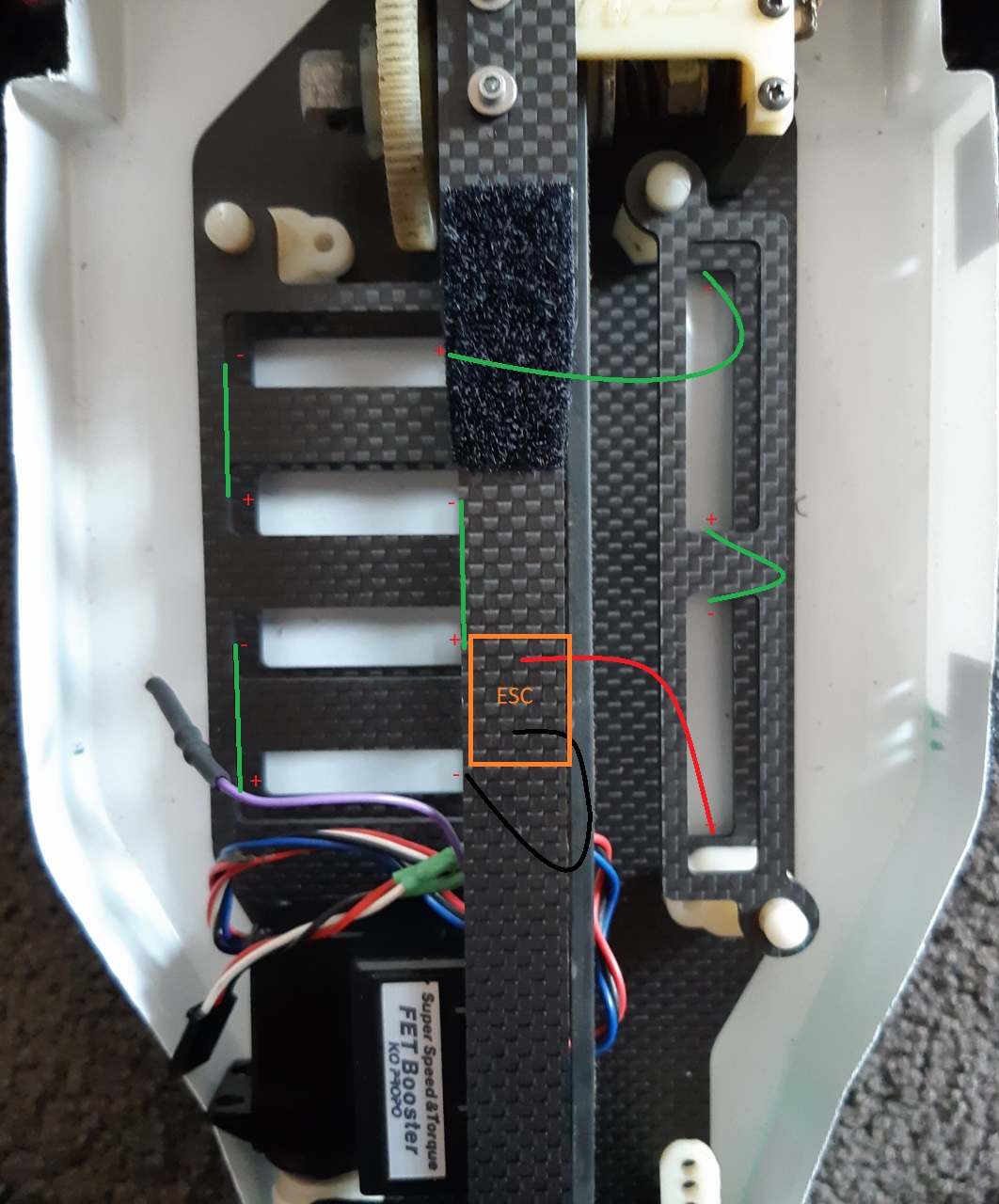

Build the 4 cells like a normal side by side pack. Use a jumper wire to go between the 4 cells and 2 cells (+ to -).

here's a crappy paint markup (there are plusses and minuses in there in red if you look close)

Wow, excellent, thanks for the help
