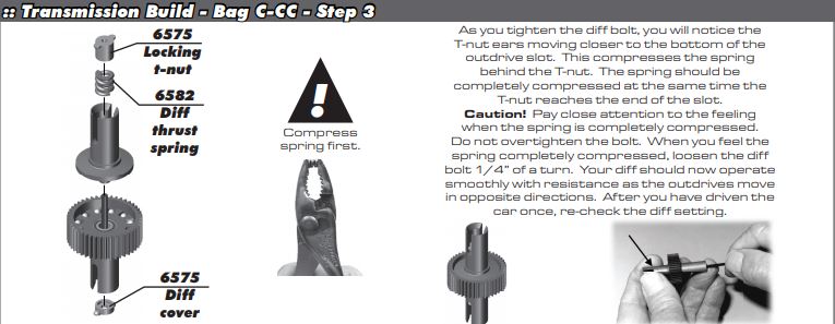

Hi Chaos
Guess I should first ask if you have had the trans apart... And if so...
I could be wrong but a stealth trans "skipping a tooth occasionally" would leave evidence of near catastrophic failure on the face of a gear.
And you said the worn 48 pitch gears were quiet enough.
I would think of either loosening the slipper or tightening the diff.
A diff that is not set properly can "bark".
Lots of references to diff setup here and on AE web site.
Chuck

My first problem was way to much loose on the slipper. Tightened that and it either started or continued to slip the diff. Tightened the diff and the the popping(that I assumed was a gear skip) began. Once opened, I did not seen any major gear damage, just what appears to be loose mesh and a lot of movement in the top shaft (which is all metal already). How quiet I claim it to be may needed to be taken with a grain of salt,, I haven't been around many other stealth transmissions to compare. The only other one was a 6 gear trans and I can't remember how it sounded or where it is now.radioactivity wrote: ↑Thu Dec 19, 2019 5:39 pm Hi Chaos

Re: Stealth gear-sets
Chaos
You may still want to check the diff
With the pinion off the motor (testing the trans only), rotate 1 wheel while holding the other wheel still.
This can give you a reasonable assesment of the diff's status. New rings and balls should be quite smooth. If taken apart, a fingernail dragged across the ring will tell the story.
Hope that shaft helps.

When I tightened it, I rotated it against itself and would not say that it is/was quite smooth. I would say that it was right in the middle of "butter-smooth" and "no way that will work". But, its also likely tighter than it needs to be. I intend to loosen the slipper enough that I can loosen the diff a little. I am probably going to have to replace the other two gears and will plan to replace the balls and ring if and when that happens.radioactivity wrote: ↑Fri Dec 20, 2019 10:38 am Chaos
