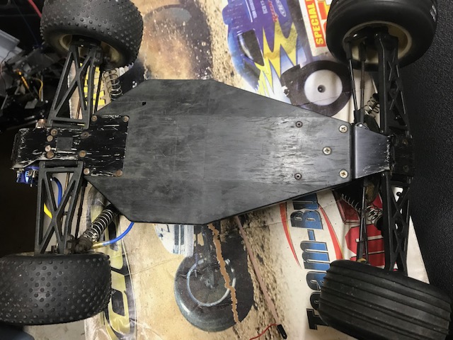

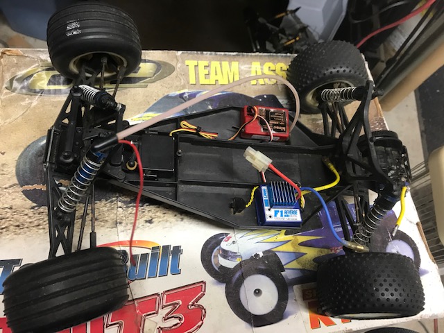

So I did a trade the other day for an Rc10t3 on Craigslist. I got the truck and it is in pretty good condition. I would like to build it to run on a track and would like to know how people have set it up. Right know its pretty stock. It has a Hi-tech Transmitter, Receiver and Servo. The motor is a Reedy Brand and it says ROAR27 on the endbell but the actual label is hard to read because its so worn out. The ESC says LRP on it but it smokes when you plug it in so I need a new one. Please let me know what you guys run. Tires, Shocks, Shock oil, ect....

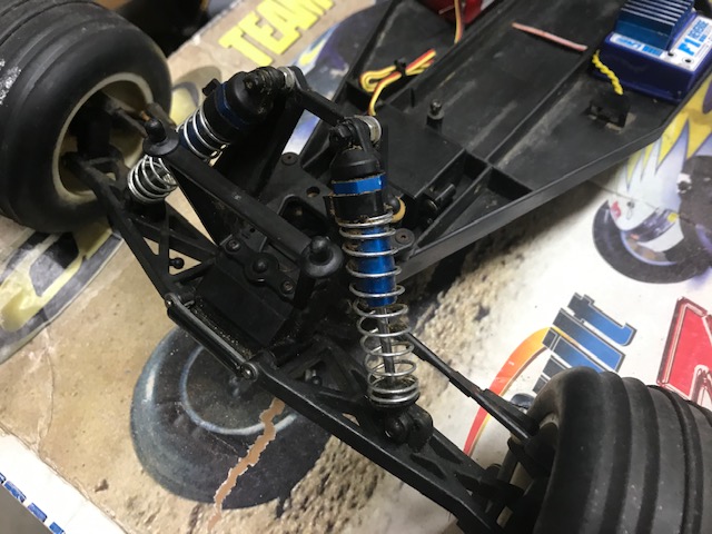

I would grab the manual from the team associated website and rebuild the shocks and verify the suspension setup matches the manual.

as for the esc and motor, if you are planning to run it on a track and keep it low maintenence, look for a reasonably priced sensored brushless system. I've got a few cheap trackstar 17.5 combos which are nice and smooth and run really cool. not the super fastest but you can get the motor and esc for under a hundred. lots of other options out there too.
