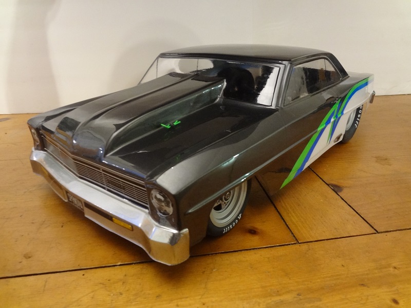

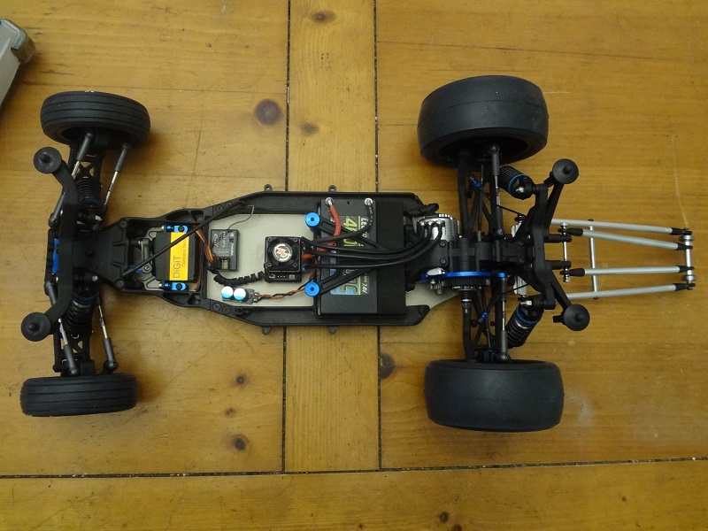

I'm hoping to spark up some interest in rc drag racing in southern Oregon. This is my first drag car build. It is based on the Team Associated B5M/SC5M platform. For those of you not familiar with this class of car, Its basically a 2wd buggy that is lengthened to have the wheelbase of a short couse truck. This one started out as a B5M and I changed out the chassis and chassis side rails for the SC5M one. After a little help from the dremel and exacto knife, I was able to mount the SC5M body mounts to the B5M shock towers. I fabricated my own wheelie bar and mounts and topped it off with the Jconcepts '66 Nova body. Rolling on Jcon Startec wheels and proline Hoosier drag tires. I plan on doing some test runs this weekend, weather permitting. I'm using a Hobbywing V3.1 esc and a Sky Rc 6.5t motor. As I get the car dialed in and launching straight, I will be ugrading to a 3.5t motor and a higher amp esc. Probably be changing out some plastic gears for some aluminum ones as needed. I got the 4 gear transmission with ball diff in it right now. The ball diff is cranked down. I'm curious to see how it holds. I might try drilling and pinning it, effectively making it a spool. I'll keep you posted of the progress as I start testing and making improvements on my car.

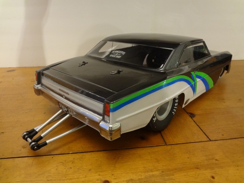

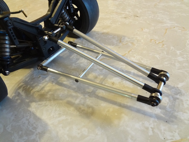

First thing I want to know is how you made the wheelie bar cause I love it and looks like its gonna work killer.

Thanks. Bigger cap packs is on the list. I run a 4 cap bank on my 17.5 spec buggy and it does make a difference.

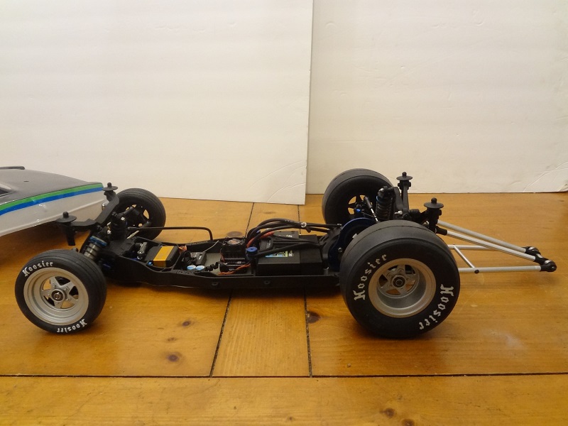

Shock setup right now is 1.6 pistons with 40wt in the front and 1.6 pistons with 50wt in the rear with internal travel limiters. I need to install comression limiters to keep the front from being able to touch the ground. I setup the front where, in a wheelie, the front tires still touch the ground. My thinking was to have control of the car in a wheelie launch.
The wheelie bar is a completely fabricated one-off. Larger main tubes are 1/4" x .049 wall aluminum tapped on the ends. I made some studs using all-thread to connect the tubing to the traxxas rod ends. The smaller cross tube is drilled and tapped as well to stiffen up the lateral support. The wheels are just bearings and the axle they ride on is aluminum tube with thin aluminum spacers to keep the bearings and rod ends spaced out where they belong. The upper mounting point is some nylon body mounts attached at the lower mounting hole for the wing brace on the shock tower. For the lower mounting point, I fabbed a piece of aluminum that attaches where the stock buggy rear bumper goes. It's aluminum angle welded to aluminum tube that has tapped ends.
It took me a few hours to build, but it cost me about $16 in materials plus a few pieces I had laying around. In a crash, if I bend a tube, I can replace it in a couple minutes with another $2 tube.
I'm going to make another one using carbon arrow shafts for the tube, which will make it really durable, but I thought the aluminum looked cool.

You definitely have the right idea on the front end and I was told the rule of thumb on wheelie bar height is 2 quarters stacked on top of each other which mine is not even close I’m about 1/4”- 1/2” off the pavement I need to correct this.

At static, my wheelie bar is around 1/2" off the ground. At full rear compression of the suspension, it is about 1/8" off the ground. The reason I chose to use the 4 gear transmission, is the rotation of the motor is supposed to push the rear down at launch. That's the theory anyway.
