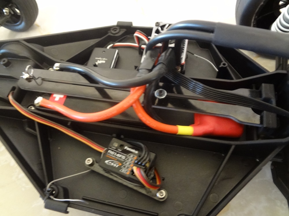

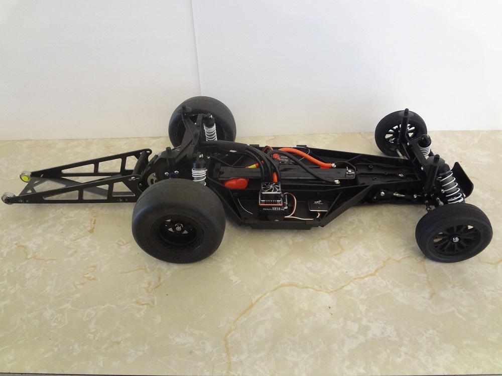

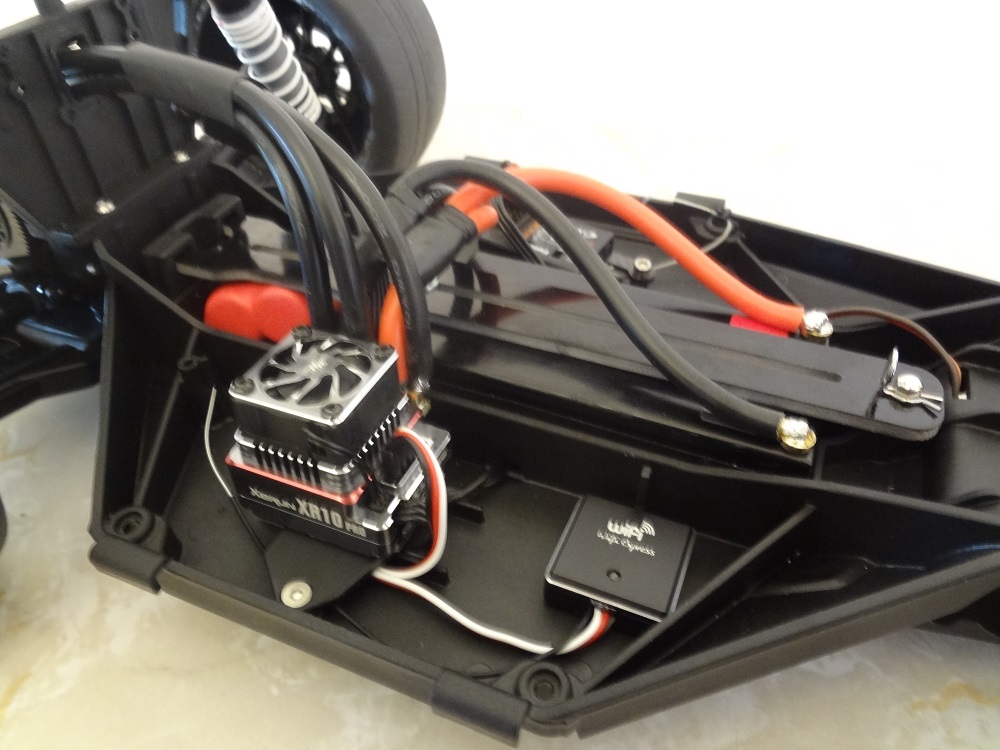

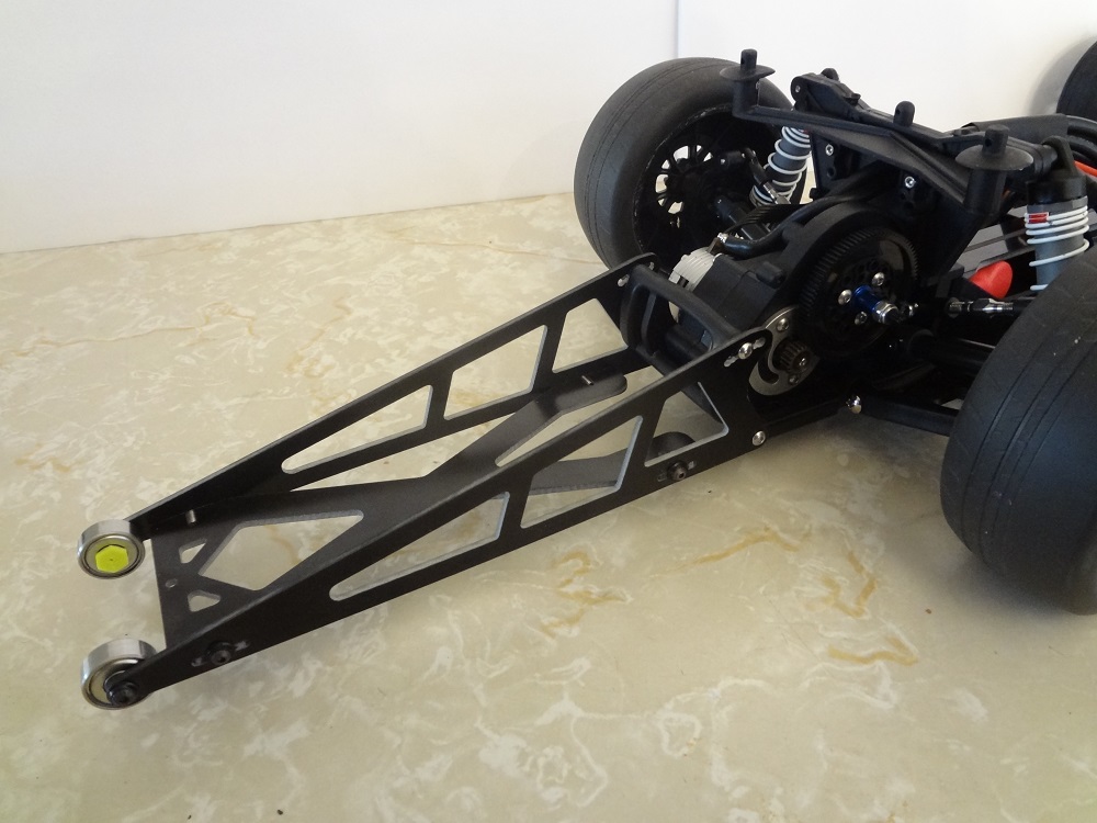

With No Prep rc drag racing growing rapidly here in southern Oregon, I decided to build my second attempt at a drag car build. I wanted sort of a "sleeper". Anyone looking to see what I'm running will, at first glance, see it's just another Traxxas Slash. I tried to add a few go-fast goodies to help motivate it down the track without looking like a $1500 carbon fiber custom. The transmission has all steel gears, sealed diff, and an Exotec slipper eliminator. Motor is currently a 6.5t to get the car dialed in, but will soon be getting a 4.5t. Esc is a Hobbywing XR10 Pro G2 Elite with a wifi programming module. All wiring is 10 gauge with a flashpack. Lundsford titanium turnbuckles, stainless hex head screws everywhere and Hot Racing steering rack are just a few other items that I upgraded to. Big thanks to Jeff at Factory Works (aka GoMachV) for getting the wheelie bar to me lightning fast and also designing this battery strap for me. Jeff's products are second to none and his customer service is fantastic. Body for this one will be another '66 Nova (my favorite, i can't help myself) that is in the paint booth as I type this. Hopefully it turns out good. I'll post more pics when it's done. I will be attending my first organized NPRC race this Sunday and I'm hoping to at least be competitive. 8)

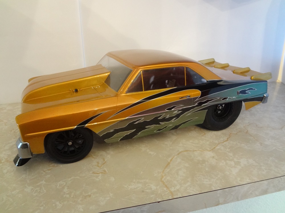

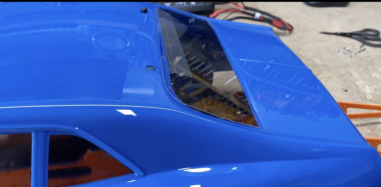

Here's a pic of the paint job. Not my best work, but it will do. I've been trying my hand with liquid masking, but there is a learning curve. I loved the Rc10 gold pan paint color so much on my recent buggy build, that I decided to try it on the Nova body.

Wow that looks great

First actual organized NPRC race today. The car ran straight and consistent all day with no mishaps. I definitely saw the limits of a cheapo 6.5t motor in a 4 lb., 13 oz. car. After a gear change and playing with the timing, 2.7 seconds @ 51mph was all she was going to do. Launched well, didn't ride the wheelie bar and was rock solid stable on the top end. A new 4.5t motor will be installed before the next race, which should turn up the horsepower quite a bit. As it was, I went undefeated in the first round of eliminations and moved into the list racing. Ended the day undefeated in the #8 position on the top ten list. Most fun I've had with rc racing in a long time.

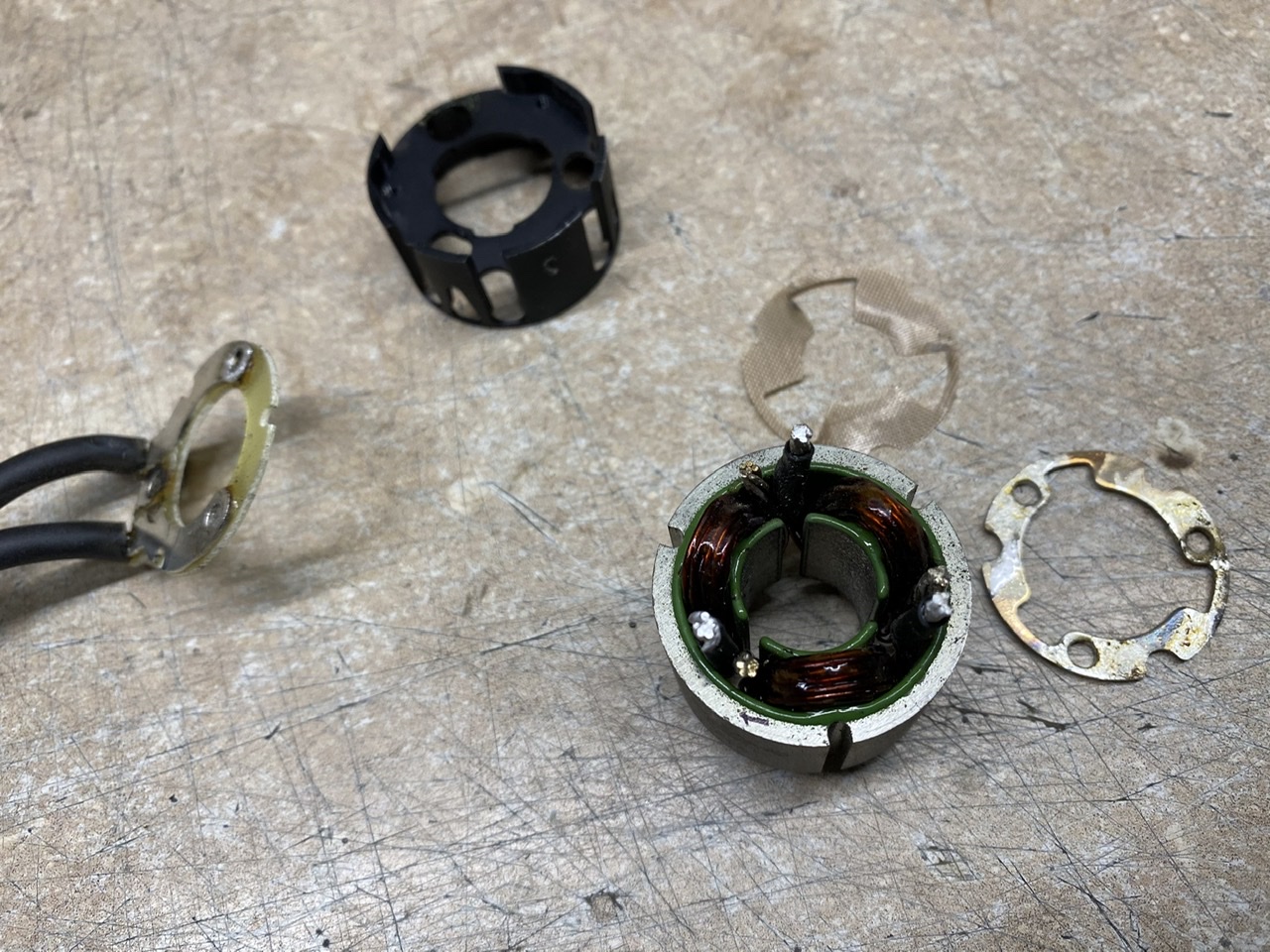

That’s awesome. We went down to Salem Friday night for a cash days, our team took home the win which was nice plus Casey at NW Hobbies threw in $100 to the winner. My car didn’t make it out of the first round this time. We lunched the Maclan 5t right before the race started while we were testing and had to swap to a 4t revtech which had a lot more power, but we didn’t have time to do any tuning. Ugh. This is the second Maclan I have had to resolder. Kinda done with em.

Wow. That thing really came apart on you. I'm looking at a couple different motors right now. Trinity and fantom are at the top of my list right now. Still need to do a little research on it. I wish reedy made a 4.5t.
