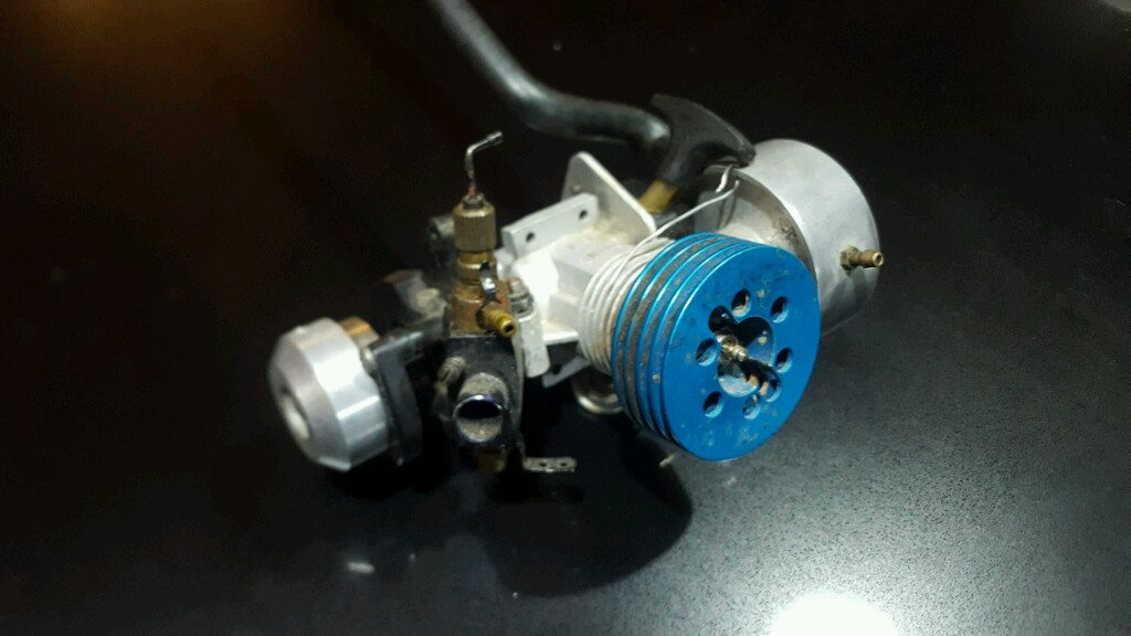

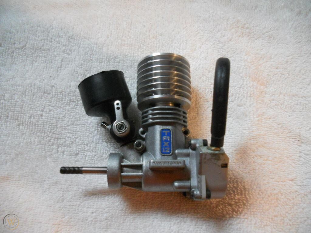

Alex kindly loaned me two of these to look at. I've always found them somewhat interesting as the set up is unusual and reminds me of early converted plane engines. The other engine he sent has a taller head with more fins and a slightly different muffler can.
He likes the other engine but I like this one, so we'll tear it apart and see what we can do with it :lol:
From a quick initial inspection;
The good - it turns over
The bad - it likely needs a new piston/sleeve
On a slightly different note I don’t know if this is an early prototype truck or not but I'd love to replicate this.... which is hard for me to say as it's not an AE.

I always liked the way these Schumacher cars looked with the engines payed down like that

RC10th wrote: Wed Dec 16, 2020 7:15 am Alex kindly loaned me two of these to look at. I've always found them somewhat interesting as the set up is unusual and reminds me of early converted plane engines. The other engine he sent has a taller head with more fins and a slightly different muffler can.

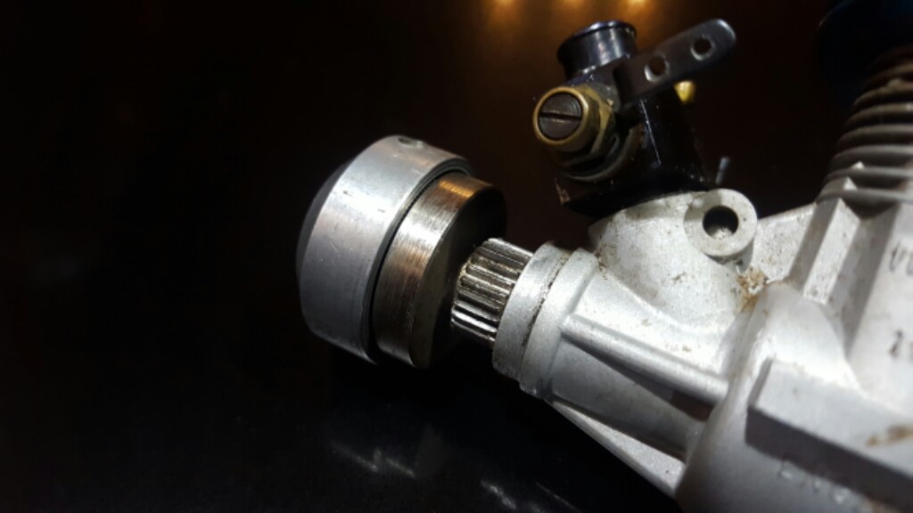

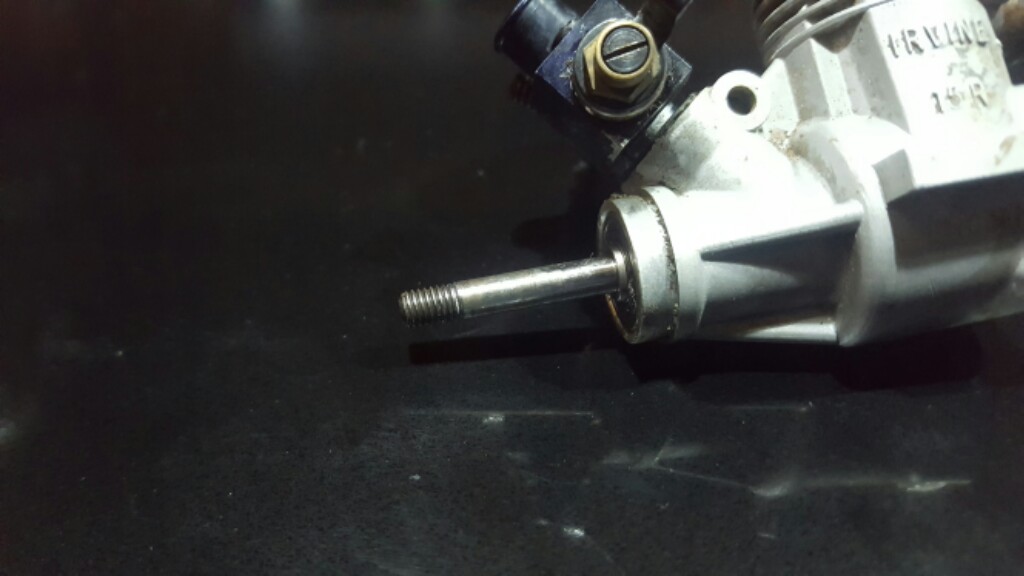

The clutch and flywheel set up is a bit backwards and strange :lol: but it looks like it works well. I wonder if bent cranks were ever a problem with these.
Which leads to another oddity, the crank itself. It doesn't appear like it could be used in anything else

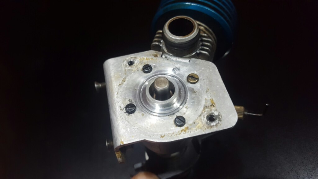

Looks like someone has been in here before......
I guess the whole parts/mix/match thing depends on your intended goal.... Do you want it to be a good running engine or just a nice display piece in one of your cars? I can't imagine heads getting too damaged on these since they are pretty well protected, so I assume most will appear to be in good shape.

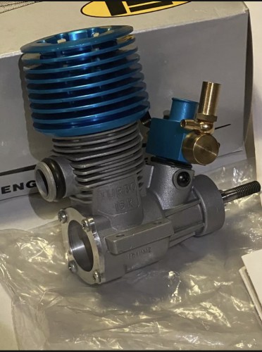

Lots of differences to the 15R I just stuck in one of my cars.

Traxxas used those long cranks back in the nitro hawk days.

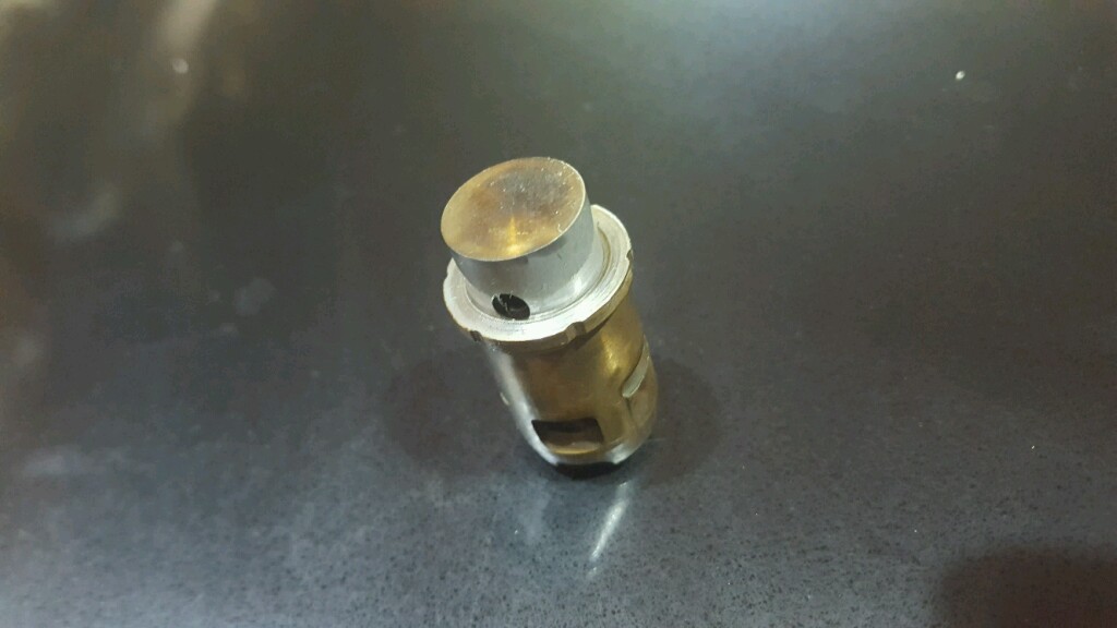

I was right about the piston/liner, this shouldn't happen :lol: :lol:

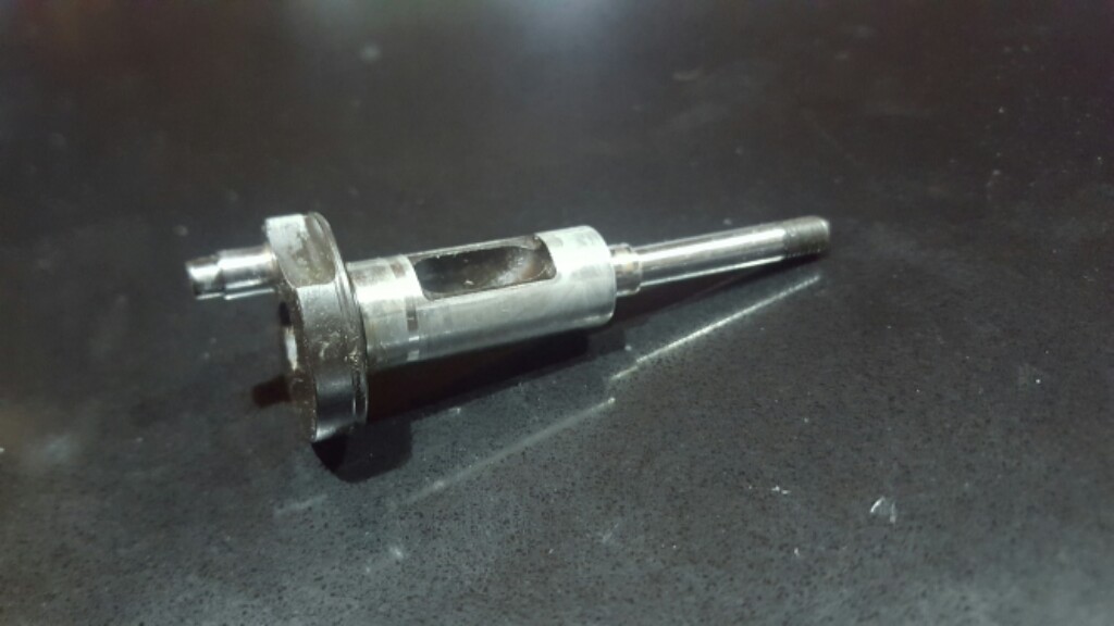

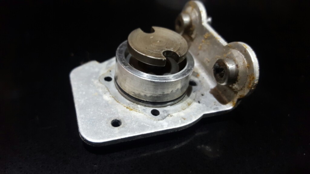

The sleeve above looks to be quite well made, the exhaust port is chamfered and the intake port also has some work done to it too.
Here's the crank for you curious types, it also appears to be well made.
Interesting how the backplate is the engine mount and basically just an aluminum part pressed into a steel plate.
The bearings are quite notchy and the con rod is a little sloppy on the crank pin.

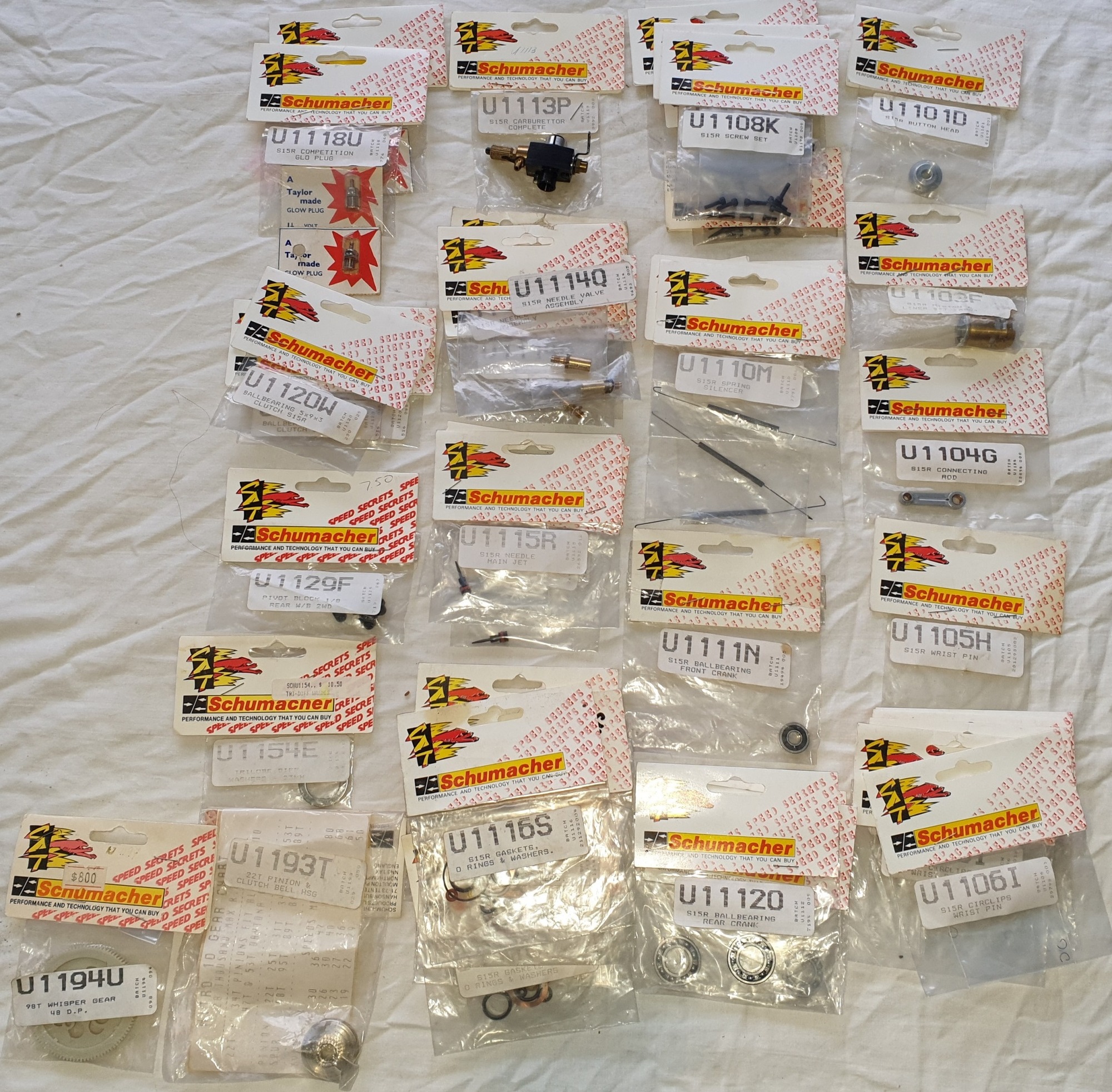

Posts: 3652
Has thanked: 1695 times
Been thanked: 1125 times
Re: Irvine .15
klavy69 wrote: Sat Dec 19, 2020 11:30 am better question is why doesn't it have a nice box around it with my address on it...
I thought you'd appreciate it more if I put it in a plastic bag and buried it out back.... *sigh*.... so many memories... :lol: :lol: :lol: :shock:
RC10th wrote: Sat Dec 19, 2020 5:01 am The bearings are quite notchy and the con rod is a little sloppy on the crank pin.
That's what she.... no, already done that once this year. Besides, you don't want a sloppy conrod when you're pinning your crank....
Sure we could find some spares here...
I found another engine too.... had one hiding out in the box with the rest of the Nitro 4x4 parts :P :oops:
RC10th
Posts: 4705
Has thanked: 50 times
Been thanked: 1495 times
Re: Irvine .15
Post by RC10th »
Some good stuff there although you've included non engine parts... :lol:
I hope the conrod in your picture isn’t the correct one for the early .15R. I thought the conrod in the engine I pulled apart looked very much like an OS :shock: :roll:
We are pioneering the irvine .15 information database here :lol:
