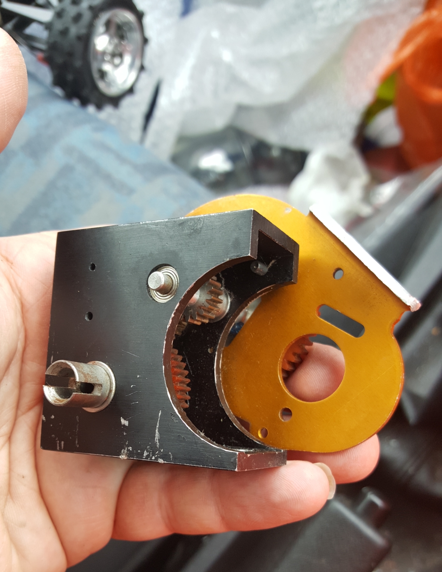

I have seen this mag clipping posted up in the 'Rarest Part' thread on here, and am now trying to find out the date of this article. Does anybody happen to have the mag with this in, or any other information on the Nodis RC10 gearbox please?

I believe I posted that after seeing it in one of the magazines the_perfect_pickle_sales had listed on eBay a while back. It's from the Aug. '86 ish of RC Model Cars.
Also, OverRC.com has a scan of the prototype 4wd Nodis was working on: https://www.overrc.com/vintage/documentation/archives-de-mike/Nodis%20RC10%204wd%20from%20June%20'87%20issue%20of%20Model%20Cars.jpg

Thanks for that info mate. I spoke to Richard Isherwood about that 4wd car and he told me that Nodis never completed it, which is a shame. I have a gearbox at the moment which is why I am trying to date it.

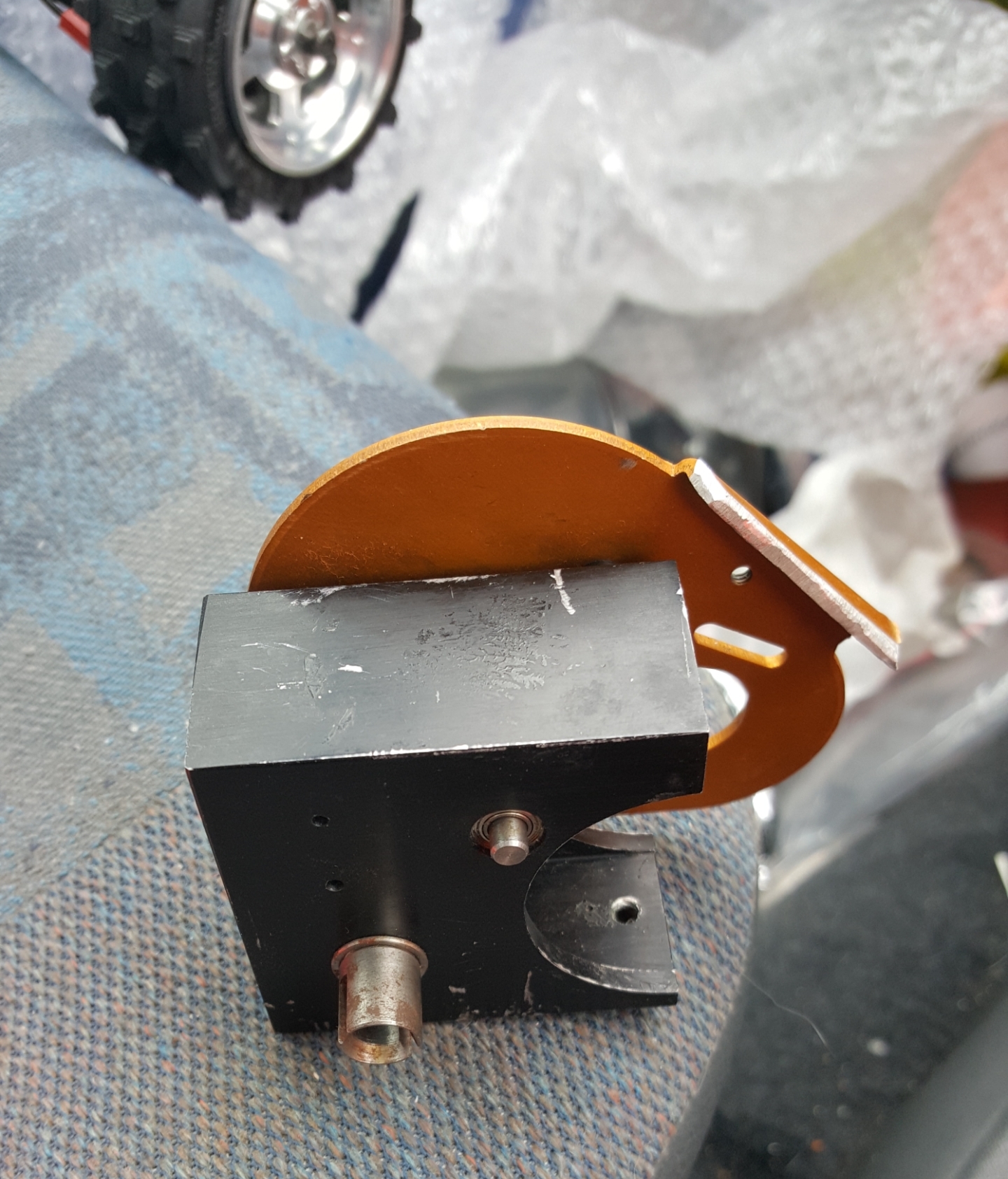

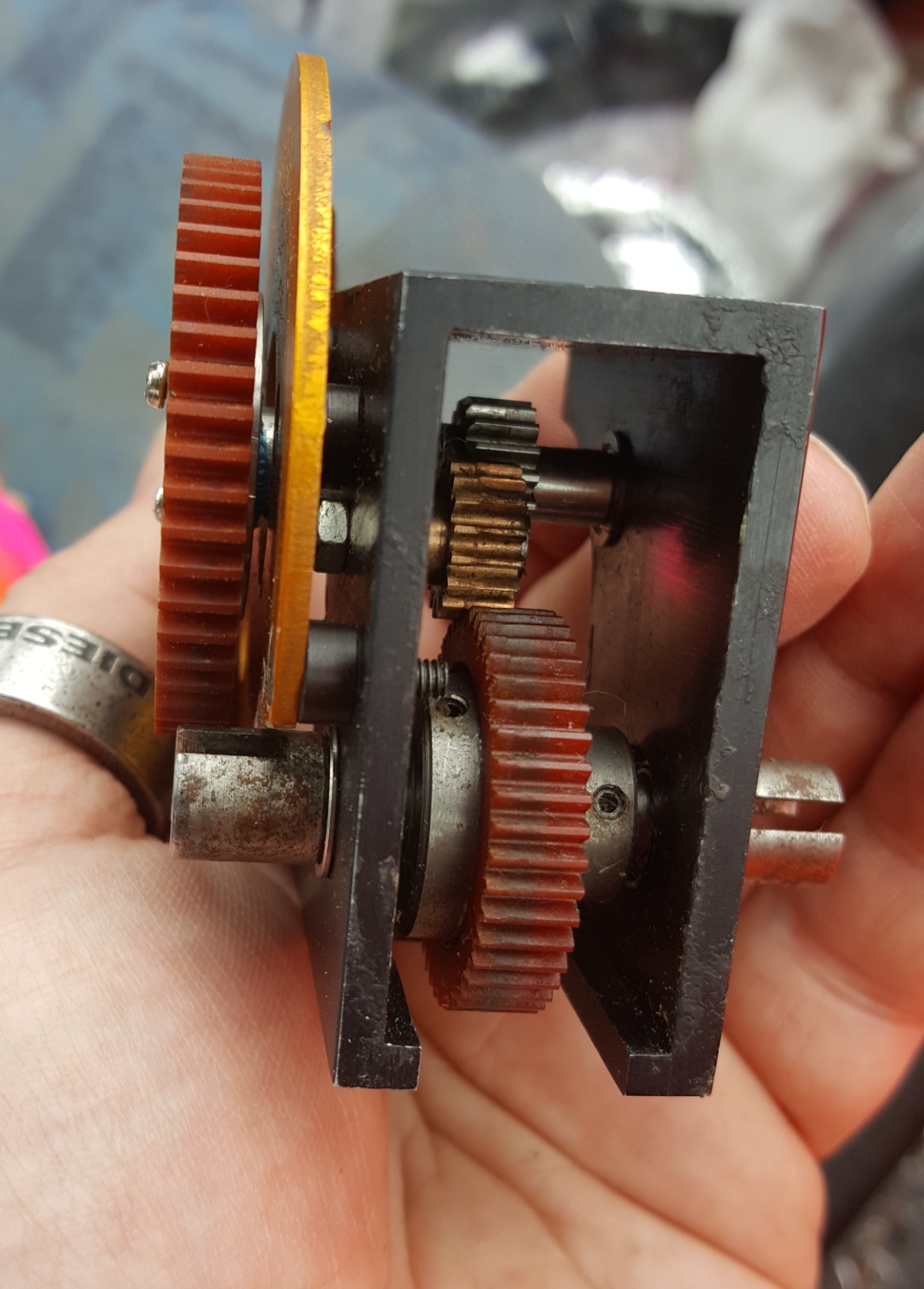

I'm curious; why doesn't the idler gear shaft pass through both sides of the case?

It looks to be just a pinion gear on a stubby shaft on the one side. Easy to replace, i guess. Reminds me a lot of the Brimod car set up.

So I was rereading the ad and this line clicked for the first time:
The top gear is hardened and a small bearing block is fitted to the box which carries a contrate gear coupled to a shaft which in turn connected to a differential.
That sounds like, instead of a simple idler gear, there should be a shaft drive between the top gear and diff. :shock: Weird thing to do for a 2wd trans but it could be a real slick way to run a shaft to a front gear box for a 4wd conversion. Maybe that was an earlier prototype before Nodis switched to the belt drive shown in the OverRC article. A crown gear as an idler could explain why the belt driven spur is on the right side of the case on the 4wd car....it'd need to be on the left side for a typical 3 gear trans. Though my guess is Nodis dropped the idler completely and the 4wd car has only 2 gears in that trans.
