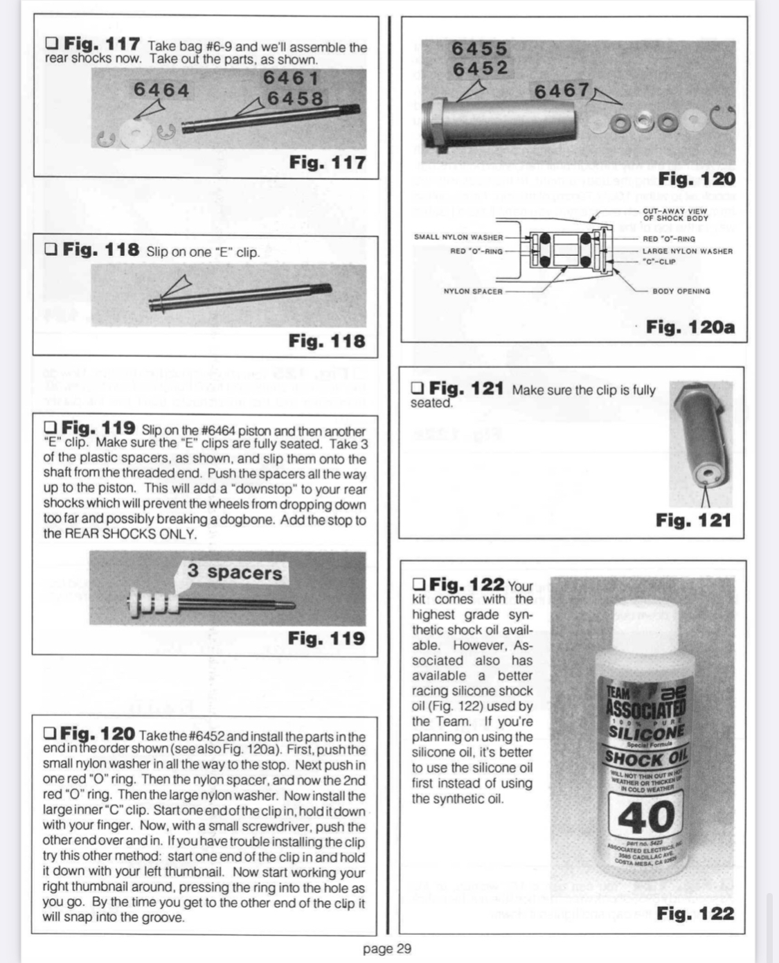

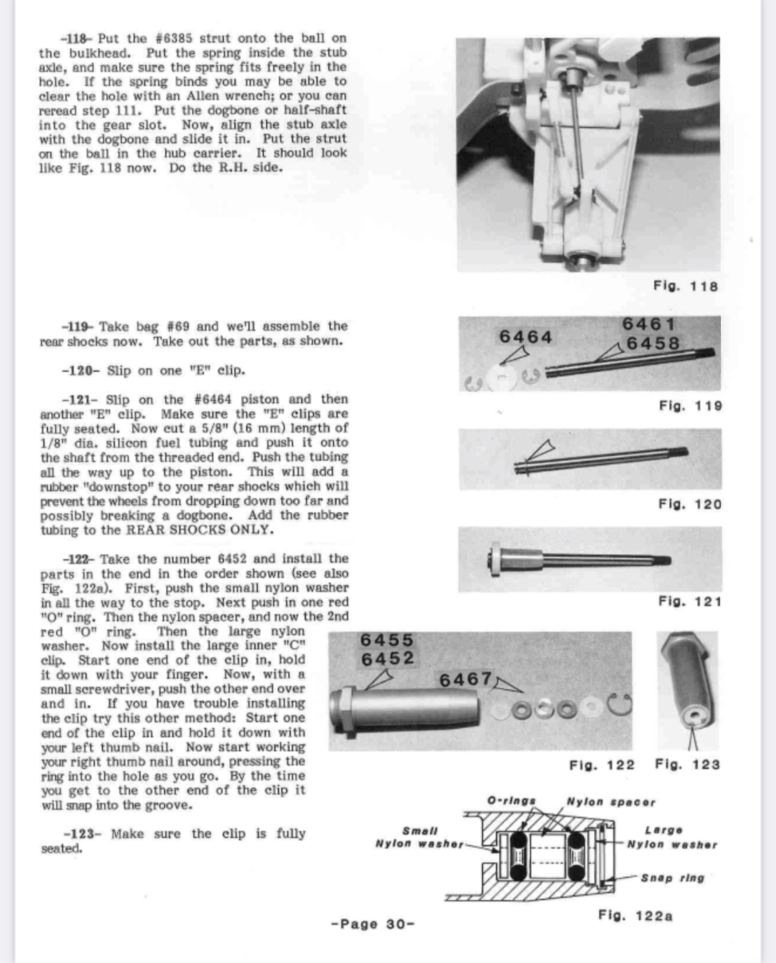

The rerelease manual tells you the improper amount of spacers to use for the rear shocks- and the ones they included were much thinner than the proper 6466 spacers spec’d. This was a issue I don’t think they ever resolved in print. Using the old manual will show you the three needed per side, or just add 5/8” of silicone tubing as per the original manual

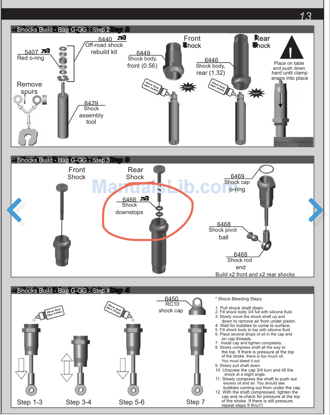

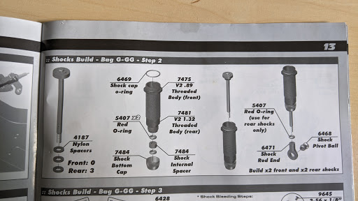

Ok, yeah, there are three VERY small spacers in the manual I have. I just pulled a shock and disassembled. I had three small ones and there are three more I can give. Each are about 1mm? So, I guess I'll try adding those other six. Here's what they sent in my version for future reference.
