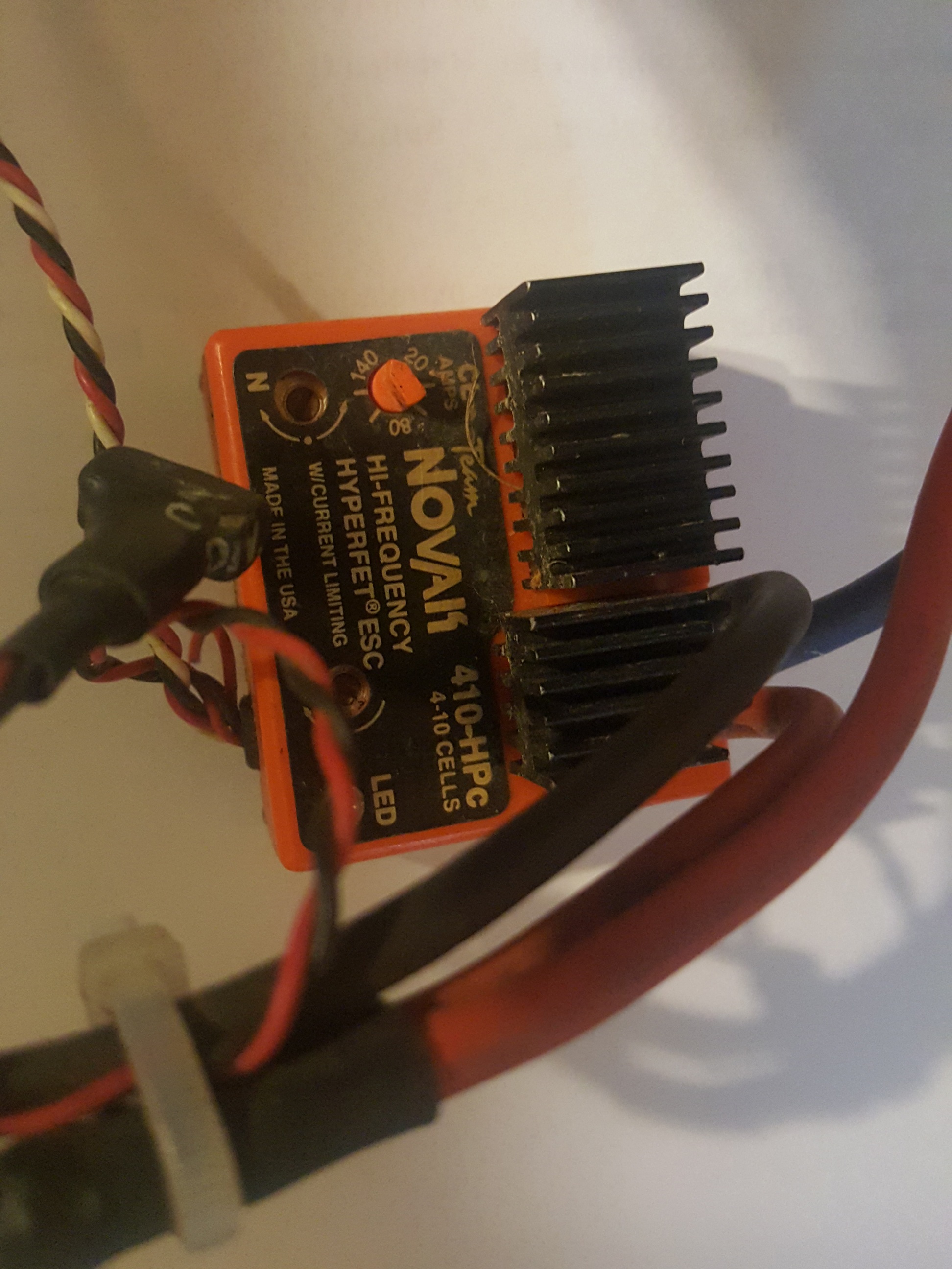

My Novak has an adjustabled amp dial on it and no reverse. I would still like a brushed esc as I have several motors and nicad batteries. I would like an esc with reverse but I read somewhere here that reverse might blow a dioded or diodes on the motor. True? If true how do I work around that? This is all old stuff I am dusting off so that is why staying with older tech for now. There is no place to race anywhere near me so its backyard stuff and letting my dog chase it :D . I have plenty of old hand out motors from years ago so I guess I can just use the diodes from them unless the newer brushed motors don't use them any longer.

I've been using 2s lipo batteries with several old Novak esc's for the last two years without issue. Two of my cars are equipped with 410-M5's,one with a Cyclone ,another with a T1X and two others that are running Explorer Sports.
As long as the connectors are wired correctly, l don't think the battery should be a problem.

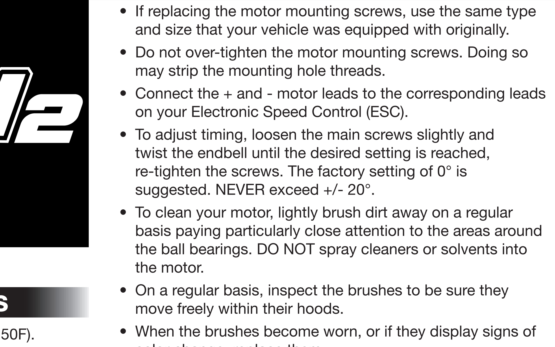

You can try increasing the timing. But I still wouldn't expect it to be on par with a hand wound race motor.
But in general, currently available brushed motors aren't near the quality of those from the 90's and early 2000's. With the exception of crawlers, there just isn't a market for high end brushed motors.
Posts: 3535
Has thanked: 268 times
Been thanked: 2094 times
Re: ESC and motor questions
I just checked, they come preset at 0°.
For good brush life and limited wear, I typically run my motors conservatively at 6-8°.
For max power in a buggy, I'd run 15-20°. In a truck, probably no more than 15°. But depending on the application and motor selected, those numbers could go either way.
