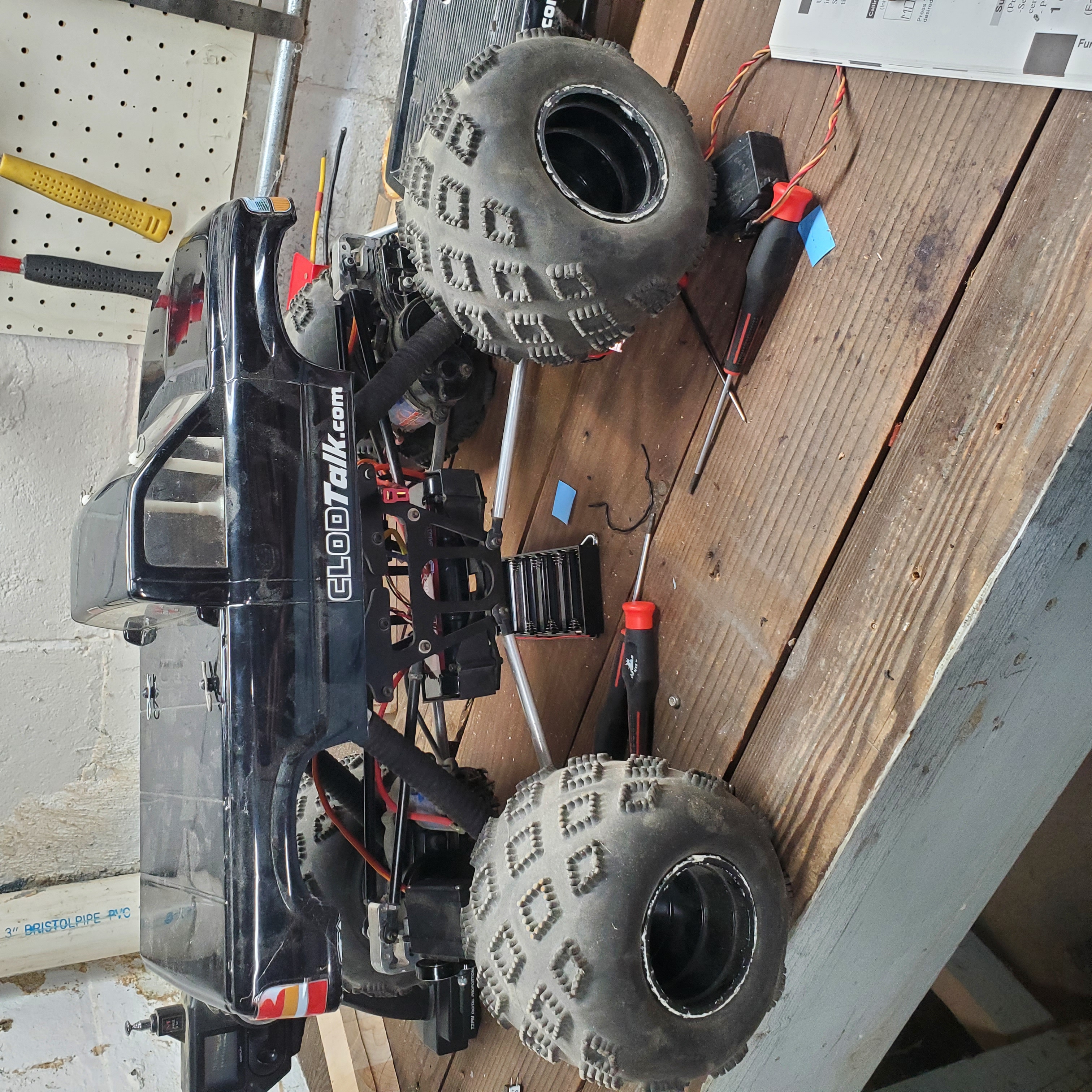

First test run of the clod and wrecked it good. Need a new axle tube among other stuff. Haha. Not much has changed in how I drive! Haha

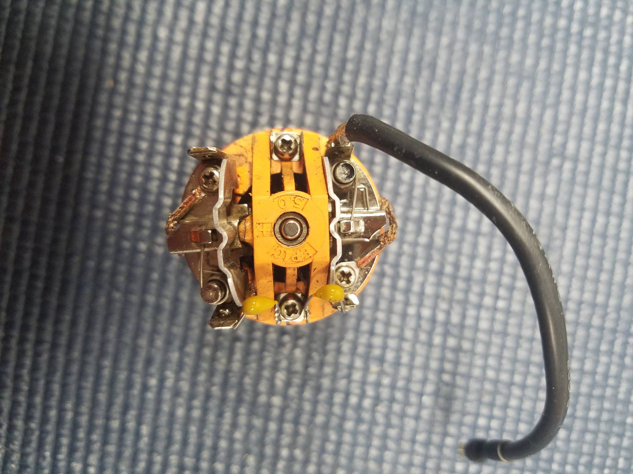

Just be careful/mindful with todays high capacity and high discharge rate batteries, especially Lipos. You can very easily, unintentionally put your brushed motor(s) thru a nuclear meltdown. As my brother and I did to a helpless Speed Gems Topaz motor over the weekend.

As above the modern lipo's last way longer so heat builds more in the motors plus they maintain their voltage much better under load so it's very like an 8.4v nicad that lasts for 30+ minutes driving = roasted brushed motor
If you go for brushless in a runner you can often have 40+ min drive times , more time to break the truck instead

Stuff happens when you get carried away putting a whoopin' on your brother's brushless truck with your 4200mah Lipo powered, 30 yr old school 40k rpm brushed motor setup.... oops
This motor was freshly rebuilt with brand new 11x3 armature, bearings, brushes and springs. Freaking thing ripped though for a good 15-20 minutes...

Is the armature ok? If you only need an endbell, that motor might be recoverable.

Yes sir, it's salvageable except for the endbell and one brush that had a significant piece of real estate removed during the meltdown process. Comm on the brand new armature is a bit on the blueish side now-a-days, but I'll indeed buff that out with the comm lathe and see how goes.Frankentruck wrote: ↑Tue Apr 12, 2022 1:42 pm That'll buff out.
I was/am gonna start a thread with my bro's brushed RC10T4 (which I build, setup & modify) vs my brushless T4.3, which will be updated during the various different brushed and brushless setups in each along the way. Coming soon.

At least that endbell has removable brush hoods. They can be salvaged as well.R6cowboy wrote: ↑Tue Apr 12, 2022 3:02 pm
That is one of my favorite things about Epic based motors, the removable hoods. Most of my Yokos and early Trinitys have sweaged spring posts.
